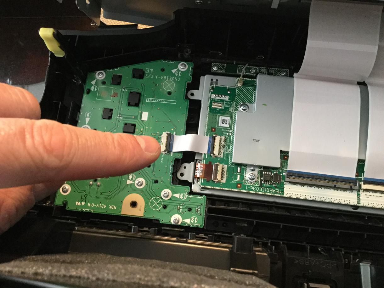

I have my radio apart right now, anyone know how to unclimbed the screen from the flat cable things??

Cracked the screen on my 2016 4Runner with GPS and satellite radio. Dealer replacement was over $5k and dealer said buy an aftermarket radio (over $1k). Ordered up the screen and digitizer described here for $45 from AliExpress. Took 3 weeks to get, but perfect fit. Radio is like new.
Thanks for the tip. Drop me a line if you have questions.
This saved my butt. Ordered the LCD touchscreen with digitizer from alibaba. $90 with shipping. Took about an hour to remove entune stereo (with nav), replace the LCD and digitizer and renistall. Not hard at all. Just take your time and be gentle with the ZIF (zero insertion force) connectors. Use your fingernail to flip the tiny locks up. An hour’s work and 90 bucks. Better than the thousands dealership wanted to replace entire unit.
