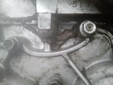

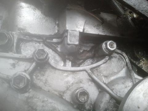

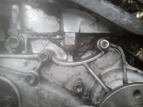

So I was trying to track down an oil leak and found this:
Not happy. Time for a new timing chain cover.
Somebody overtorqued the secret bolt.
engnbldr has covers for $50, but if you wanted to save a little money I bet you could pull that cover and clean the silicone off and plug that crack with JBWeld.
I figured they tried to take it off without removing said secret bolt. No matter. New cover kit with steel rails is on its way.
