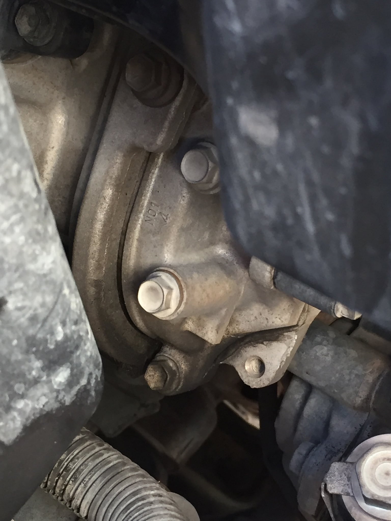

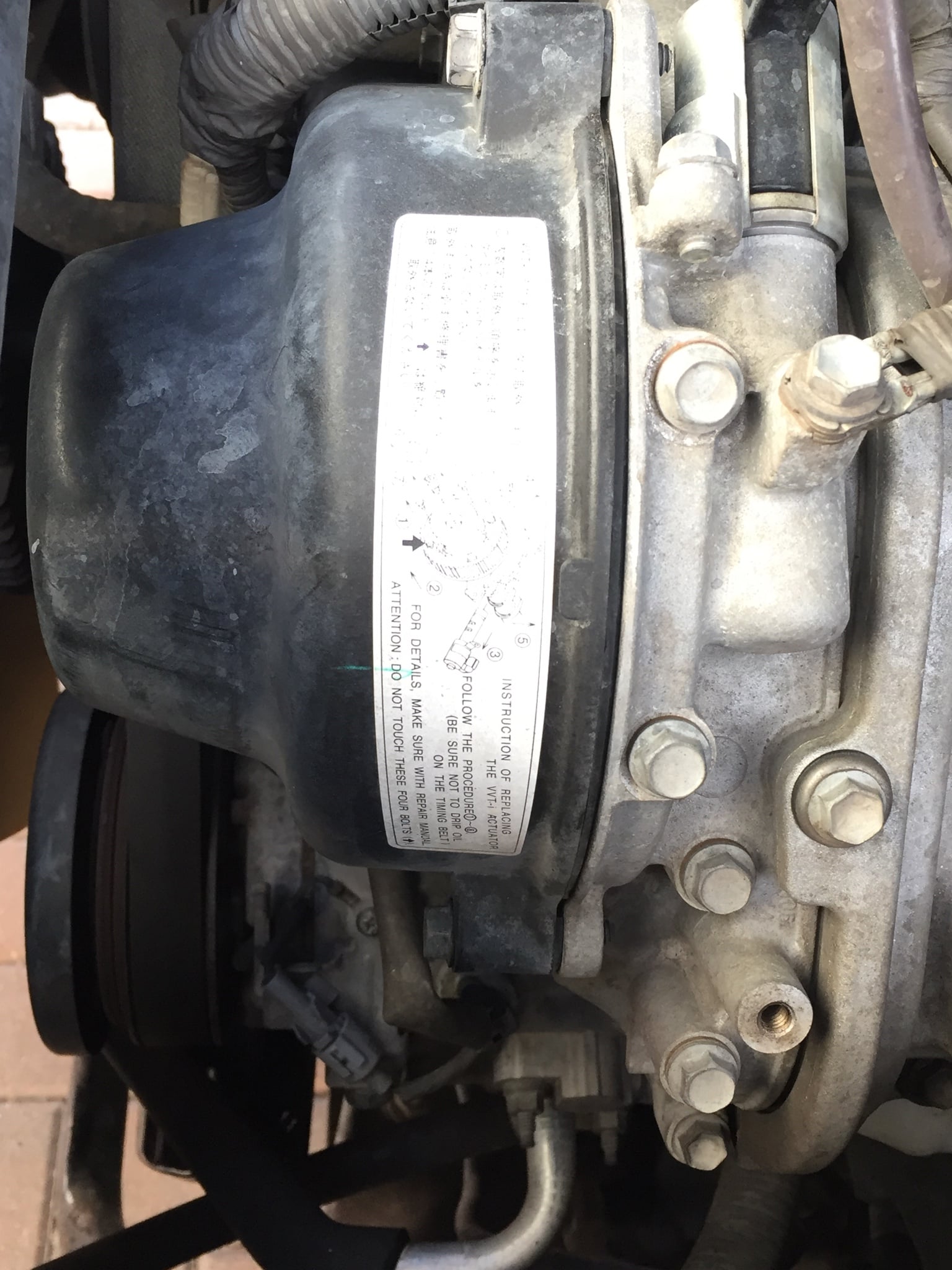

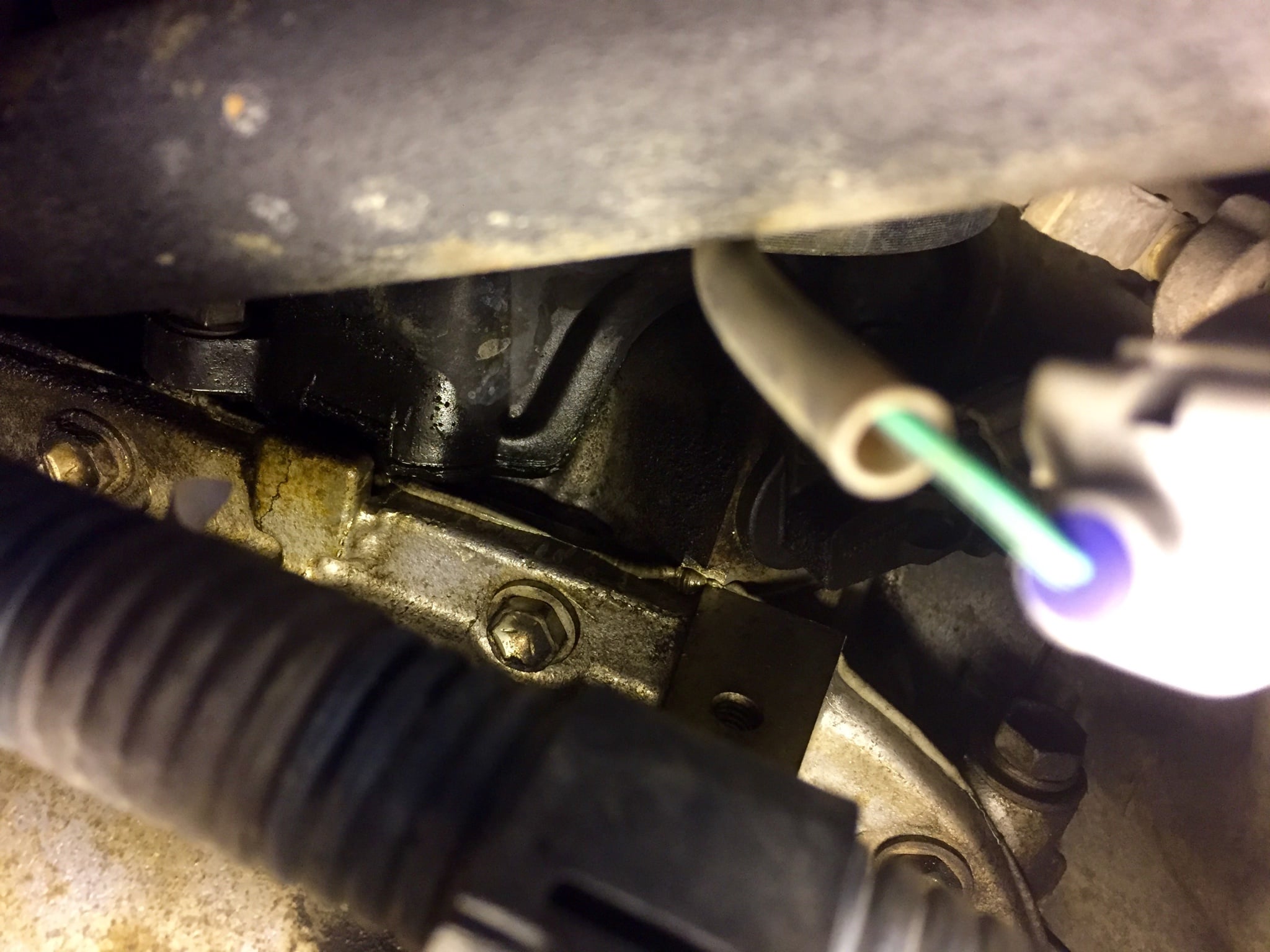

First I apologize if this has been addressed previously on the board. I've searched high and low on the forum as well as through google and haven't had any luck.

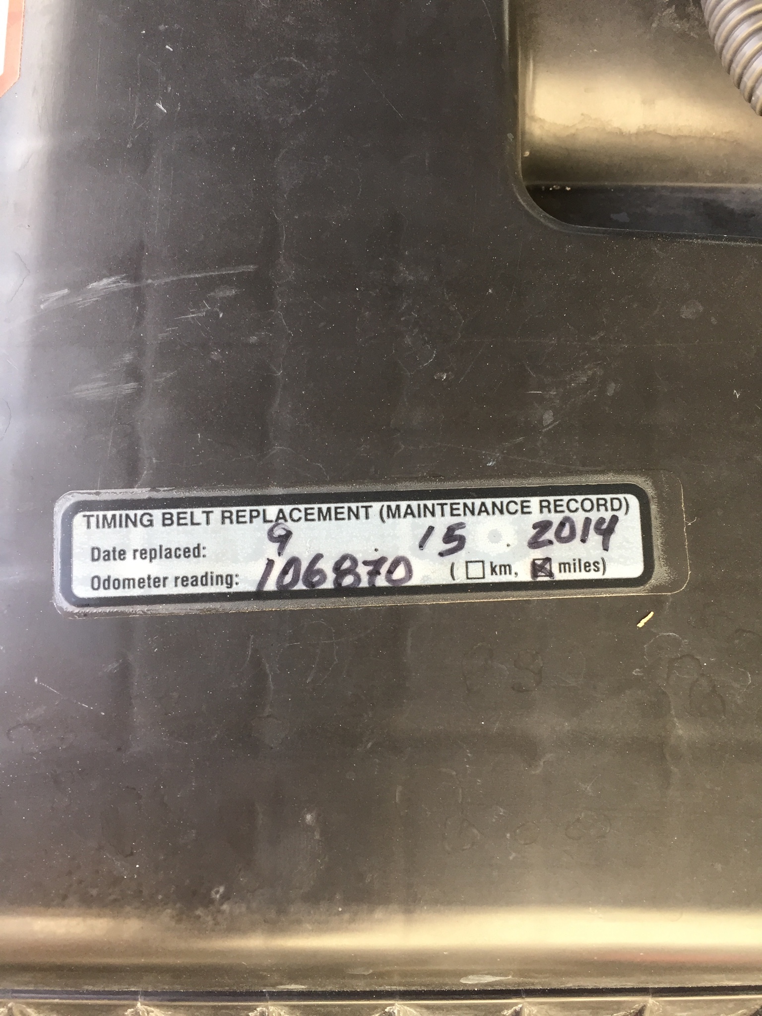

Here is the situation. I have a 2006 V8 Sport 4x4 with 133k miles. I maintain all the fluids as meticulously as I can. I did, at 100k miles, get the timing belt changed by a Toyota dealership, which was about two years ago. Up until now it has been completely leak free and problem free [knock on wood].
Now, it is leaking oil from what I think is the crank shaft seal (front main seal?). I am not positive but that is one of the reasons for the new post. Assuming it is, what are my options? If it isn't, what could it be?
I have only run Mobil synthetic. If it is the seal, is it worth taking to the dealership to change? Should I switch to high mileage synthetic? I really hate to 'live with' a leak like this when it is so young in its life. I plan on knocking at least 250k out of this sucker.
Thank you in advanced and hopefully the pictures load so you can get a better idea of what I'm talking about. I should also note these were taken right after I had cleaned the area to get a better view of where the leak might be coming from.

I have seen crank seals fail on the V6's occasionally, not so much on the V8's. But that's not to say it isn't possible. Only bummer is that to replace the oil seal you have to redo the timing belt (which if it's soaked in oil it's contaminated and probably needs to be replaced anyways.)
I'd see if you can have someone diagnose it better in person than over the internet as that should give you a better idea of what direction to go.

It may not be the crankshaft seal, but rather the cam shaft seals; I have seen those leak on the VVTi V8's (I just saw yours is an '06). See if the oil is coming from where the valve cover, cylinder head, and timing cover meet. Unfortunately it's the same issue in regards to needing to redo the timing belt, also because of the weird way Toyota did the camshafts on these VVTi engines you have to pop them off and partially tear them down to replace the seals.

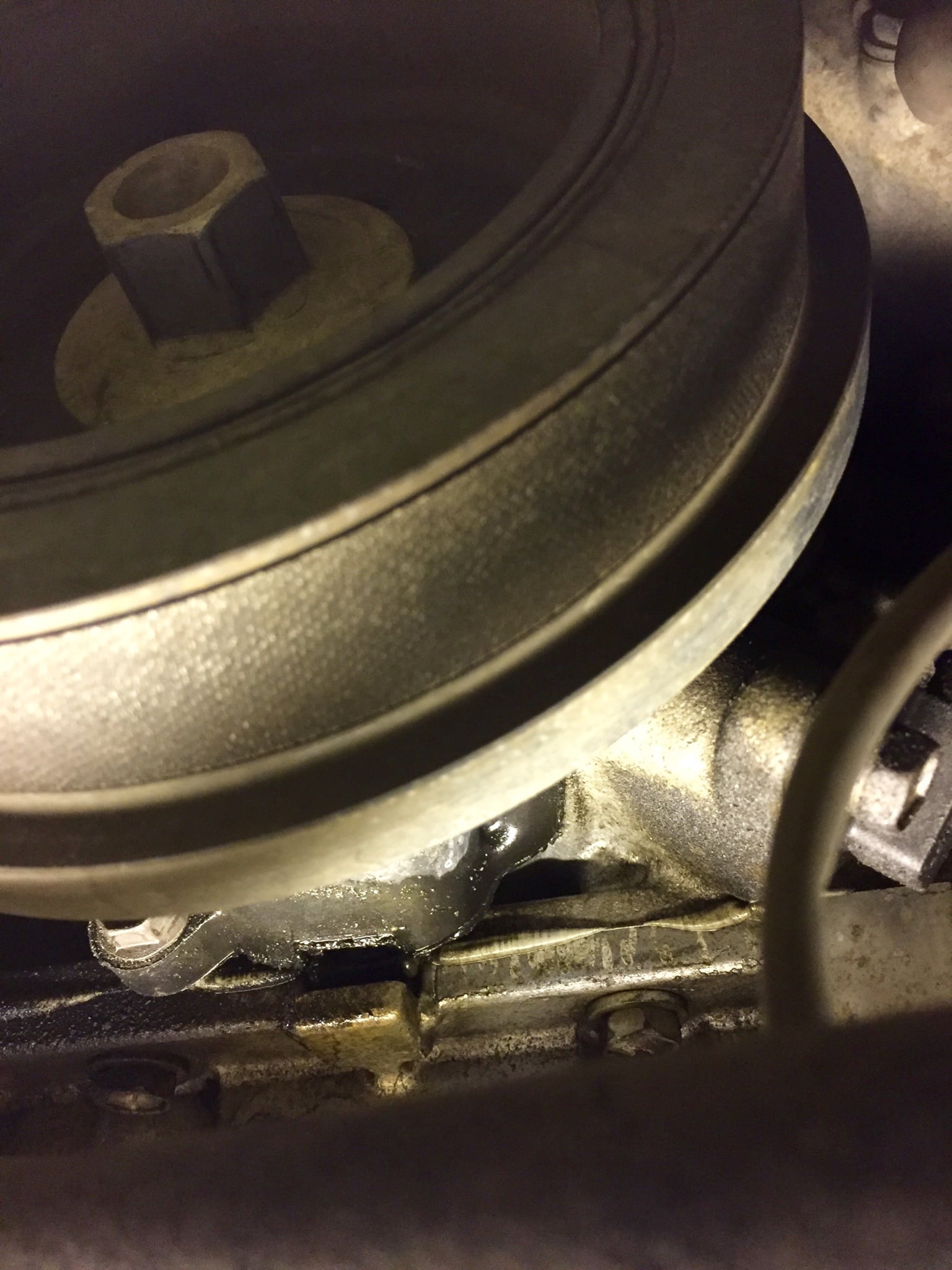

Update...
I checked the receipt and all cam seals and the crank seal were replaced. As well as the normal stuff like the water pump all drive belts etc.
Here are a few shots of the cam area
Rather than spending another $1200 to get the front end rebuilt, it seems logical to try high mileage syn or Dino. Is my logic flawed?
Whether or not they actually did the seals is something else. No way for you to check unless you do a mild tear down. I vote for Dino.
