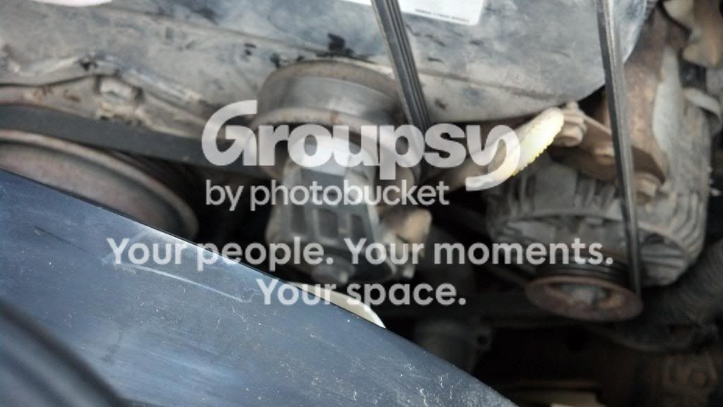

I've ordered a replacement crank position sensor which should be here tomorrow. I'm a little hesitant jumping into replacing it however as I'm not mechanically amazing. The truck is supercharged and the s/c tensioner pulley is blocking the cam cover from being removed easily. I've included a pic from a member here who posted the same issue about difficulty removing the cam cover but didn't get a response.
dynamictensioner1_zps2949af63.jpg~original

By the way, the dynamic tensioner is very simple to remove. It's one 17mm bolt and it's off, then I think a H10 allen head socket to get the bracket out. To take the belt off, take out the oil dipstick and tube, fit a 3/8" drive breaker bar into the square slot (no socket, just the 3/8" drive") and rotate it counter clockwise and the belt will slip right off. I can't even count how many times I've had to do it over the years, takes all of 5 minutes to do with the right tools. Then you can unbolt and pull back the cover a bit to see if your camshaft sensor (on the camshaft gear, passenger's side of engine) has oil or other residue on it making it not read correctly. Note that the connector for the sensor is on the outside of the timing belt cover.
