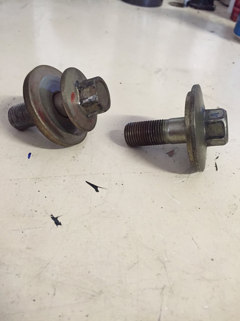

Also, torque spec is different for 2 different types of crank bolts.
One with washer as part of the head is 187 I believe, 217 for two-piece bolt. Funny because mine loosened up after 8 years and I ordered a brand new bolt from Toyota and they sold me the older style. Not sure why it's like that. I did mine to 200 with blue lock tite.

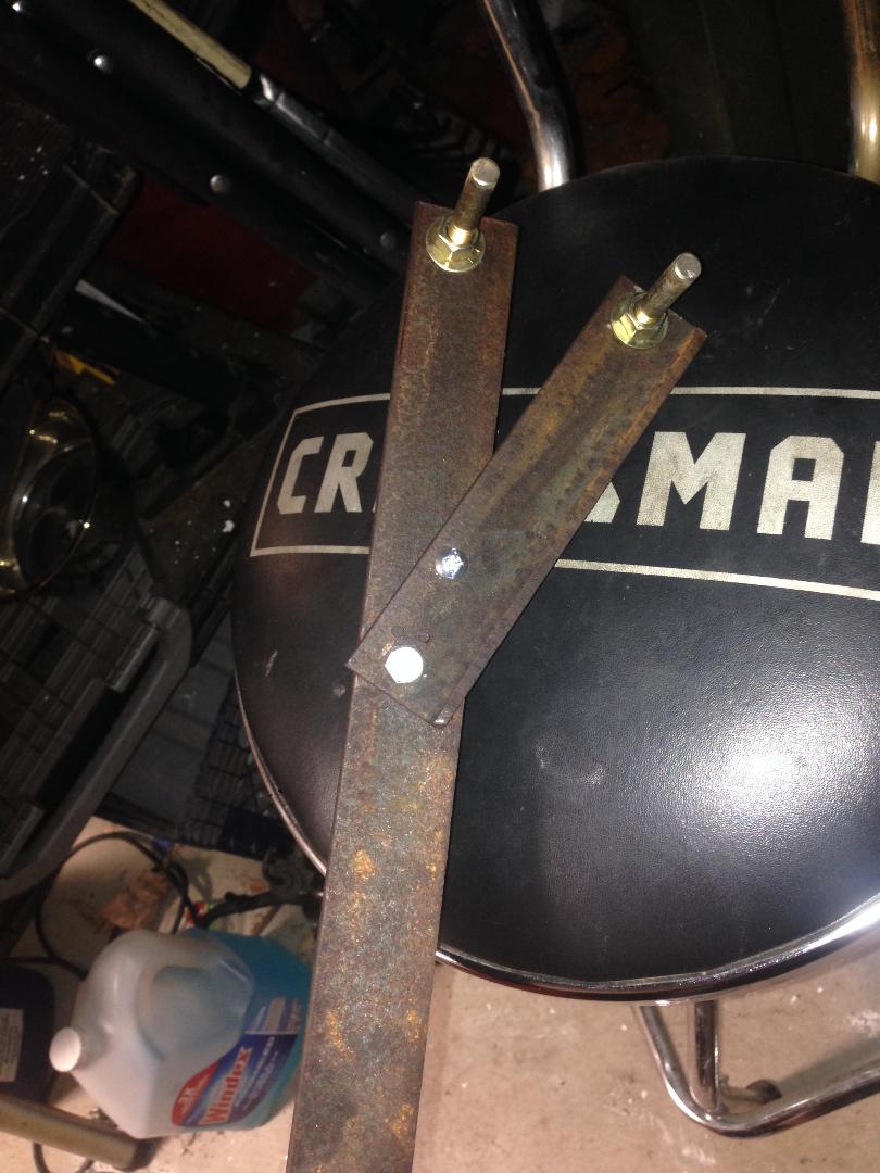

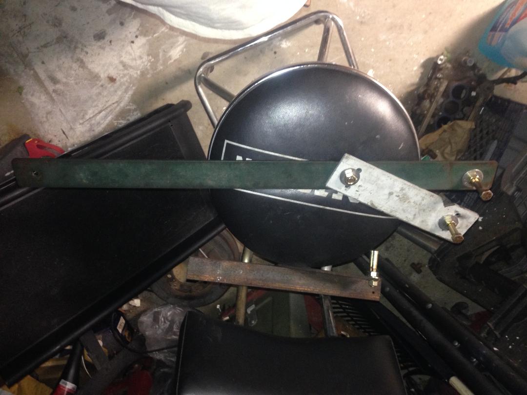

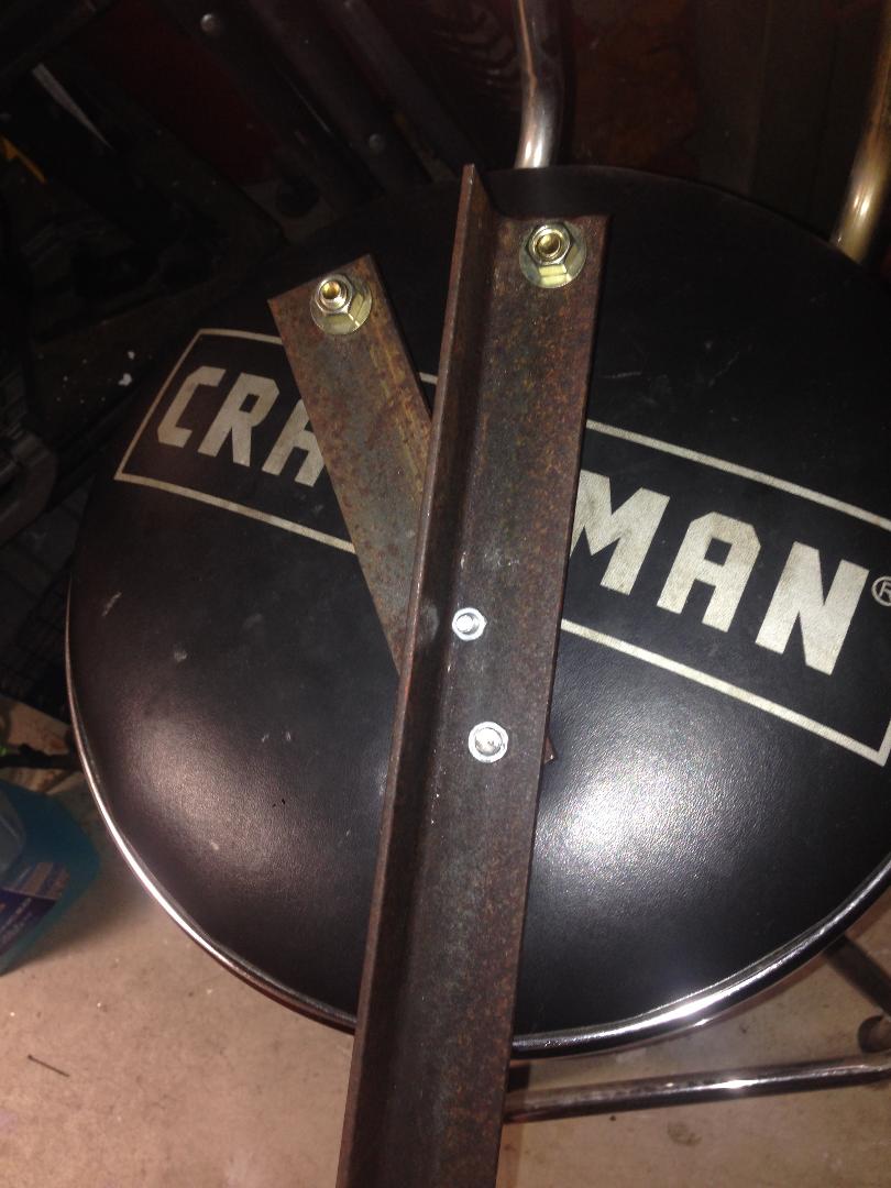

I made one with some flat stock and the size bolts stated above all that was needed was some thing to cut the flat stock and a drill for the bolts the style I made ended up looking lik a Y so you don't need to get the measurements perfect but use grade 5 bolts and some flat washers to spread the pressure out. You may need to notch where the socket goes threw. I think it cost me less than 20 dollars metal came from a scrap metal place. took about a hour to build plus running around getting the stuff. The first pic is for camshaft tool the second one is for crankshafts. I have used both 5 times without any problems the crankshaft tool rest against the frame while the camshaft tool is held when using. Good luck
