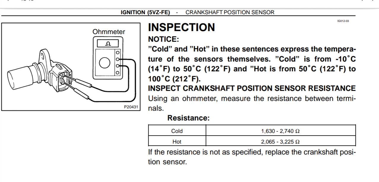

The resistance is not correct.
Per FSM resistance when cold 1630-2740 ohm when hot 2065-3225
I would just replace it
Excellent! Thank you for the quick response! That's what I was thinking, based on my searching and specs on other 2-prong types, but I couldn't find info specific to this engine. I've got a Denso model 116-1109 on order, should be in Friday. Fingers crossed. :)
