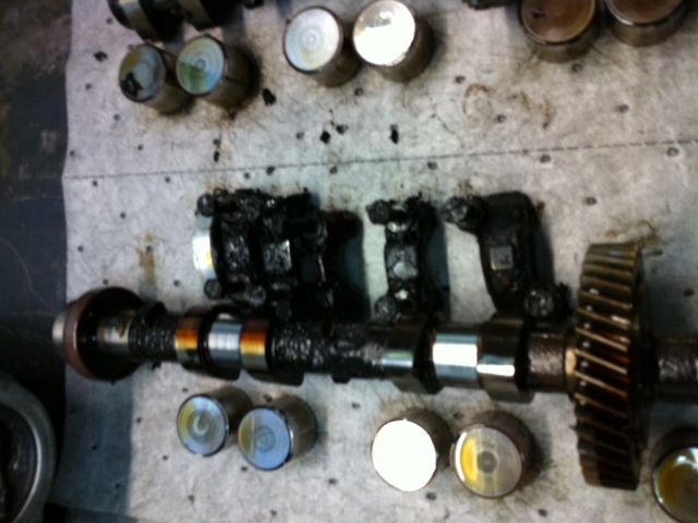

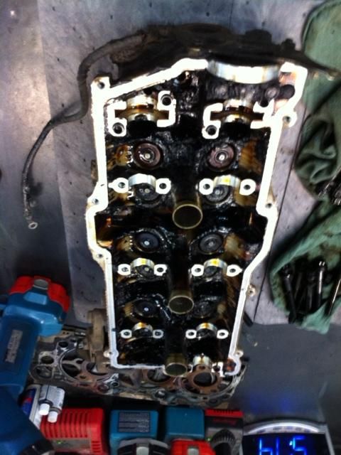

Monday, I got a call from the shop manager that the valve seals are bad well when they tore into the engine they were meet with a little surprise:
This is the photo that I was sent while at work.
:wow2:

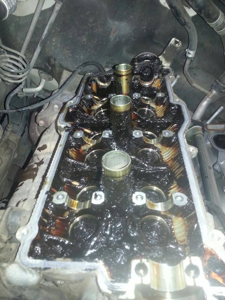

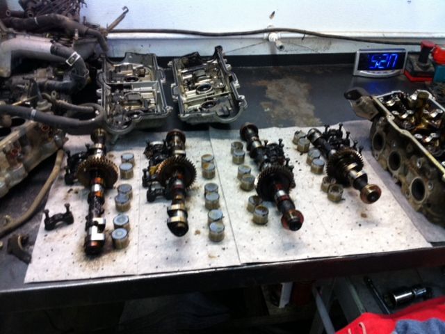

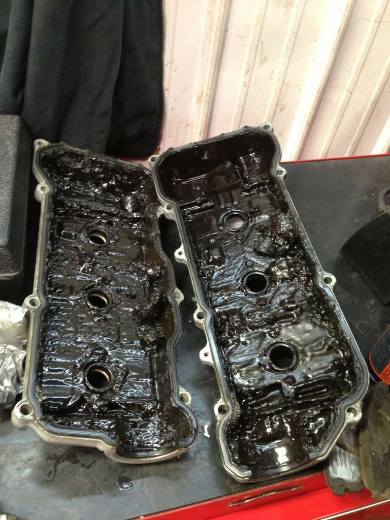

I've seen this on V6 models of 4th gen Toyota Camry's but not a 4runner. After work I went on down to the shop to talk with them about the issue and grab a few more photo's.

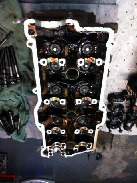

Head 1:
Head 2:

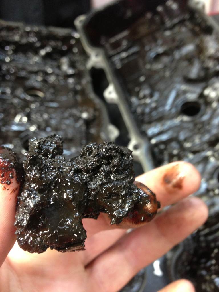

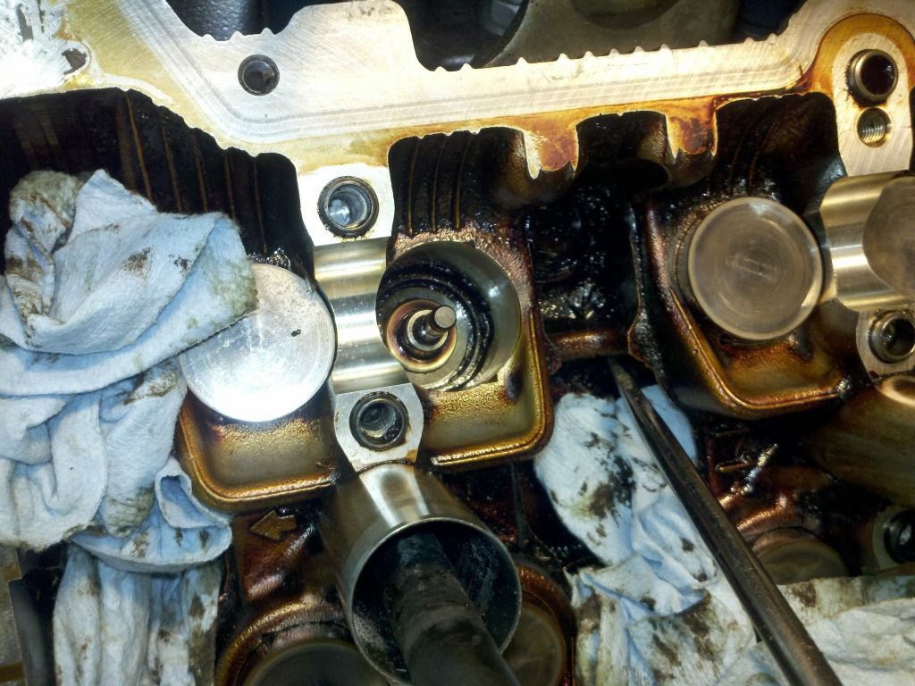

Clogged oil port (there was one that was basically completely clogged)
After seeing all this crap all I want to do was :bolt: or grab a gun and put my 4runner down.
The techs were surprised that my 4runner ran as well as it did despite all this sludge build up. Gotta love Toyota.

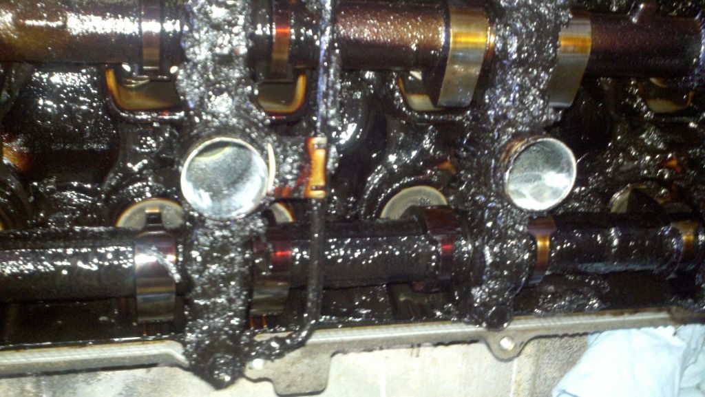

I had a similar issue with my doner V8. It must have been owned by a doctor because the oil was never changed.
75k miles and it looked like this.
