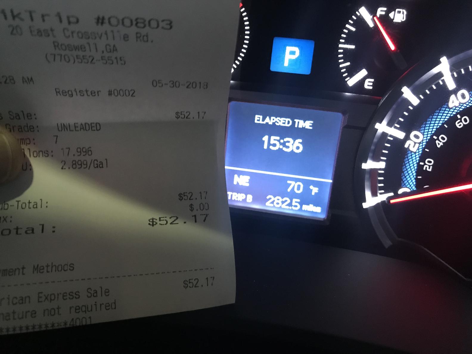

Here are the results from the fourth tank of gas after installing the Ecoblock.
100% city.
282.5 miles / 17.99 gallons = 15.7 mpg
Drive time was 15:36 - average speed is only 18 miles per hour. :lookout: Geez.
Two more tanks then I will remove it and drive 6 tanks without the Ecoblock installed.

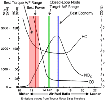

The fuel trim function of the ECU is dependent on the air fuel ratio supplied by the Lambda sensor. The learning function of the ECU is also dependent on the Lambda sensor and will give a long term / short term trim based on the change needed to get the air fuel ratio back to the AFR setting in the preset Lambda fueling table. The Eco Block cannot trick the ECU into ignoring the fuel trims needed to get the air fuel ratio back to the setting in the Lambda fueling table, instead it is smart enough to make this long term change by its self.
For this reason the air fuel ratio will never be "lean" as some are quick to say... instead the air fuel ratio will be exactly where the factory set it to be which is around 14.7 to 1 AFR which is the green zone on the graph. And when the ECU changes to the open loop fueling mode the air fuel ratio will go to a very rich setting closer to 11.3 to 1 AFR.
Now when the Eco Block is installed, the air fuel ratio will go into the red zone on the graph for the best torque and power numbers. These are very simple facts that can be easily checked / verified with the OBD2 scanner mo mo mentioned... no need to trust or believe anyone's comments on this thread, including mine!
As I have stated many times before, the Eco Block only changes the air fuel ratio when the ECU is in the open loop fueling mode, so the negative effects others have stated about the increased emissions and damage to the catalytic converters are just based on personal opinion and not any real facts. When you are guessing at what you think the air fuel ratio will be with the Eco Block installed it is very easy to have a personal opinion that is not factual.

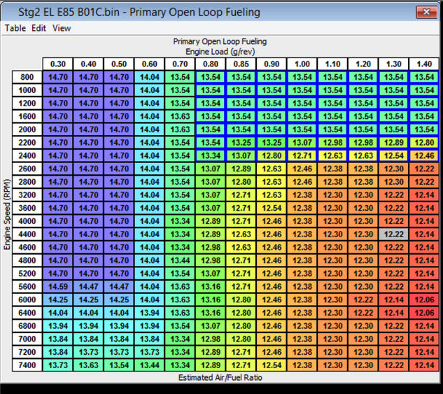

Non performance question: So during a cold start, which is open loop, will the eco block adjust for the red zone or does the ecu simply ignore maf input during a cold start altogether.
Good question... I assume you mean during idle while in the cold start mode, if so then the AFR will be closer to 13 /13.5 to 1 and when the motor gets warm it will be at 14.7 to 1 without the Eco Block. With the Eco Block installed you will see a leaner AFR in the cold start mode somewhere between 13.3 and 13.8 to 1.
The Eco Block trims the AFR by a set percentage while in open loop as opposed targeting the red zone. The red zone is the desired AFR at high loads where the green zone is the desired AFR at light loads, and the AFR varies between these two ratios depending on the amount of load / throttle applied. I added a basic AFR graph for as an example of how the AFR changes throughout the RPM and load points.

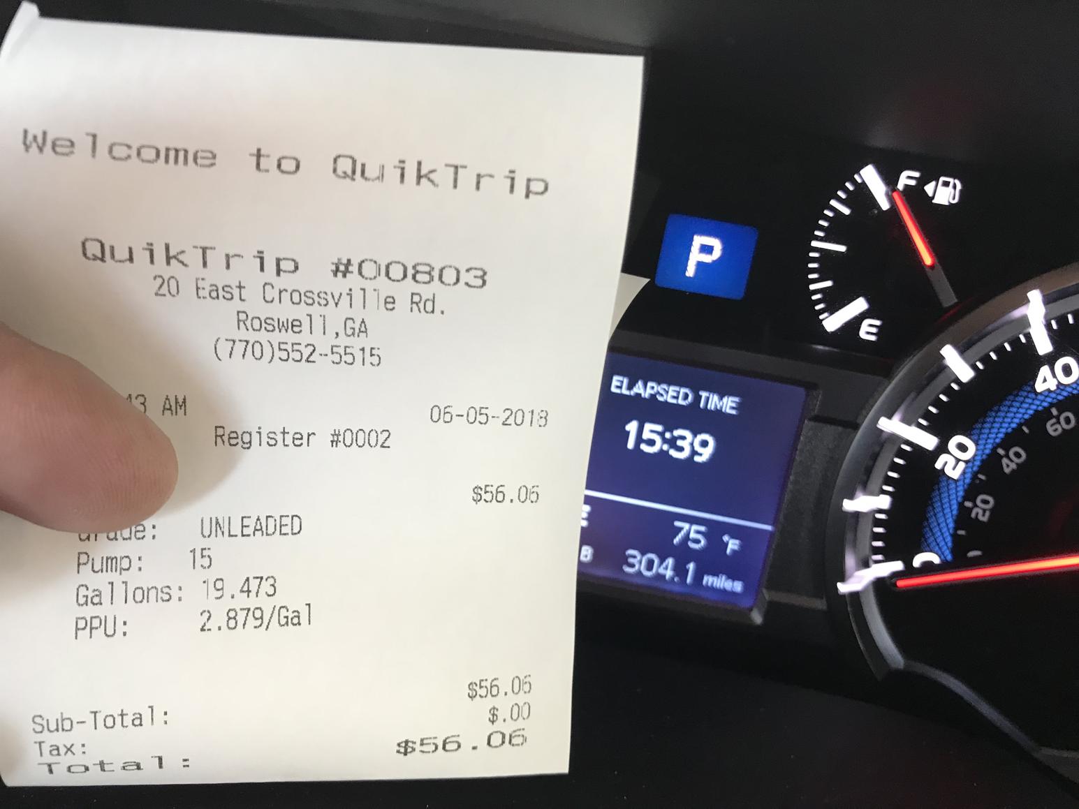

Tank 5
Tank 5 with Ecoblock.
100% city.
304.1 miles / 19.47 gallons = 15.62 mpg
Drive time was 15:39 - I can't believe how much time I am spending in traffic. I need to get this on the interstate for a trip.
One more tank then I will remove it and drive 6 tanks without the Ecoblock installed.

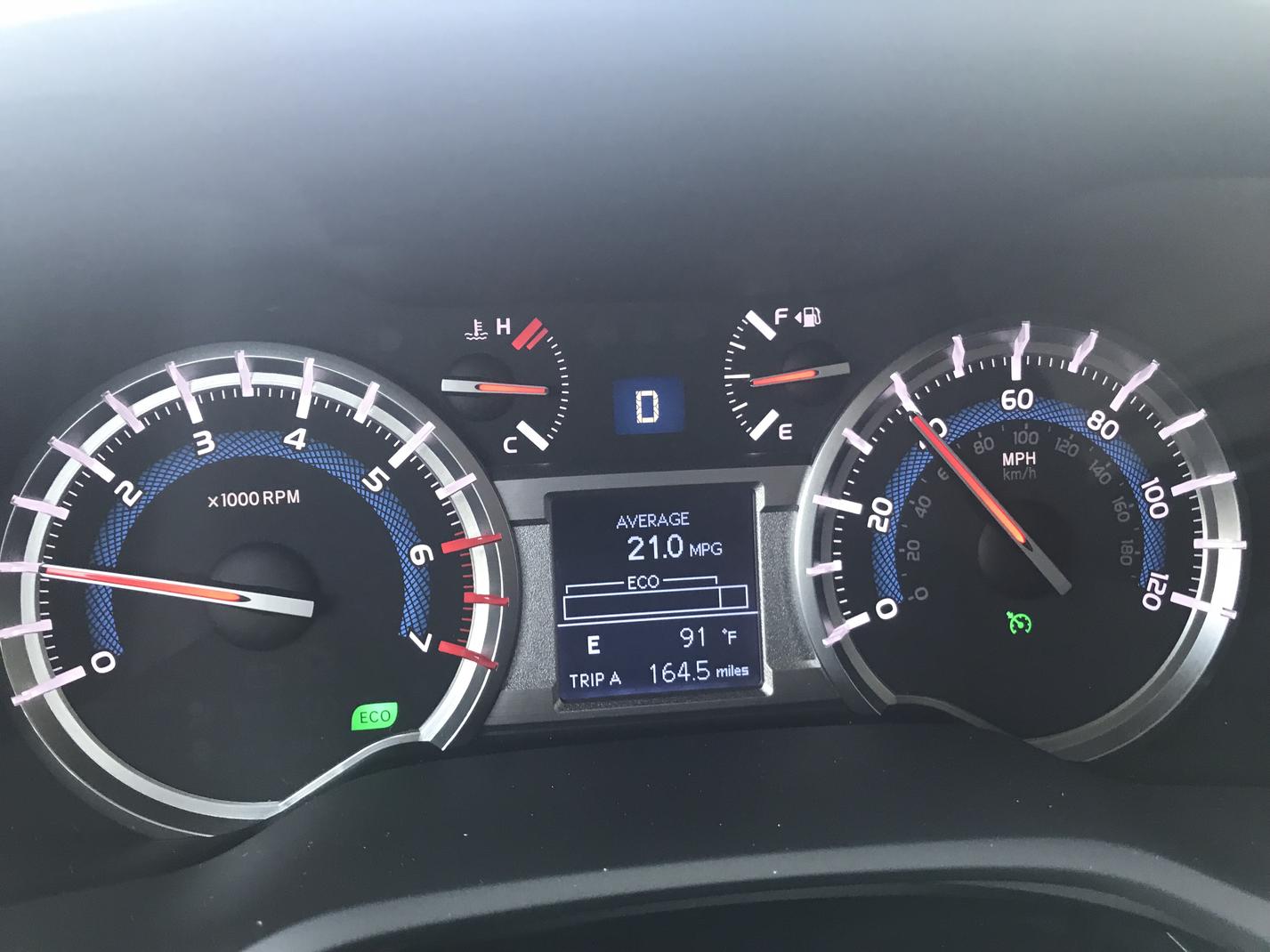

Sixth tank with Ecoblock

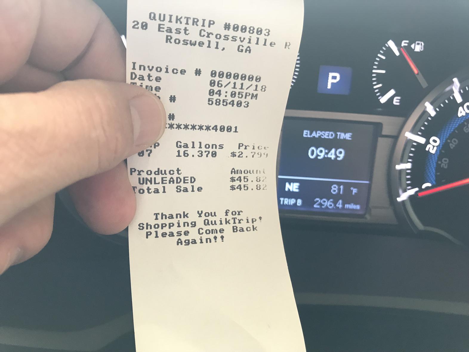

I finally was able to hit the interstate for part of this tank. I ran the trip odometer for it and set the cruise at 75mph - hilly - I75 north of Atlanta - if you live down here you'll know what I mean. The electronics said 21.0 mpg as seen on the photo. I know that is not accurate, but wanted to post that with my results for the tank.
296.4 miles / 16.37 gallons = 18.1 mpg
This tank was 45% City and 55% highway
I removed the Ecoblock this evening and will now run 6 tanks with it off for comparison. I am very interested in what the results will be for that. Stay tuned.

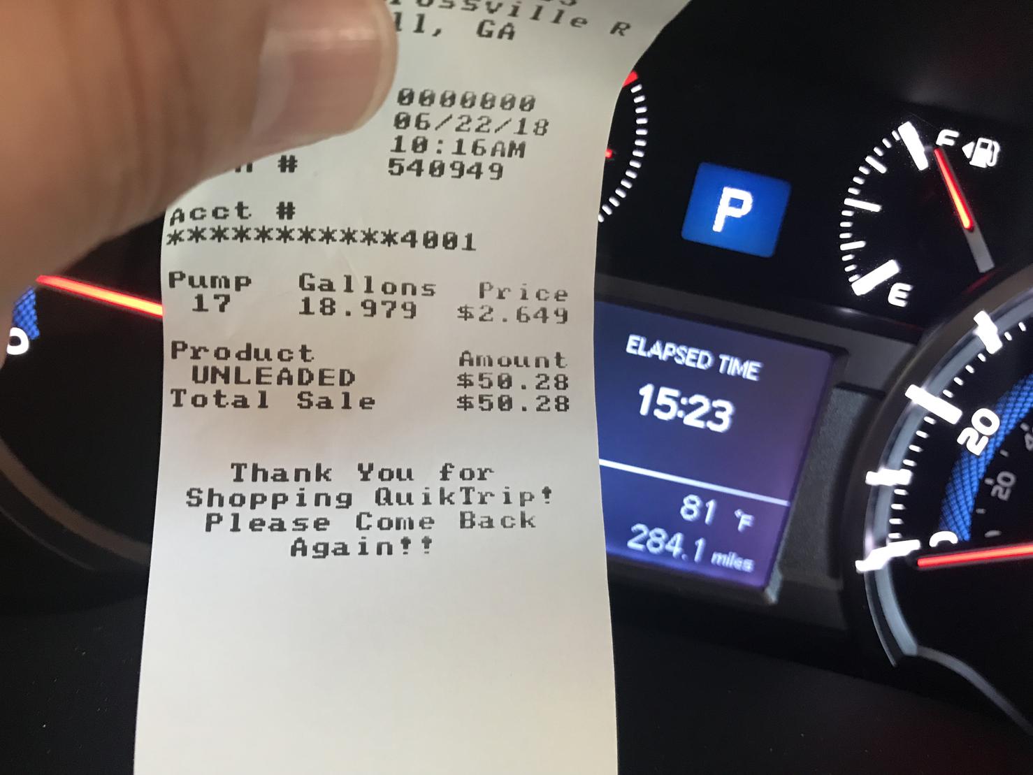

This is the first tank with the ecoblock removed.
284.1 miles / 18.979 gallons = 14.97 mpg
This tank was 90% City and 10% highway. Hours driven 15:23
Five more to go.:lookout:

Did you feel a difference in torque with the EB off? It should have felt a little heavier than when the EB was installed.

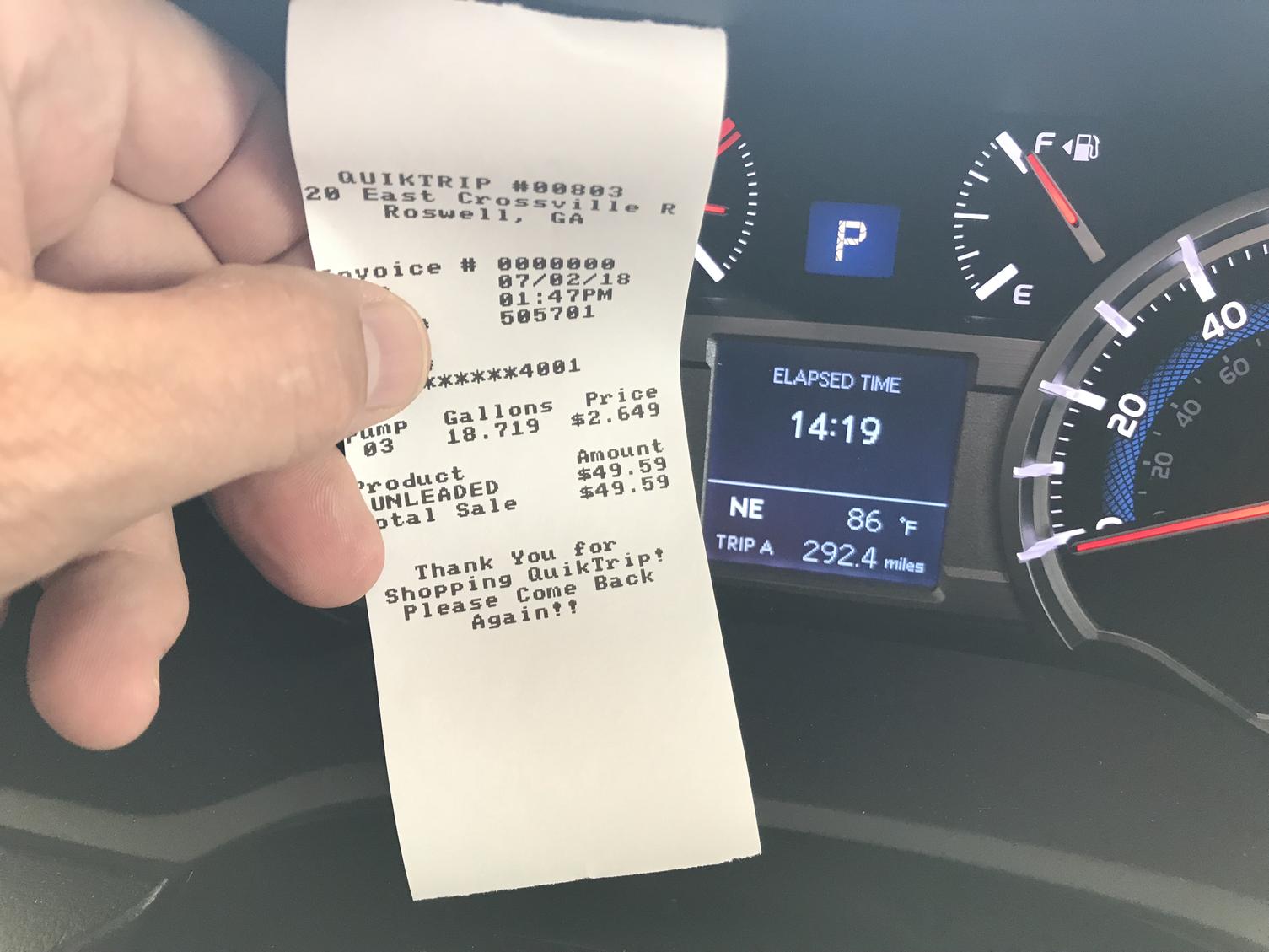

Tank 2 no ecoblock
Tank 2 with no ecoblock - stock.
292.4 / 18.719 = 15.62mpg
This tank was 90% city and 10% highway.
Drive Time = 14:19
