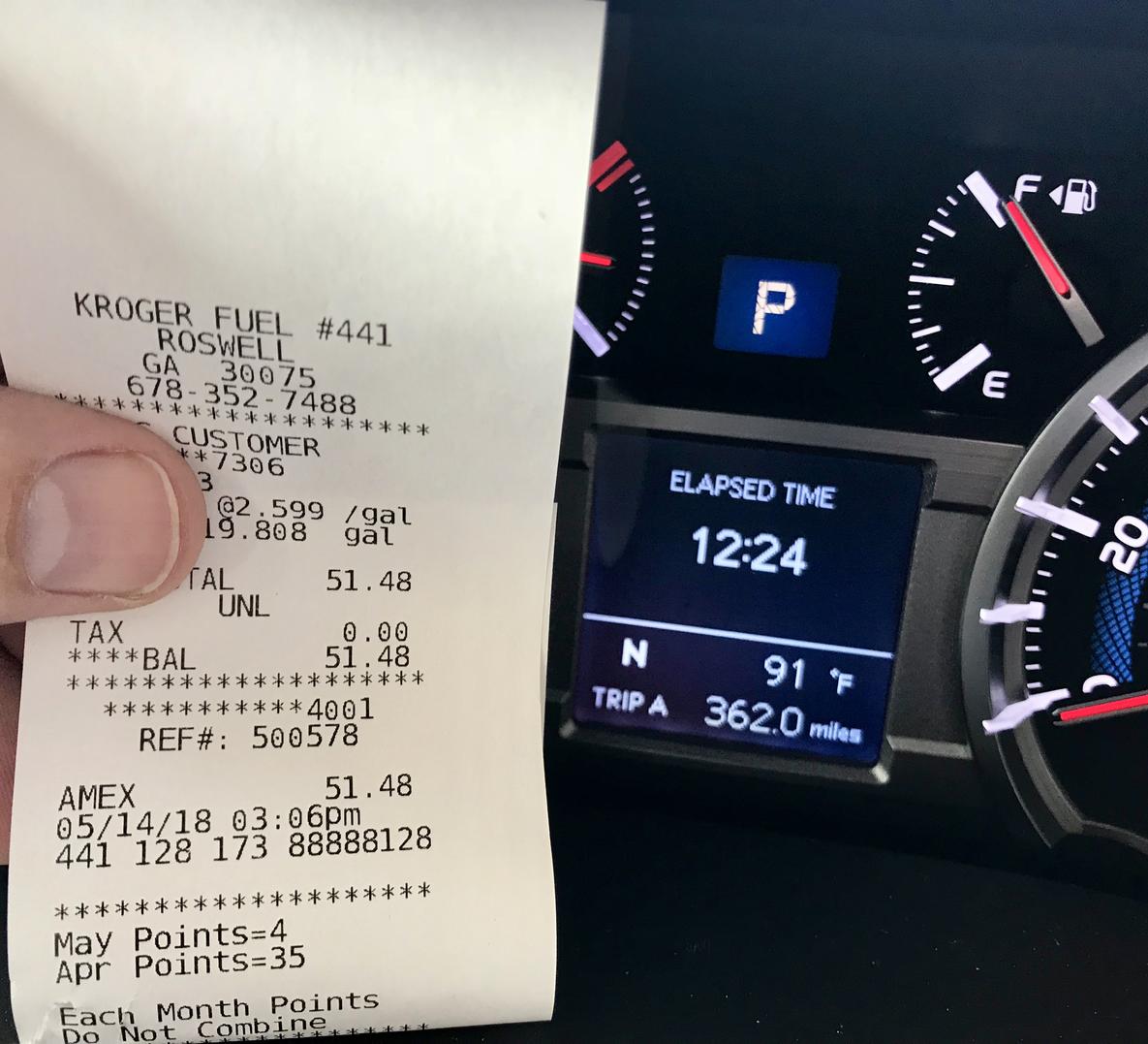

Second Tank Results
The purpose for sharing my results is because few people have done it, and that number is almost non-existent for results from more than one tank of gas. This is the sort of information that could've helped me make a purchasing decision one way or the other. I know that this thread is full of members with a strong opinion on this product. I am not trying to sway anyones opinion, just providing some facts to the discussion.
Here are the results from the second tank of gas after installing the Ecoblock. I would estimate this tank at about 60/40 city/highway.
362 miles / 19.8 gallons = 18.28 mpg
Drive time was 12:24 Traffic in Atlanta sucks.

I appreciate you posting your mpg. The problem is that it doesn't tell us anything. Without having a counterfactual example where you remove it and do the same driving, I'm not sure what we would learn. I get better than 18mpg with 34" tires sometimes. But I also get 16mpg sometimes. It just depends on what I do and where I go.

Thanks for taking your time to collect and share this information with us, please keep it coming :)
I know its a bit early, but what's your gut feeling at this point about the product?

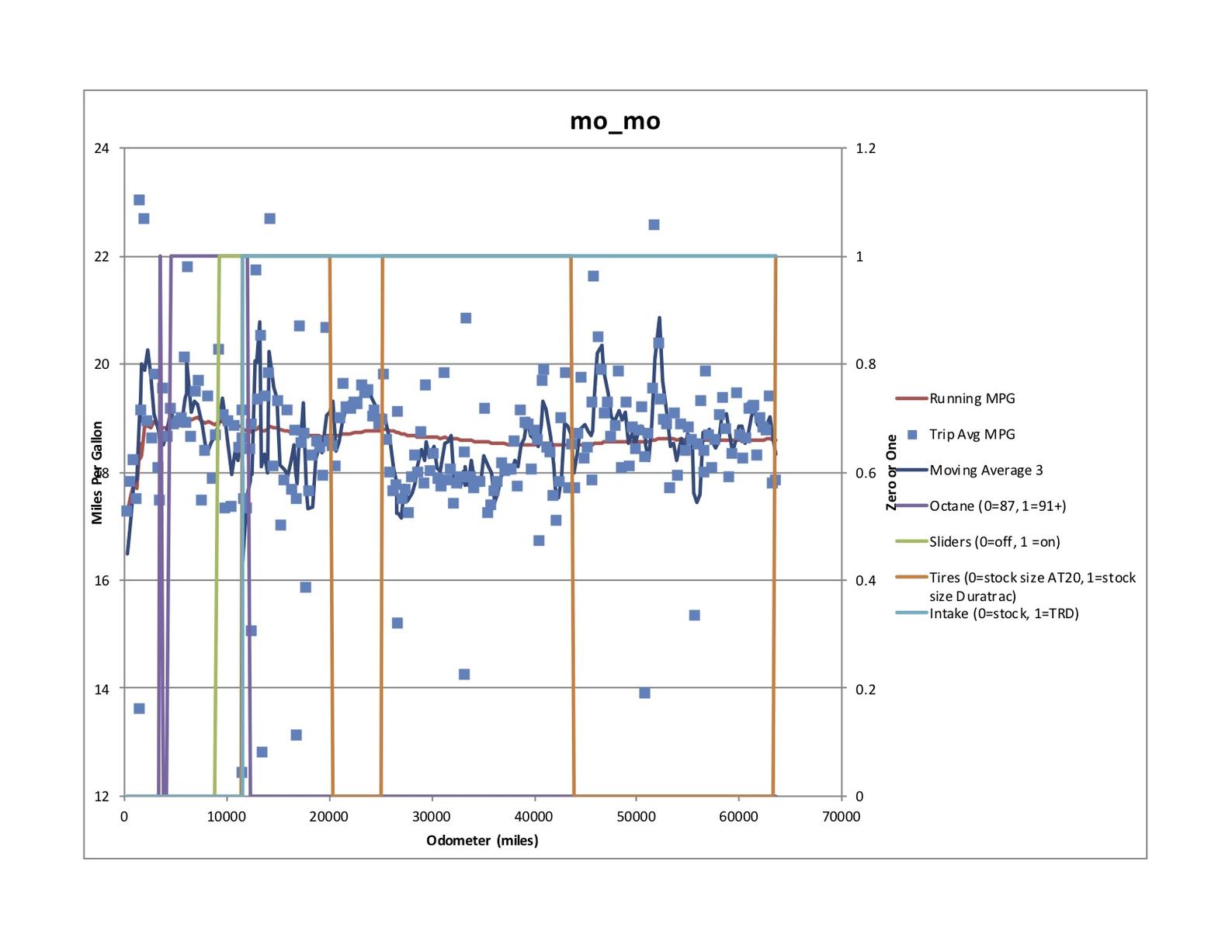

Here is my MPGs tracked since inception (minus the 22 miles on the ODO when purchased). Here are my observations:
1) 1st 1500 miles it ran low on MPGs (I also went on a 500 mile freeway road trip at this point). Was the computer adjusting trims, was this due to break in of the vehicle, pedal position commanded input, or something else?
2) I was initially driving with the 'ECO' light and meter on. I think this was detrimental to MPGs as I 'lugged' the drive train while getting up to speed which wasn't necessarily efficient.
3) You can see the slight decrease/increase due to tire swapping. The LT duratracs (stock size) are noticeably heavier (inertia resistance) and not a highway tread (rolling resistance).
90% of my miles are over the same stretch which doesn't vary weekly by more than 80%. Traffic on those routes varies, but that's why I'm looking at the long term averages. You can see when I added sliders, when I've swapped tires, when I've run 91+ vs. 87 octane, and when I swapped intakes. If you do something similar, with baselining and then making a change, your data can add value. There are lots of variables in MPGs that have been discussed ad nauseam that we don't need to get into here but that is why baselining is critical. Good luck and keep us informed!

That's impressive [MENTION=112119]mo_mo[/MENTION]! Did you just create a spreadsheet for that?
Yes. I write the miles and gallons in my phone and make a note if I change something. Then every 6 months I'll update the spreadsheet with the notes from the phone.

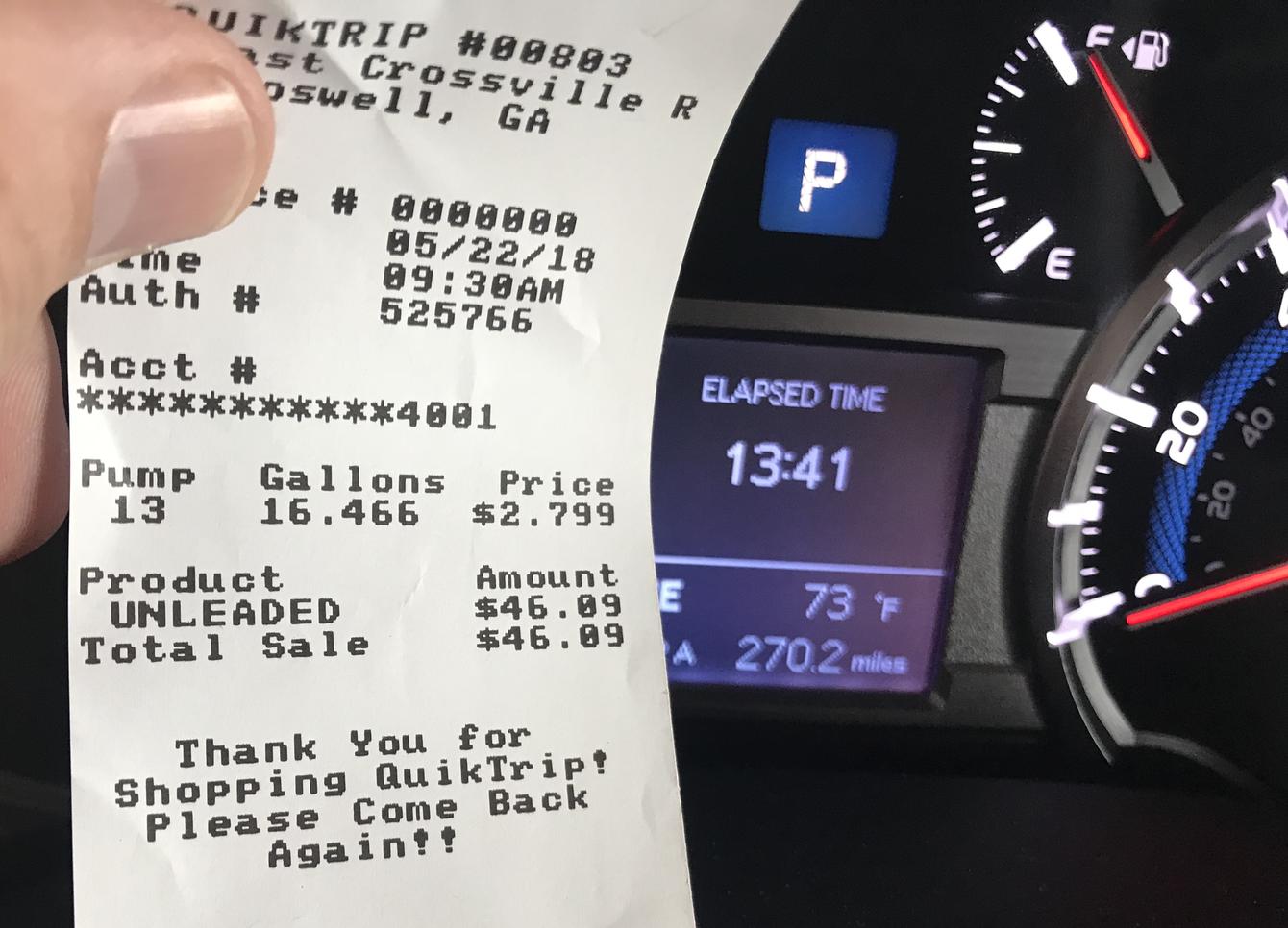

Here are the results from the third tank of gas after installing the Ecoblock. This tank is 100% city stop and go traffic -
270 miles / 16.46 gallons = 16.4 mpg
Drive time was 13:41.
[MENTION=121742]Quirt[/MENTION] - I am not sure what I think at this time. I wish I had documented what I was getting for mileage before instead of estimating it. Once I run tank of gas on an exclusive interstate only trip I'll be able to sum up my thoughts.

Understood... What I would recommend is to run through 6 tanks of fuel to get yourself a baseline average with the EB then remove it and do another 6 tanks so you have a back to back test / average.
Thanks for sharing your results so far and I look forward to seeing more.

Am I the only one that thinks that feels that gas pumps measurements might be a inaccurate. Are all gas pumps calibrated regularly? I really don't know. I have a hard time accepting that all gas pumps were created equally.
