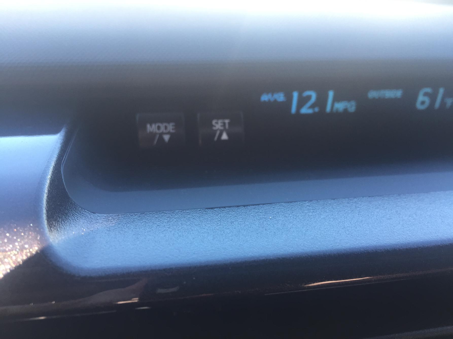

I have calibrated my Ultra Gauge multi-times since it was installed and I always double check the math. I have no dog in the fight, mine cost me $45.45 shipped to my door. I plan on ordering one for both 3.4l 4Runners and my wife's 2003 4.7l V8 4Runner.
My mileage on the tank prior to the install was in the high 18s, I have never gotten over 20.4 on any tank since I bought the Tacoma.

I get this kind of mileage if i'm not careful on just city driving. Let me put it this way, if I have done nothing but city driving for 200 miles, I'm happy if i get 13.5MPG on the dash.
