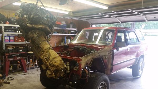

Here is what we are starting with. A completely stock 88 4Runner.
The engine is a 3V-Slow and oil pours out faster than you can pour it in. So, after researching, we decided to search for a better engine. I found a 5VZ with 60k or less miles. Used 1995 T100 ECU on the way to control engine and transmission.
Let the swap begin:
Out with the old

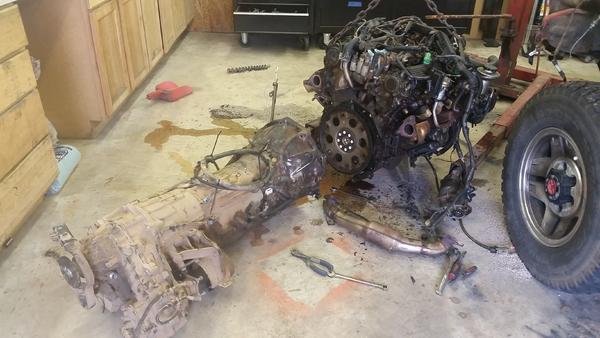

Engine and Trans separated

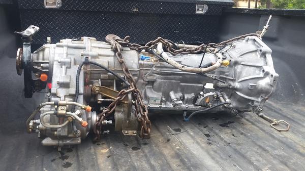

Transmission cleaned up and ready to take to trans shop. It was working perfect, but, I am not going to go through all of this and it fail. So it is getting rebuilt.

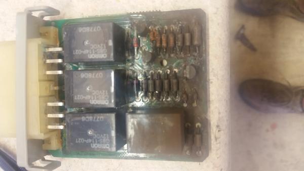

I could not get the back window up. Checked all safety switches and of course the last thing to check was the problem. Right behind the seat belt on drivers side sits the factory relays for the rear window and wiper and washer. I have no idea why they installed it with the connection facing up. But it filled with water at some point and destroyed it.
IF YOURS IS STILL WORKING, GO CHECK IT!!! IF THE CONNECTION IS FACING UP. UNSCREW IT AND TURN IT SO THE CONNECTION IS FACING DOWN.
I did not even attempt to call Toyota, I heard they were like $400.00. So I replaced it with two 5 pin relays. The rear wiper is not functional anymore so we are going to remove it and install a LED light on the back of the top.

... Right behind the seat belt on drivers side sits the factory relays for the rear window and wiper and washer. I have no idea why they installed it with the connection facing up. But it filled with water at some point and destroyed it.
Good catch!
AND restore the louvers on the vent. Water (i.e., horizontal spray in the car wash would get inside that body panel through the vents if the rubber louvers are gone (which is usually the case with old trucks).
...The rear wiper is not functional anymore so we are going to remove it and install a LED light on the back of the top.
