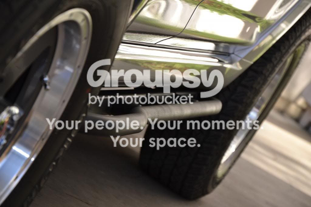

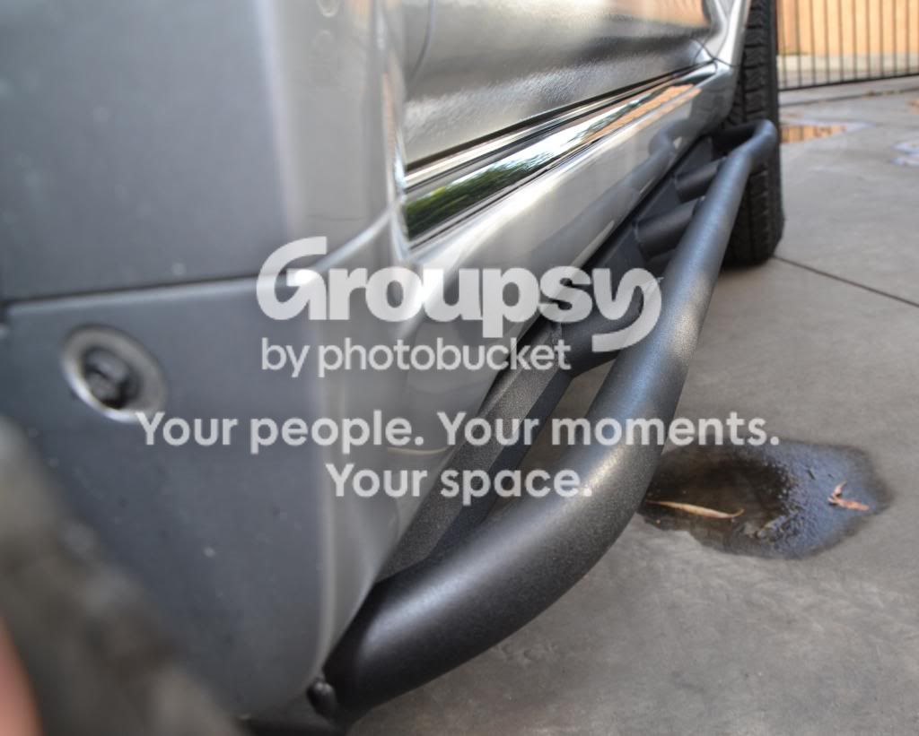

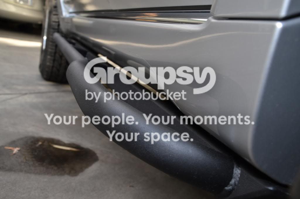

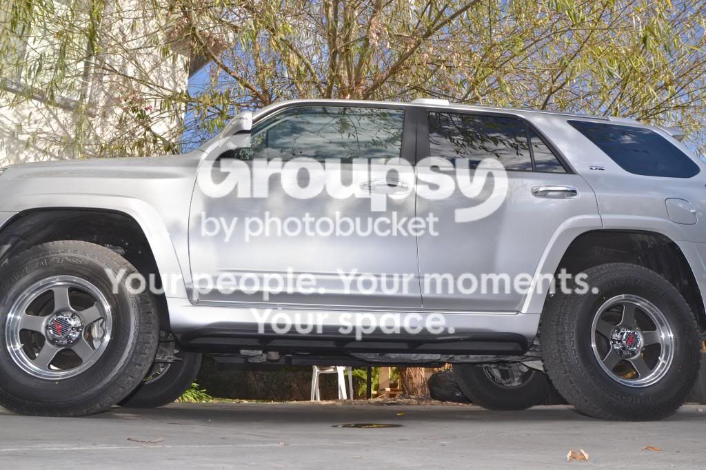

Installed my new sliders today from White Knuckle Off Road. Customer service was awesome. I picked them up from their shop in Apple Valley and got to meet John. Awesome experience I would recommend to anyone. I ordered the sliders bare metal, and prepped and painted them myself. I spent about 1.5 hours each degreasing and sanding the sliders. Then put 3 layers of rustoleum self etching primer on both. The following day I sprayed 4 coats of rustoleum bed liner and set them aside for a week to cure. The Install was pretty easy...only required some jack stands and a wrench. Here are some photos of the finished product.
