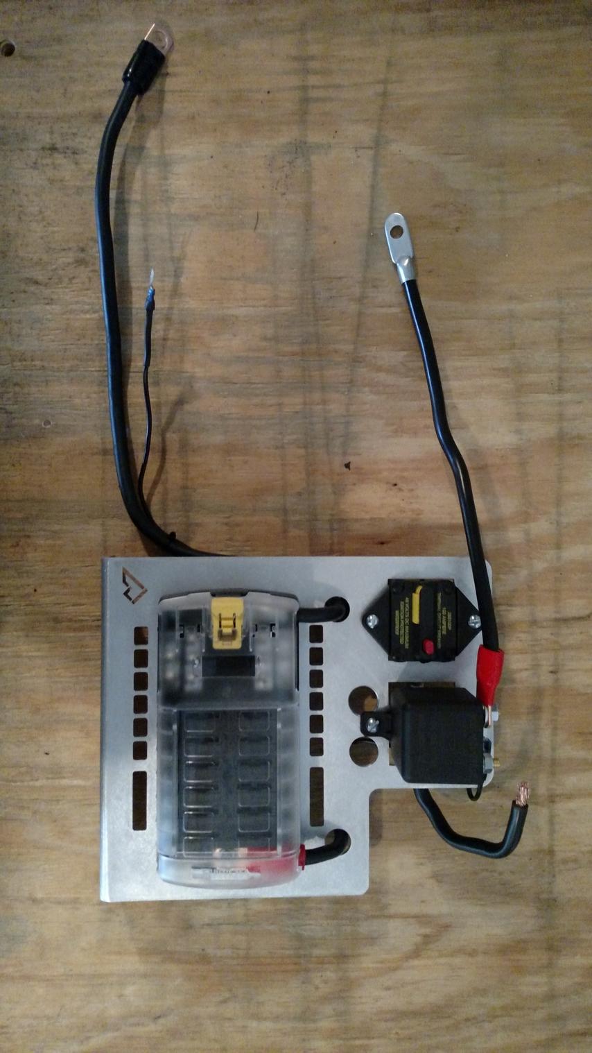

Alright, aside from all the wires being black (Generic battery cables are way cheaper than actual cables for designated models), and the last connection I need to make, what's some thoughts on how I have this set up?
The cables are 6ga. I don't intend on having it powered unless the ignition is on, hence the 100A relay. I'll connect that to an ignition on circuit to switch the relay on to power the panel. The wire on the top right will connect straight to the battery. The other side of the relay (that still needs to be connected) goes to one side of the circuit breaker (under the bracket) and then on to the hot side of the panel.
I've done plenty of reading on it and I think it's good. Just looking to make sure I don't burn my truck down.
