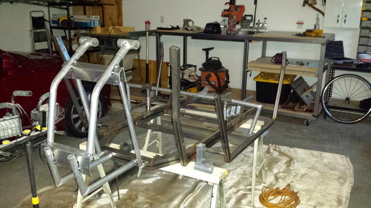

This is the beginnings of an aluminum chassis parts mock up some friends built in my garage a couple years ago to accept IIRC Polaris RAZR parts. I can't find a pic of the final assembly once it was stripped back apart and finished. Looks like the black OEM frame, just lighter. It's surprising how basic they are. I was thinking of a similar 4 seat mid-engine or rear engine version. Then basically use the sheet metal from the land cruiser narrowed to fit. Keep it to something like 37-40" tires and it'd probably be a light, easily towed, UTV that can also run most of the hardcore stuff the UTVs cant do.

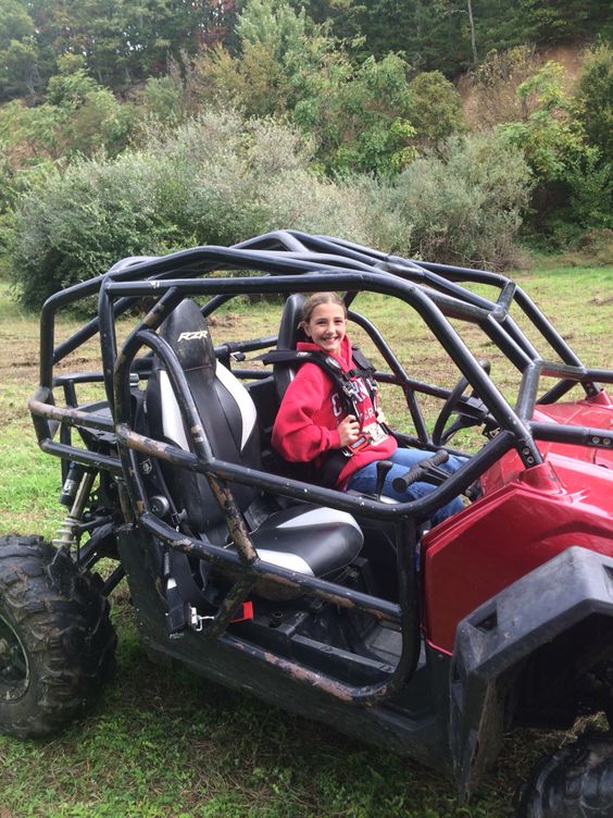

The problem is that so many of them end up like this: which is horrible for performance and probably adds very little marginal safety benefits by being way overbuilt:

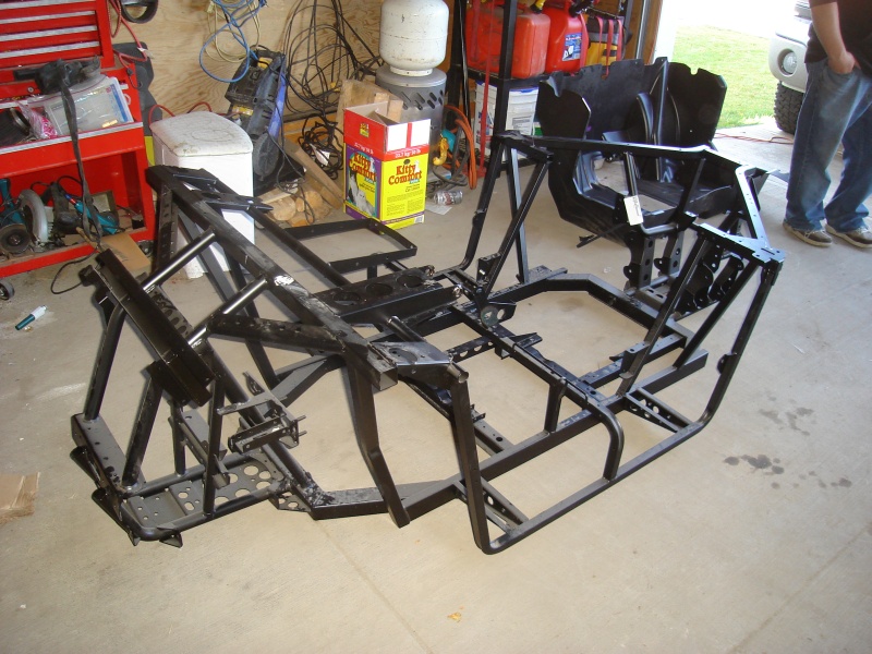

The goal would be something that looks very similar to this, but with a drivetrain that I can go flog all day long and not break stuff.
