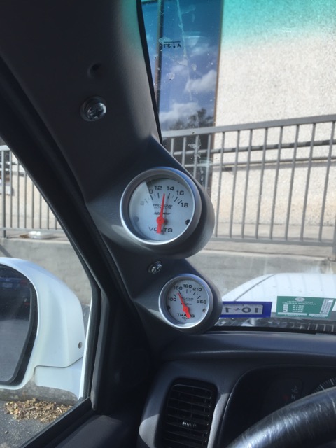

If you don't mind not having the gauges mounted on the A-Pillar, you can always mount them under the ashtray like I did. Here's a couple pics.
You can just see the wideband gauge peeking out in this pic, but it gives a general idea of the location.

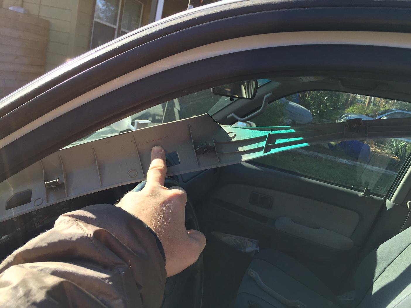

Here is where you find YOUR part number... see pic

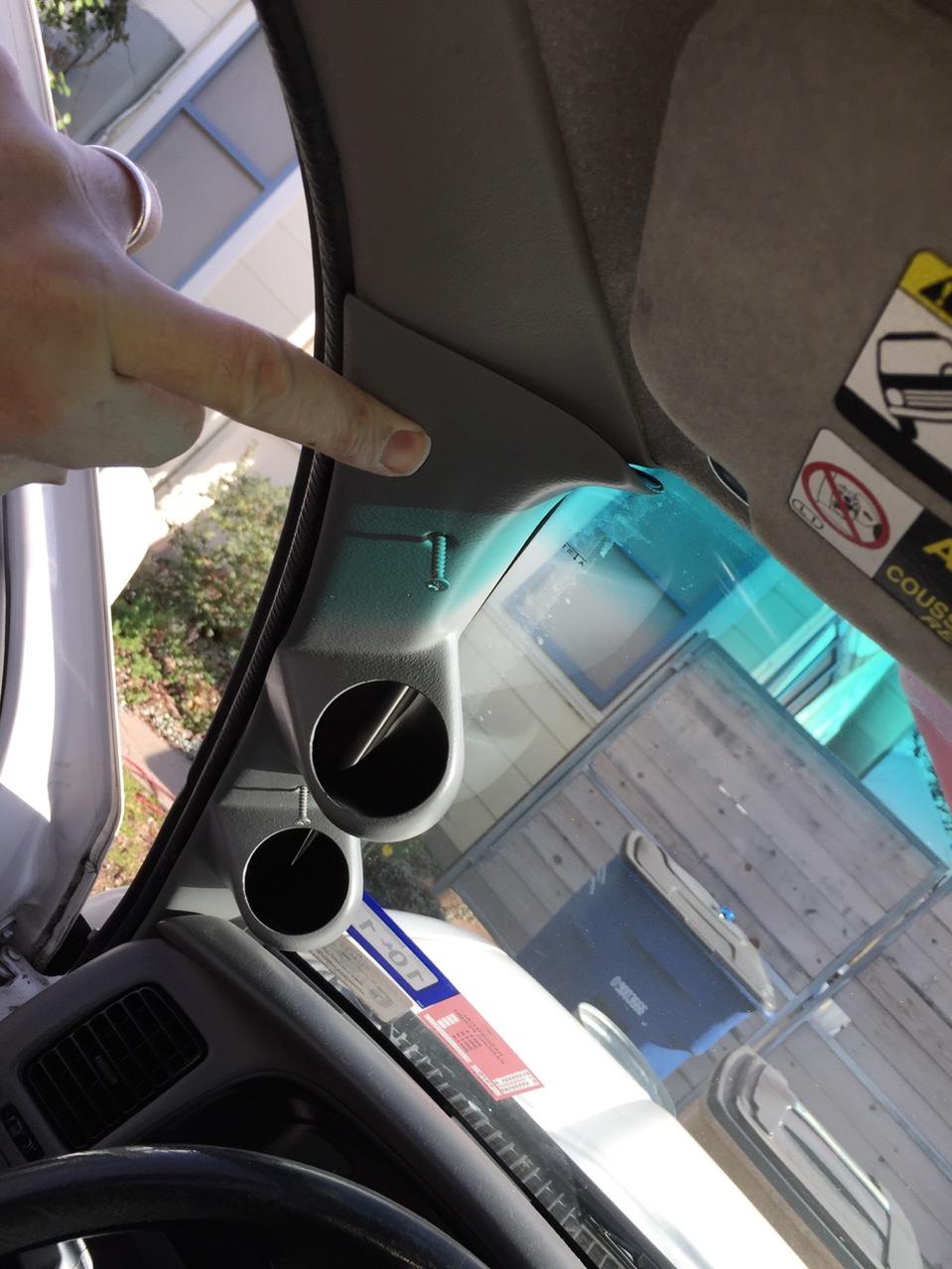

Ha ha! It fits!
Check out the picture. Sure looks good to me. I ordered-
Product Name: 1996 - 2000 Toyota Tacoma/4-Runner/Tacoma Double
Full pillar
* Color: Gray
Item#: ZCX0183
Unit Price: $52.98
...and it looks fine for my 2002.
I'm just holding it up here since I'm not ready to install. Note that the "center" screw, the one between the gauges, has no where to go. It just happens to fit right where the big hole is for your grab handle so you will have to add a backer of some type, glue it, or put a new screw somewhere. Maybe this is what lotek was worried about? not a big deal to me. Sure beats fab-ing up my own!
Also, my eyes are not what they used to be but I could swear the pillar on my 4runner is OAK and the door is gray? I must be seeing things. Anyway... I don't give a sh..t.
Having said all this... I take no responsibility for mismatches and I'm guessing lotek would expect you to pay return shipping as well if it didn't work out so.... buy at your own risk but it sure look fine to me.

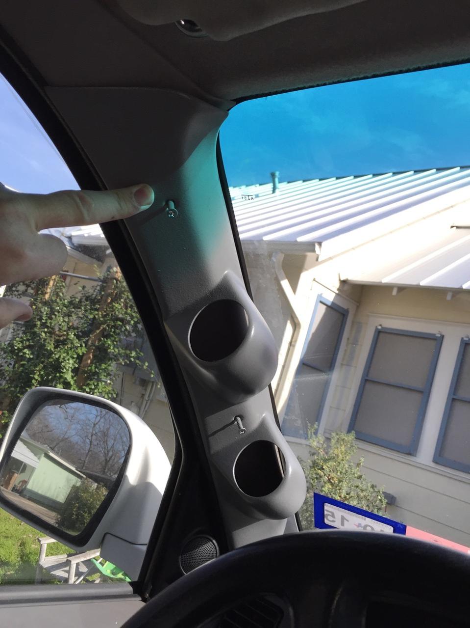

I used a Lo-Tek A-pillar two gauge pod and it's worked out okay for me - the holes were slightly off of what my 4Runner had and so it required some custom holes. Not a big deal, I used a couple larger washers to cover the elliptical holes. At least this way I was able to get both bolts in the stock location (where the grab handle used to be).
There should be some pictures of it hiding on my computer some where...
Finally did my install
Worked fine. I opted for using the factory bolt holes in the 4Runner...
6mm x 25 bolt and washer... I'll put fill that leftover hole later... or not.
