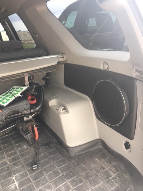

They used the cover for the storage as a template for my box.

Yes, they added sound deadening material inside. I still get a little rattle when there is a lot of bass in some music but that's because that's the only area that has sound deadening material. Personally, I think my setup has a much cleaner look than what the OP posted. If I ever sell(which is highly unlikely) I can just take the sub out and put the storage container and lid back in and keep my components. I think it sounds awesome.
It holds a 10 inch sub? How much did you pay for it? Can the place that made it make another? How many Cubic inches inside?
