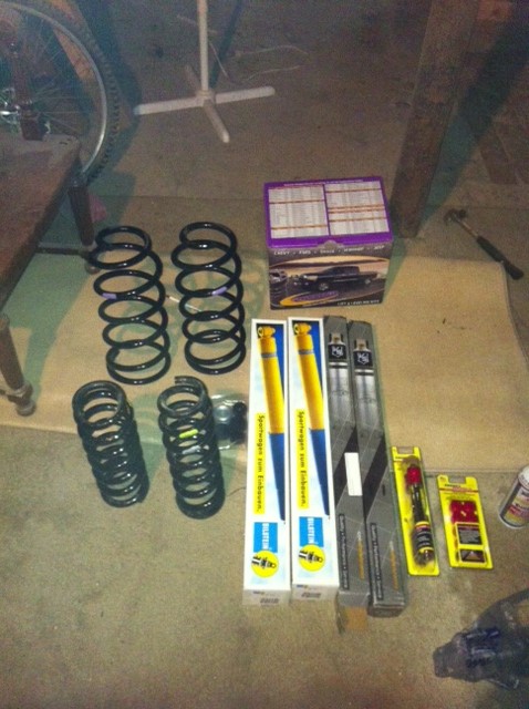

Have everything for the links and installing tomorrow along with the rest of my suspension. I bought the 1" spacer because someone that did this(maybe you) mentioned you have to cut it a bit anyway. Any tips that you can give would be awesome. Below is what i have going on. I don't know if I want to go from 265/60/18 to just 265/65/18 or 275/65/18. Anyone have a similar set up. Also anyone else who has these links, how are they working out?
FJ Coils
5100's front - Set to 1.75
Icon 2.0's rear
Links
1.5 DS space - rear

Nice man! Yeah the beauty of this is the price and simplicity. I cut my spacer when I did mine because the only reason it's there is to change the ID of the hole in the sway bar to fit the eye bolt. Some have just slipped the bushings over the spacer and haven't had any issues. I don't have the same set up as you have lift wise but I'd say move up to 275's or 285's, but that's just me.
