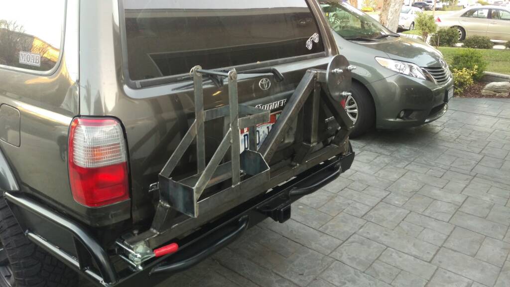

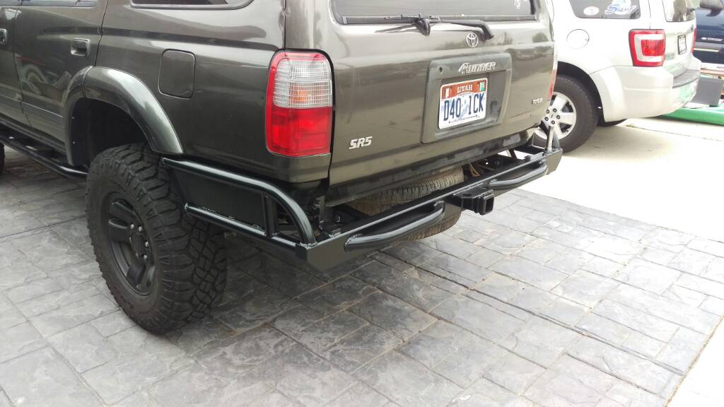

Ita finally finished. Still building the tire swing and I need to put on the top of the bumper to eliminate the empty space, but other than that it's done.
Looks very cool. I like it. I would suggest putting something in the gap on the top to make it look even better.
I want to retrofit a hitch into my rear bumper somehow.
Also, you should chuck this in the 3rd gen section if you haven't already!
Yeah my plan is to put some sheet metal on top right there. I have the tabs welded in already. I just need to get it cut and get it in there. Thanks for props
Looks pretty badass man! been think about build a tire carrier myself. what resources did you use when deciding on a design?
Pretty much just have everything a look. The tire and gas carrier were the easy part to design. The latch portion was the hard part. Just did a Google search for different designs and got ideas from there
