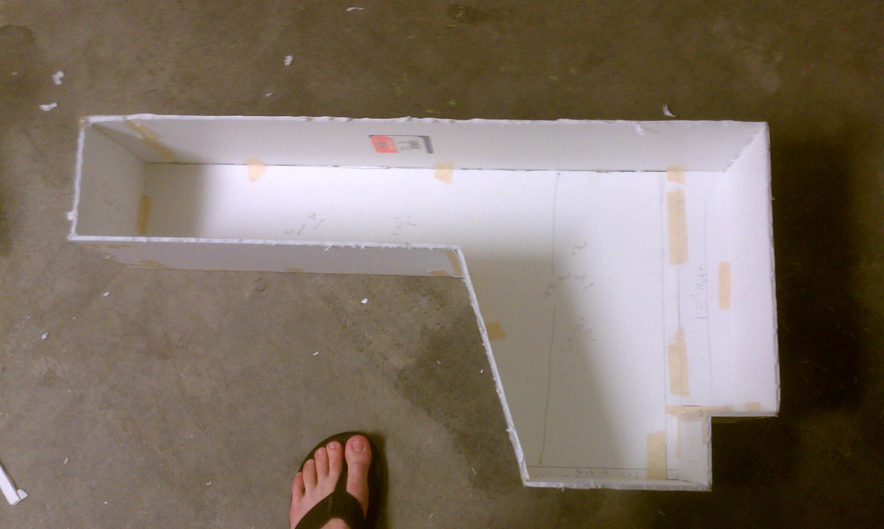

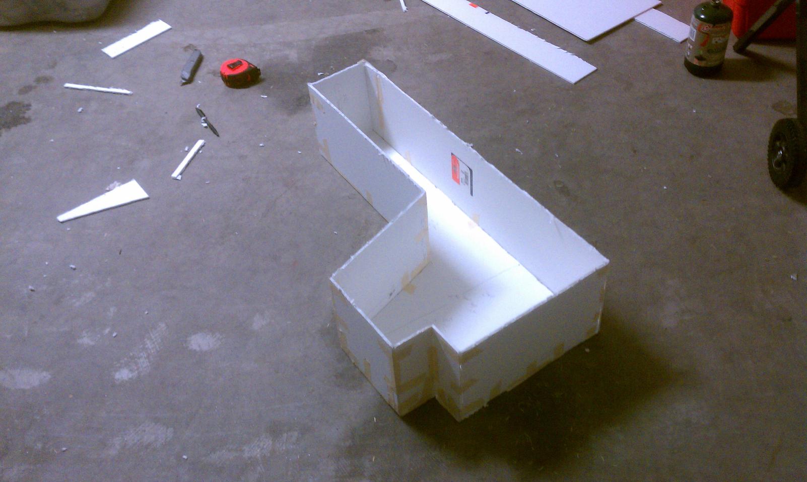

2005 Toyota 4Runner. Box build templet out of 1/4" foam Board.
Using measurement - taking in count that its 1/4" foam board and the actual build will be 3/4" MDF. The total volume estimated (0.7753 cubic feet)
What Do you all think?

Main Question is before box will get built -"Is there too many corners to rid this box useless?"
Yes i thought of that, however by slanting the back it will be maybe give little more volume or no change. the slant is not a hudge distance due to the height keeping under the trunk cover. even so its not enough to make difference.
I like the Kk audio look, but for that price its more efficient to think outside the box.
i would still slant the back and make it look flush, u might as well do it since u still fabbing up the box part before the fiber glass.
I think i would make the box inside the side panel instead of like the JL box. To me that just kills too much room. I think if you used fiberglass instead of wood you could get a decent volume for a 10. If you set it out a little you may could fit an efficient 12.
Yes, fiberglass would be a smoother install and cleaner bass response due to the lack of corners. However I hate to fiberglass and I'm not good at it.
Putting the box in the side panel would not be efficient. Cleaner look but as for bass response there is not enough air flow for a 10" sub. So then the box will have to be build outward from the panel which still will take up space.
As far as taking up space in the truck, I think it's a perfect fit. Its all wasted space plus the amp spot fits inside the extra space the box hangs over.
I am not worried about fitting a 12" sub. I have plenty of mid snap coming from my amazing Focal 165KR 2 ways. I really do not have a need for a sub but a 10" done properly will clean up the sound allowing just the correct amount of bass to highs. If I were to put a 12" sub I would need to upgrade the doors to either a STRONGER 6" (but what affordable speaker am I going to get rated above 150 rms that sound goods) or just upgrade to 8" high. Relocating the door speakers would also help.
