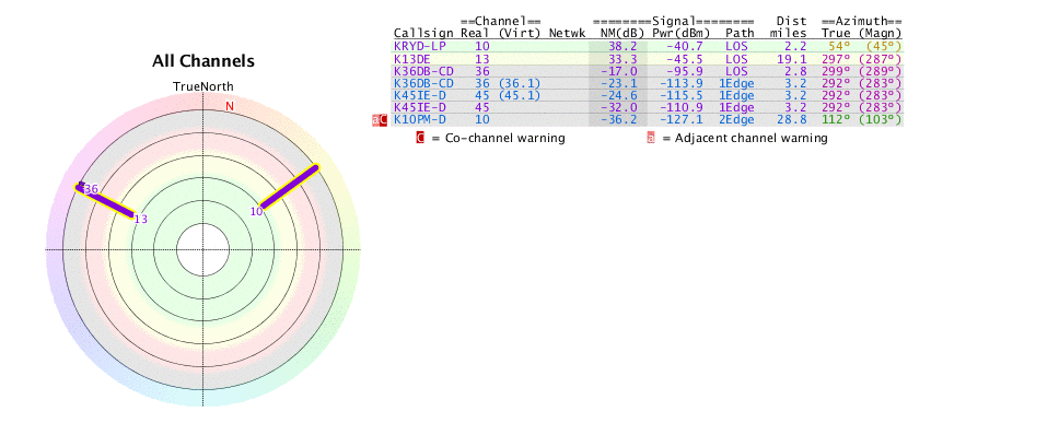

Check out this site: TV Fool
You put your address in and it tells you what you need, dish wise, for different types of installs, where you should point it, and what channels you can expect.
This site says I can only expect 6 channels. Does that sound about right? might not be worth it if all I get are PBS and our local channels...
Not sure... you can post the report here and we can take a look. I wonder if you'll need something with a little more umph out there.
lets see what we have here.....sorry to hijack your thread Bofa. Appreciate the help! I had to dink around with the address a little more, which netted me a 7th channel :clap2:
