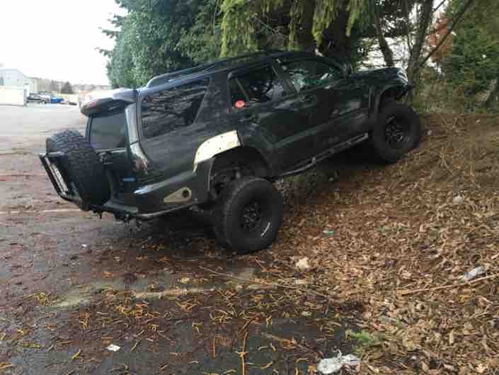

I crunched mine pretty good, so I cut off the tip. Without the slight downward slope, the exhaust melted the plastic on my bumper. Should have cut it farther up like some of you guys.
C'est la vie.
C'est la vie.

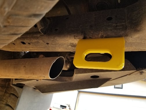

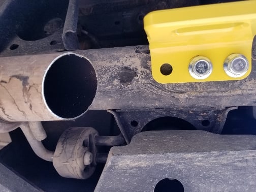

I cut the downturn off to install some recovery points.
Angeled cut just behind the hanger so it is still supported
Sent from my SM-G955U using Tapatalk

Just to update cut at the down turn behind the axle. Zero issues over the last year. Nice and tucked away.
