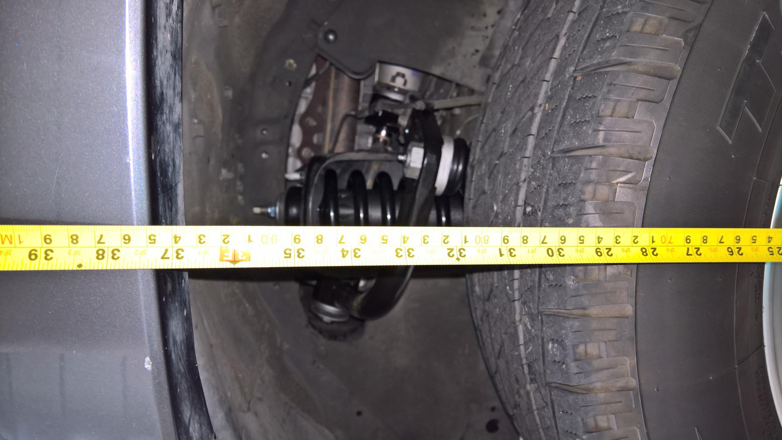

Well to give you an idea this is how I'm sitting. I measured it and I'm at 38 inches from ground to fender. What I have is in my signature. I am running the diff drop kit as well.

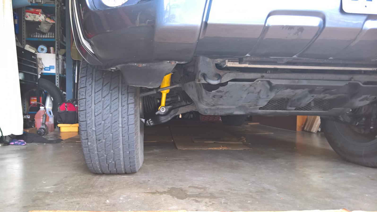

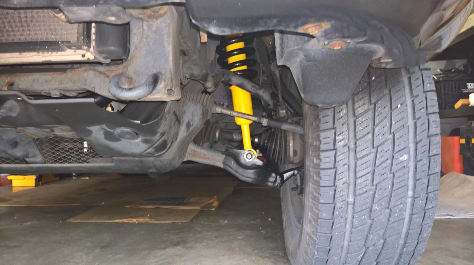

I have CV binding at full turns too. My lift is just over 37" off ground to fender (front) as someone pointed out they had 38" and their's was fine. My lift also looks a bit odd to me; the front is way up high, I hope it will come down once steel bumper goes on (this actually forces me to expedite my decision of getting steel bumper), but currently I almost have no droop. I measured before lift and after, it is 4" gain, I assumed that it is because OEM springs compressed too much over time. :confused:

Update:
After getting new wheels and tires, had alignment professionally done and there is no more binding. What I think was happening is that I pushed the UCAs all the way in to adjust for camber when I did "home alignment" instead of messing with LCA, and that actually gave the truck extra lift and squeezed the axles a bit, just enough to give it a bind. The shop centered the UCAs' adjustment for camber and did the rest of the alignment using LCAs. So happy now, can finally turn freely without worrying of ruining my CVs.
