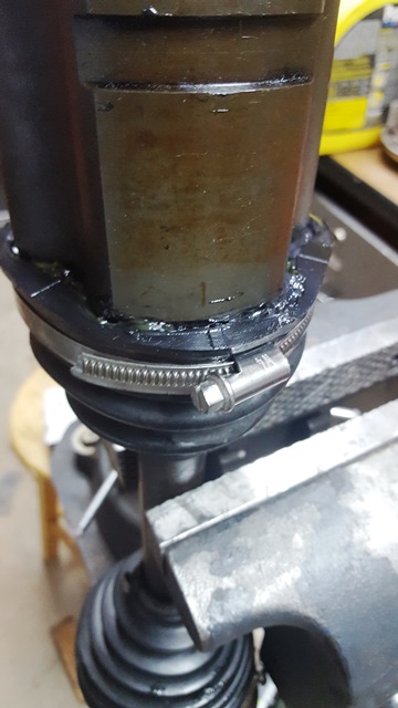

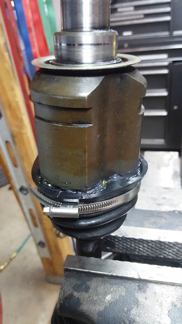

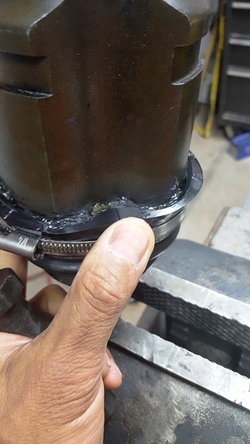

I'm in the same boat and thought I'd share some of my experience so far. I bought the Toyota oem boot kit and re-booted what I think is an aftermarket axle. The issue I"m having is that the inner boot is not sealing well with the stub, not sure what else to should call it.
Please refer to the pics for a better visualization. The CV clamp that came with the kit is actually a great design but that didn't stop the boot from spewage. However, I've tried using the McMastercarr smooth edge clamp but it's not able to do a good job either and ends up sliding away from the home position. As you can tell from the pics, the area under my thumb is the area that neither clamp is able to seal up.
So, I'm contemplating purchasing only an inner boot from O'Reilly auto and maybe give it a go. Otherwise, I might just purchase another axle from Autozone and call it done. Not sure how far down the rabbit hole I want to go now.
Let me know your thoughts please.

That doesn't look like an OEM CV to me.
I would just buy and install NAPA CVs.
