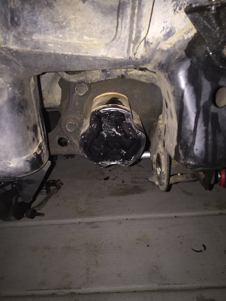

I started to tear my 4Runner apart today to install my cam burg long travel kit and I think I may have missed a few steps to remove the cv axles. I removed the inner cv / boot with the spindle thinking this was the axle. I have the suspension completely removed from the truck.
I started reading and watching videos to see how to remove the axle from the hub and read about the locknut being super tight and then saw that the axle is still in the diff but it’s just the cv housing now.
Did I screw myself? Guess I should have read stuff first
All you did was pull the CV apart at the diff. No big deal other than strapping the boot back on when it's time to put the CV shaft back together. I use a 1/2" impact gun to remove the big nut in the center of the hub. I think it may be 36mm. But don't quote me.
I hope your tear down is not to far down. If you are then you may need a impact wrench to break the 174 ft lb axle nut torque and hope you can hold the outer cv joint from spinning along with the axle nut.
You may have reassemble the cv axle, spindle and disk brake back together and use the brake caliper to hold the axle while you turn the axle nut.
