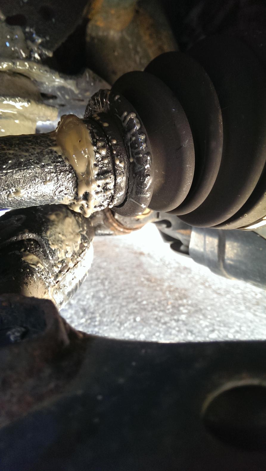

On Sunday morning, I noticed some axle grease spray-off in my front-passenger-side wheel well. After getting down to take a look, there is axle grease everywhere around the passenger-side undercarriage. Upon further inspection.. what do you know, the passenger side inner CV boot (one closest to the engine) is torn right where it clamps to the shaft connecting both boots (excuse my poor description and terminology, I'm not very versed in the correct nomenclature of these parts)! I was surprised because when we had it up on jack stands to do the brake and suspension work the day prior, there was no axle grease anywhere in sight. At first I thought that this might have happened due to the lift and not purchasing/installing a front diff drop kit, but then after doing some research it's a common point of failure for 4Runner CV boots in general. From what I've read, it's my understanding that torn CV boots COULD be the possible result of not having a front diff drop installed, but if that were the case the location of the tear would be different than what I'm experiencing, correct? (I've attached a photo at the bottom of the thread to make up for my less-than-stellar description of the torn area)
I went over and checked the driver side, and it looks like the rubber on that inner boot is "getting there" in the same spot as well, albeit it's just cracking and not completely torn yet. There's small dribblets of axle grease around it, but not nearly as bad as my passenger side where it's spraying all over the place.

(See attached image for a picture of the CV boot tear location)

My .02. I own an 03 V8. It broke the inner boot like yours at around 100k miles. I put another 20k on it and then I changed the boots. I suspect your lift did cause this, but I also am not a believer in the diff drop modification. I wouldn't sweat that. The reality is, these things eat the boots every 100k miles.
Yes the boots were a PITA for me because I'd never done boots before. Always just done the full axle replacement. Your experienced guy will probably have an extra 2-3 hrs worth of labor in it. Worth it IMO. Give him an extra 100 bucks and call it worth the piece of mind. For me, I wanted the most amount of strength out of my axles as I intended to use it off-road and didn't want an aftermarket axle breaking on me. Other issues of balancing and QC issues also had me on edge.
I have OME on my truck as well, BTW. Very pleased with the way the axles (particularly the boots) have performed since I put on the lift. Much straighter than they were before at rest. 140k miles with that V8 really had the front end sagging on factory springs.
BTW, don't think you'll harm your axles. You still have some grease on them, so unless you're driving through a ton of water and or corrosive material, I suspect you'll be fine. I think it was 2 years and quite some miles before I fixed mine.
high mileage, oem boots ripping, especially post lift, is commonly reported on this forum.. so this is no big surprise really.

For the OP that is a common situation to find yourself in after you add a lift. the age of the CV boots paired with the new angles, and well any boot in that situation will tear.
The good news is once you put the new CV axle in the new boots will last a good while before you'll have to replace them again. (you'll probably see a little grease ooz out at first install just from the angle of the shaft and the amount of greased packed during assembly)

I would avoid just replacing the boot. It's a cheap fix but for the time and money you have to invest to just replace the boot you may as well have just put in a new cv axle.

Since it seems like I'm okay to drive on these torn boots for a while, I'm just going to have everything else I already purchased installed and drive it as is for now. Going to give CVJ a call and see what they can do for me. Checked out their website and a few google testimonials; seems like they are the best "do it right the first time" option besides paying $800+ for OEM replacements. If it's $300-400 for both axles and they're going to be built to last, I don't mind at all.

If you want to stop the grease from oozing out in the meantime, cut the factory clamps off and put some narrow hose clamps in their place.
