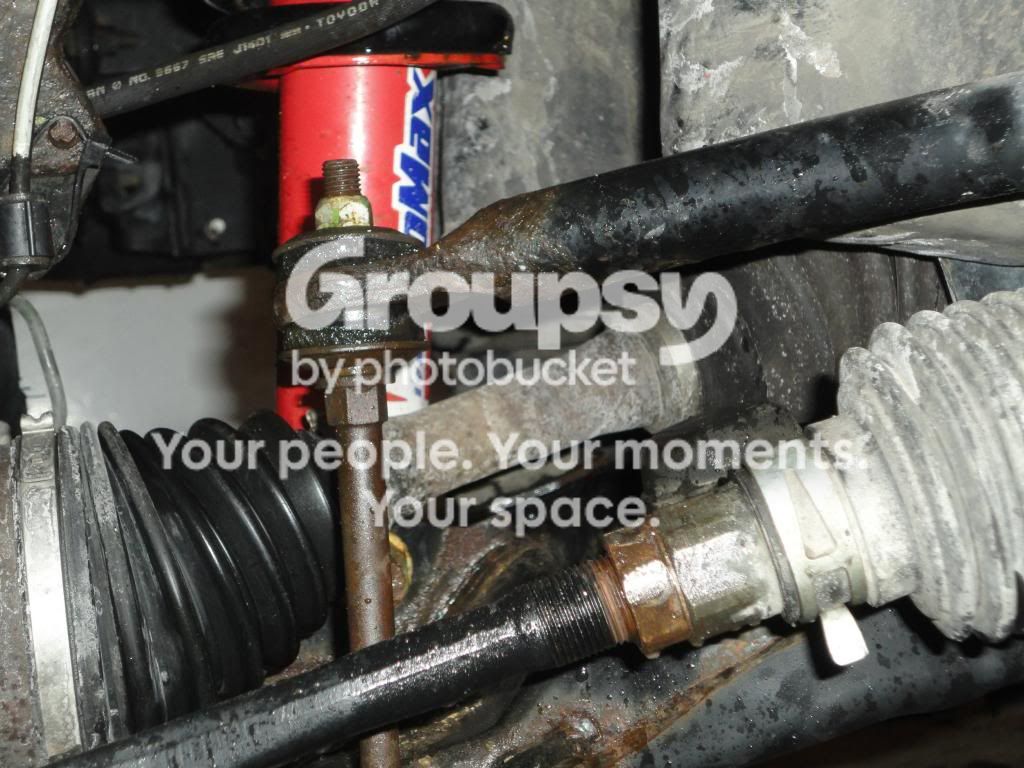

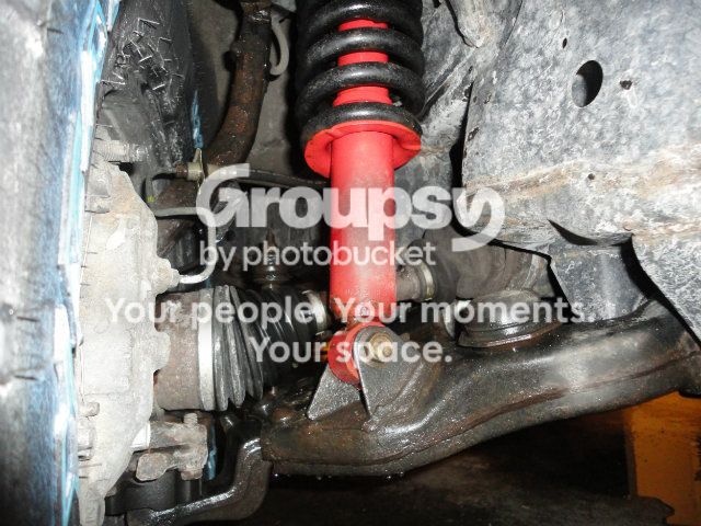

Hey guys, didn't want to start another cv angle thread so... yeah I'm happy as hell about my lift but then i took a look at my cv's and now i'm kinda worried. Does this look pretty bad?
behind the driver side
liftylifty003_zpsd5a49986.jpg~original
Front Pass side
liftylifty006_zpsf8390442.jpg~original
I have a diff drop installed and everything. there is a 1.5 top plate spacers with a 1/2 poly spacer on top of that. Please say I'm ok lol
I'm gonna order coilovers most likely in the summer. but this has got to get me by for a few more months. Thanks!
your boots are going to explode and spray grease just like everyone else who has put on a lift, check out the cv boot fixs and mods
how long have yours been that way? did they hold up during all those miles on your recent trips exploring the northern states?
Mine have been like that for almost a year now. Never had my boots rip or fling grease at all, nor did my old CV's that broke on the trail. Maybe I was one of the lucky ones. They held up great on the trip and all the wheeling in Moab, the front wheel bearings not so much...

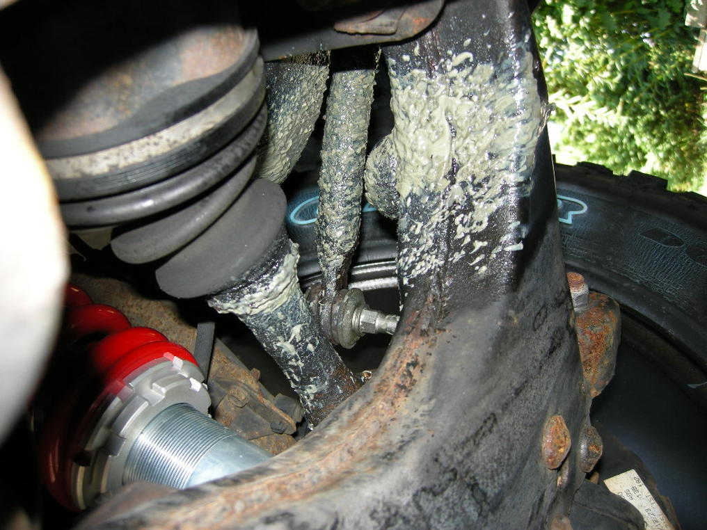

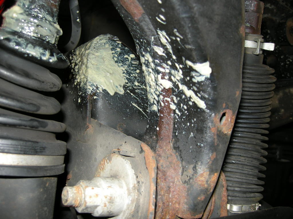

mine after my lift... not for the squemish warning..
did not know about dropping/lowering anything... i did a lot of reasearch before i had the lift done but not enough.. all better now.. lesson learned
best of luck
