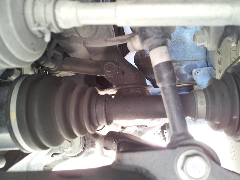

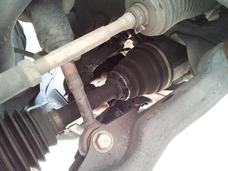

Folks, my passenger side cv boot is torn and driver side is about to leak.
complete cv boot kit from stealership is about $109 and about $250 labor from the shop I use. I figured, i might as well replace the whole thing with after market cv axles which might run me about the same as cv boot kit from stealership.
I read on other post folks have got cv axles from RockAuto Auto Parts, what u guys think, should i pull the plug on after market cv axles or keep original and just change the boots. what is the part # for rockauto cv axls (complete both sides)?
Thanks in advance folks

ETA : The second pic, looks like the band is missing completely. Unless it is torn as well, you should be able to just replace the band on that one.
I intend to change the diff oil on both diffs when I change the cv's. Labor cost is not that much different, should i replace both cv's or just replace the missing clamp on driver side even though grease is starting to come out?
I just did mine and used Cardone Select part number 665235. It shows the same number for your year. It's the same part at both sides, so you need 2. Bought mine on RockAuto. No core with the Cardone part.
