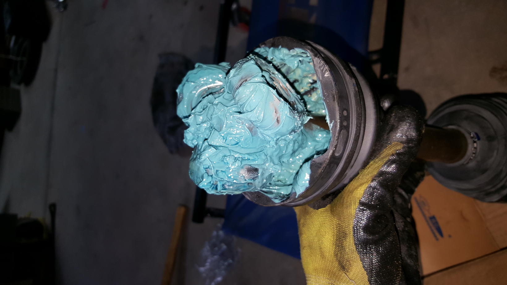

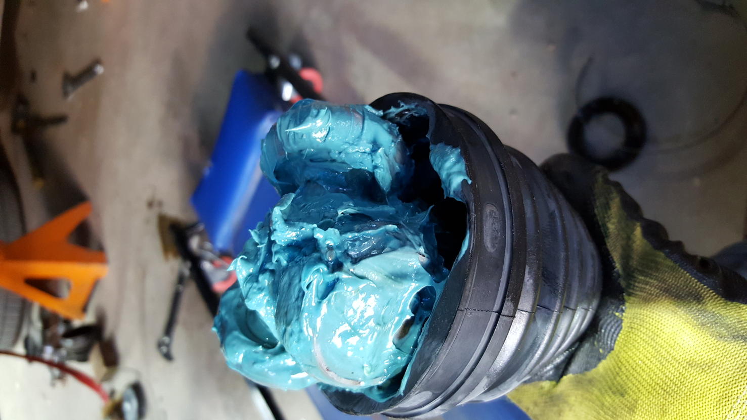

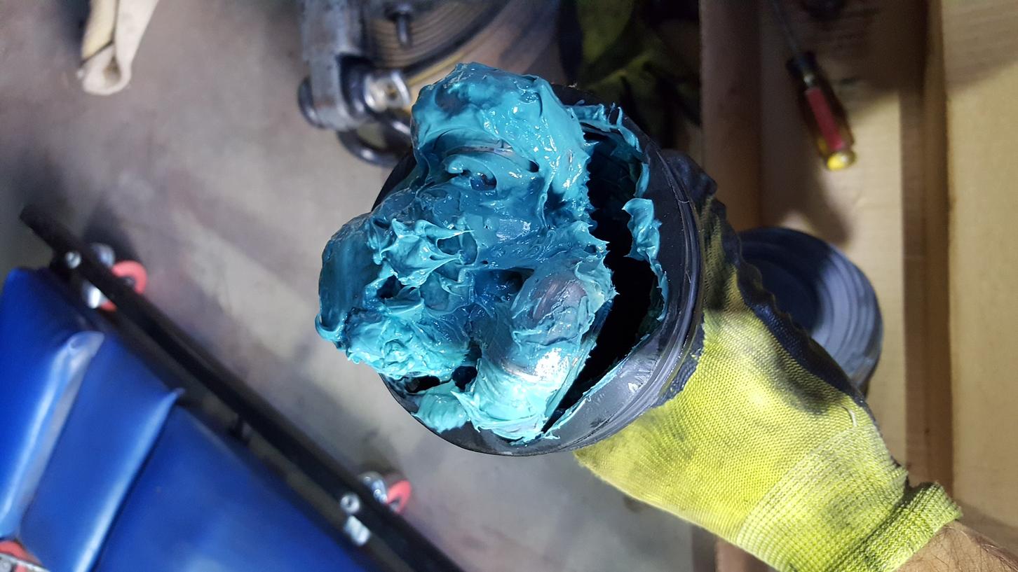

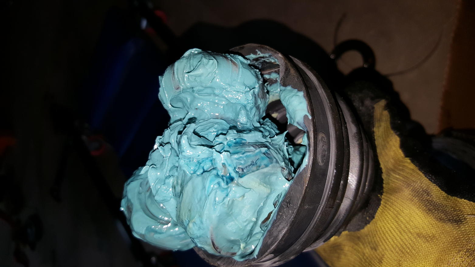

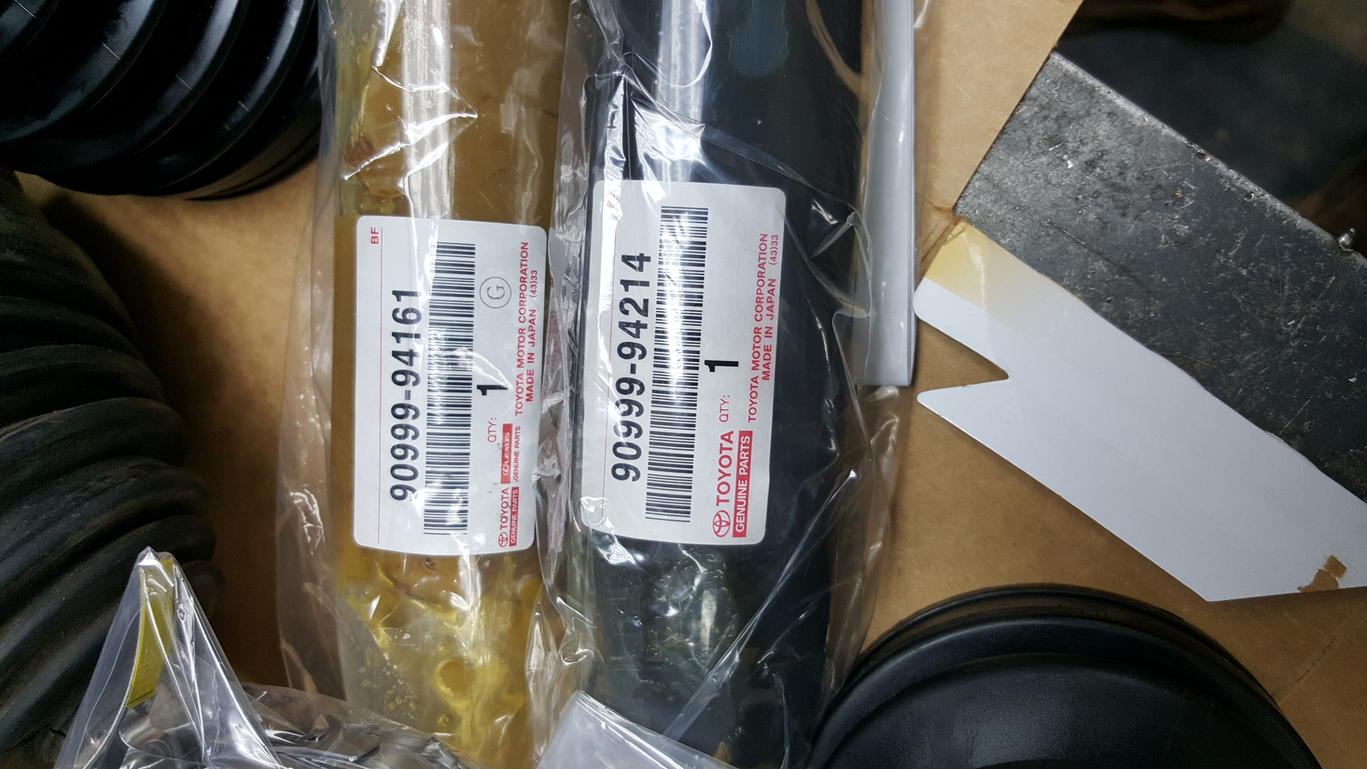

Just for S&G, I took apart a brand new Autozone CV axle and found out that they use a mint color grease!
Random pics below:

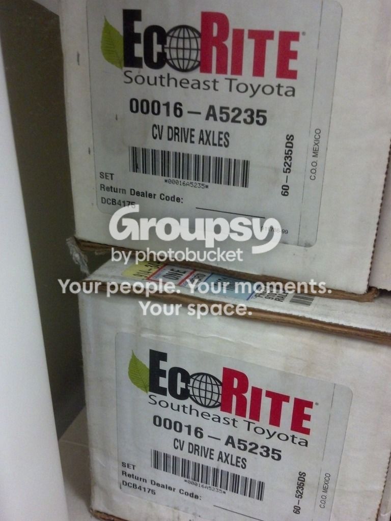

I replaced mine with OEM remann'd from the dealer. They were about $300 for both. There was a $50 core refund on each but I decided to keep my originals to re-boot (still haven't had time to get the parts and do it, we moved recently). Anyway, only one inner boot had torn, so I swapped both and I had caught the tear in a day and had them changed within a week, so I know the joint didn't get messed up.
If you decide to go this route, see if your local dealer has online parts sales. Mine did and that price was lower than what was quoted at the desk. Since then I have received discounted pricing at the parts counter. Don't know if it's just because I'm a regular, or if my online order triggered something that pricing. Another option is look into Village Toyota (in Northern Fl, I think), they have good online prices. EX: I had to get rear brake anti-rattle shims and my local dealer could only get them for me for somewhere near $40, but Village Toyota had them for ~$17 ea. and total shipping of around $11.
Let me know if you need the part number for the OEM reman CV axles. I still have the boxes....

I am interested in the Part # for the OEM Reman axles. Thanks
