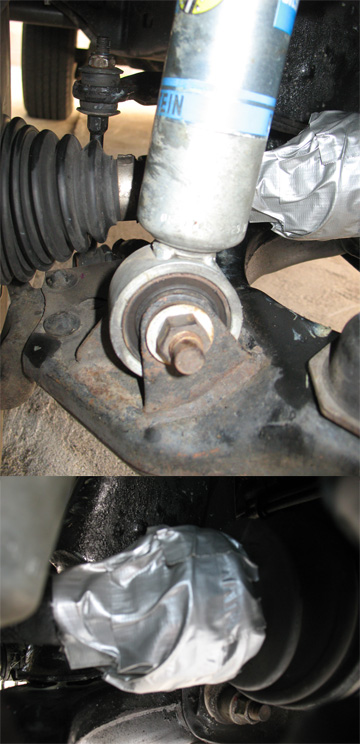

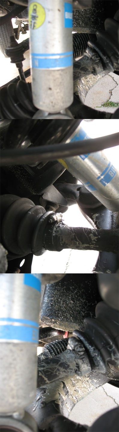

While I was rotating the tires today, I saw the passenger side cv boot has a tear in it with grease everywhere. I cleaned up what I could and did a little duck tape fix for a temporary solution so dirt won't get in there and mess up more stuff.

I'd just replace the boots. The OE parts are less than $75 for both axles and pretty easy to do. You will need a cv band clamp tool for the clamp on the right side of the picture.
