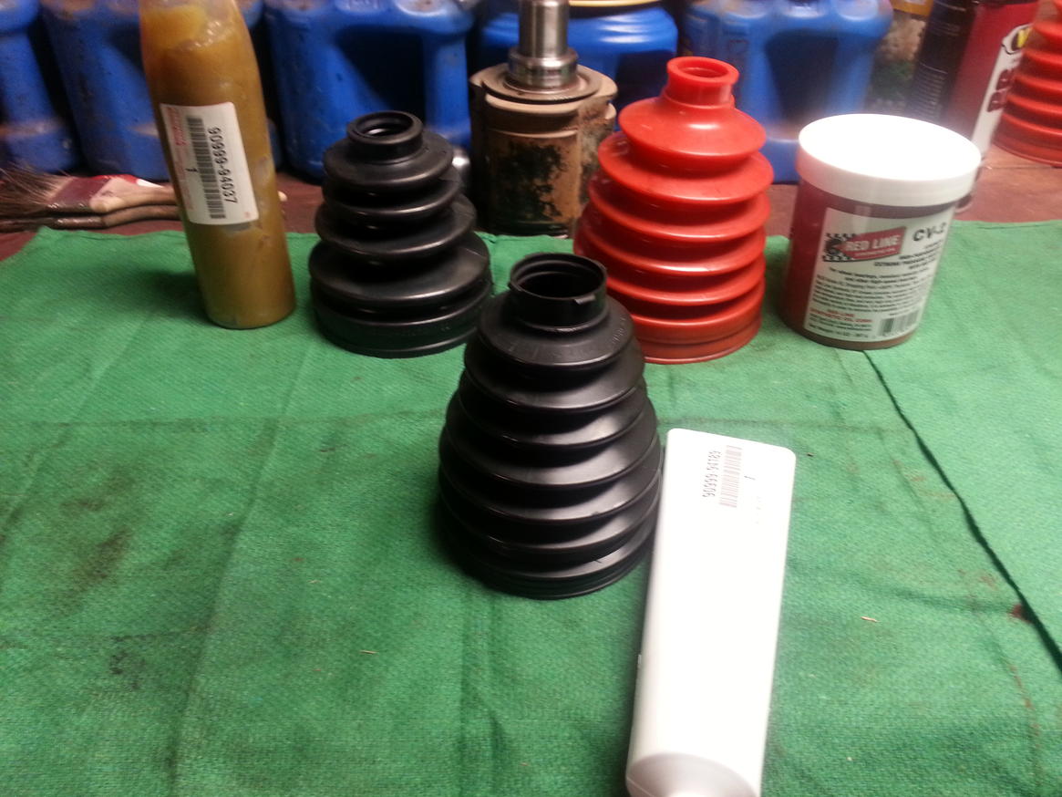

I know there are alot of threads about this and I have looked at most of them. Alot of them are old and I want to know who did what and how long it held up. I am getting ready to reboot mine again, last year I rebooted with ORS on the inner and Auto Zone stock replacement outers, well go figure 1 of thet Auto Zone ones tore already. So right know I have some options and am seeking info from the experiened, you guys.I have Toyota replacement kits inner and outers and I have ORS inners, I also have Allpro outers and there is now way in H_ll will they fit the outers (way to big). Factory grease and some Redline CV 2 grease. My question is what would you do with all these option and what has lasted the longest. Im running a Toytec 3" with diff drop. 20140411_190838.jpg

Thank you all for your input. The allpro, s are way to big, and even if I could close the gap I would be worried about tthem rubbing the rivets on the LCA. they look like they would work well on the inside.
As far as the boot slide goes what boots would you us, OEM, or ORS?. And your thoughts on the synthetic grease.
I looked at their boots and it looks like an allpro is the same? I am going to go with OEM outer, the inners is were I am looking for best options.

OEM or Beck Arnley.
