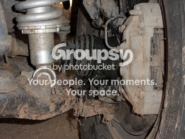

here is the damage:
SDC10309.jpg~original

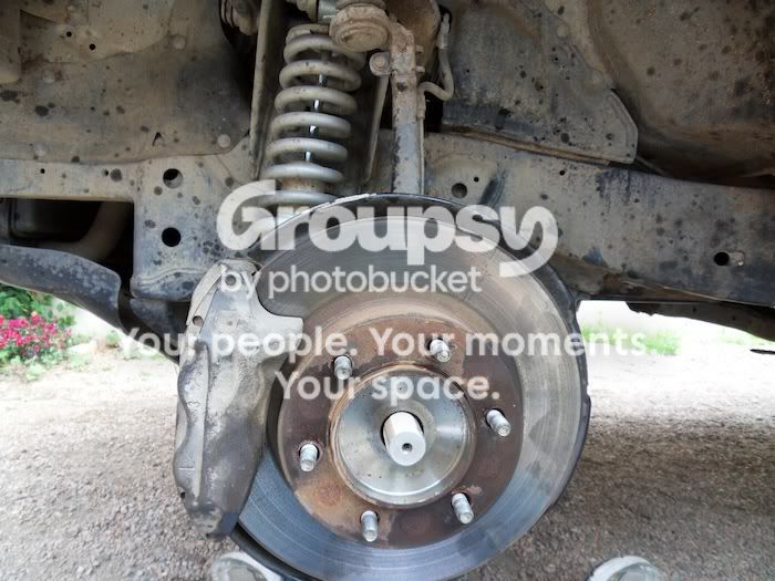

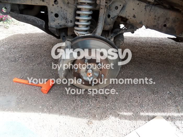

after I got the hub nut off
SDC10312.jpg~original

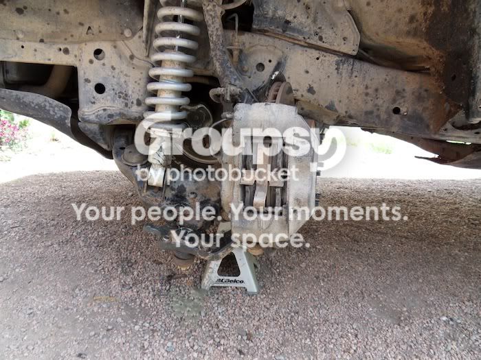

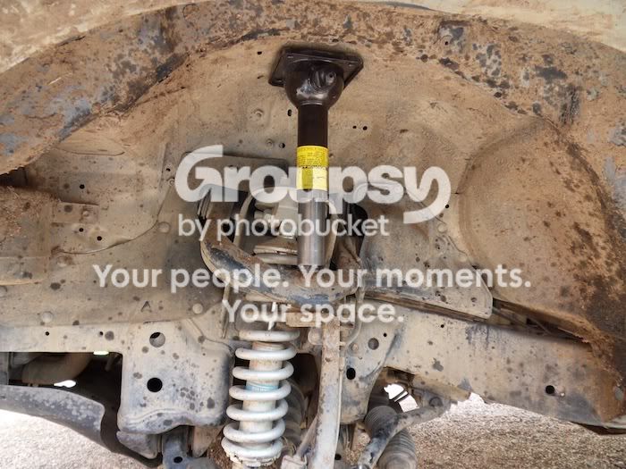

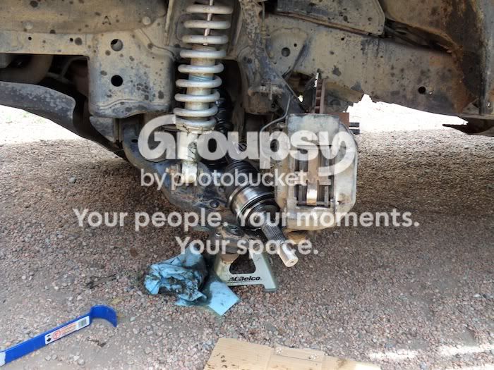

used the jack to flex the upper arm down
SDC10313.jpg~original

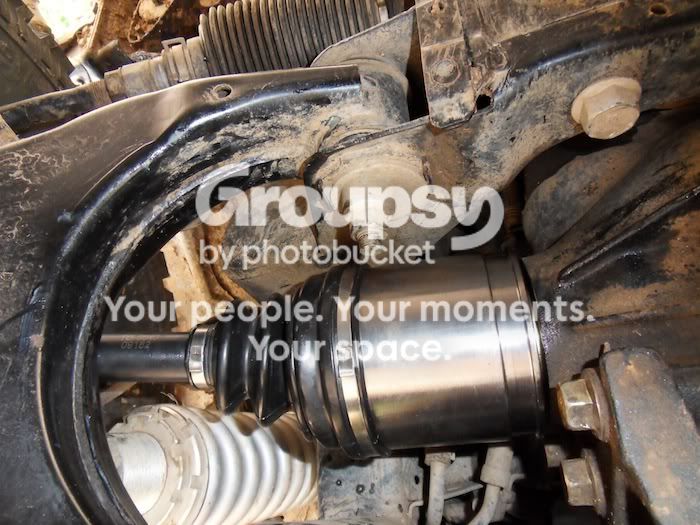

after pulling the CV out, the inner boot slipped off and separated
SDC10315.jpg~original

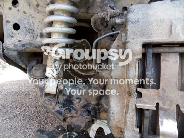

SDC10317.jpg~original
new one halfway in
SDC10318.jpg~original
spline seated
