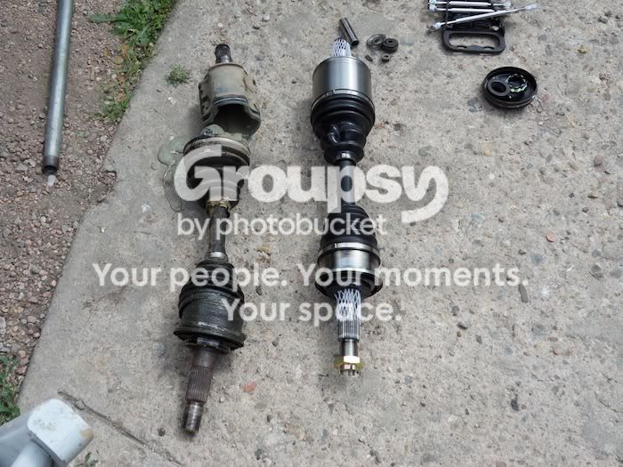

old and new
SDC10317.jpg~original
The picture above shows some of the differences between OE and aftermarket.
The old (on the left) is probably an OE. It has the three lobes on the inner joint and the axle shaft has a taper in the middle.
Aftermarket inners (on the right) are usually (maybe always) are round and the axle shaft is straight.
