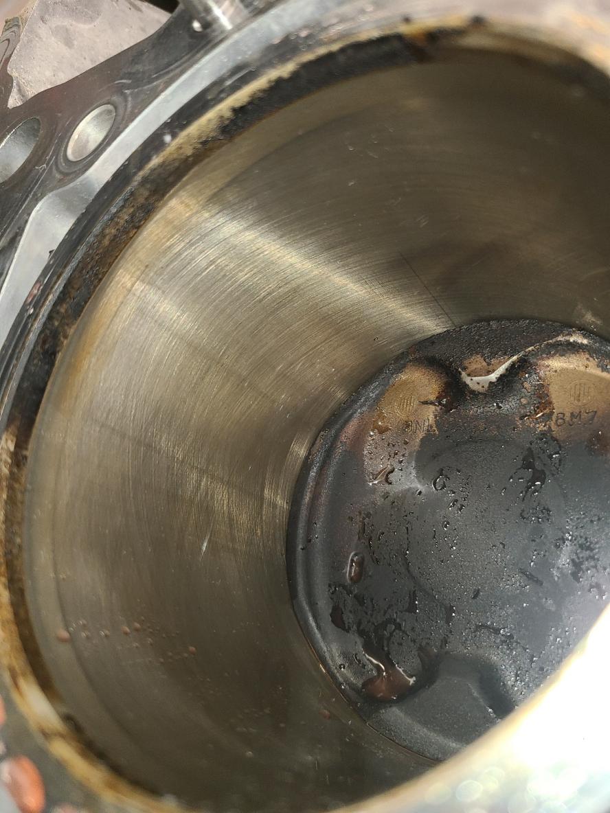

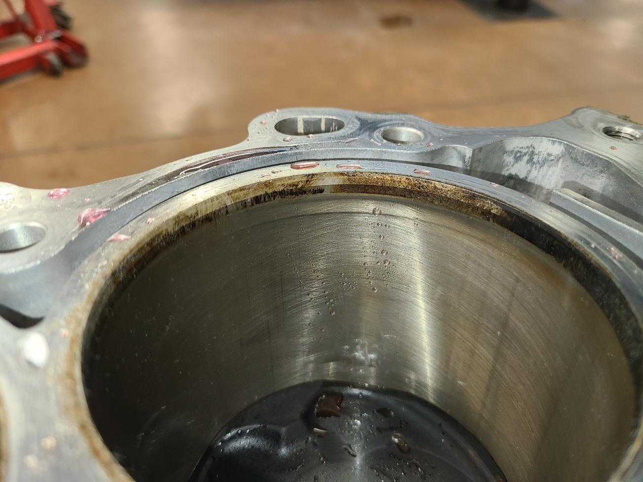

So I'm tearing down a '19 4runner with about 31k on it to swap out the short block due to an oil galley leak. I got it all torn down ready to swap out and snapped a few pictures for you.
This engine has the same marks and "shadows" along the cylinder walls. You can't feel them with a fingernail or fine tipped pick they look more like burnish marks you'd see when someone superficially scuffs a polished stainless steel plate. My best guess is that they're burnish marks from when the engine originally "seated in/wore in" from minor variances in the roundness of the pistons, rings, and cylinder that are totally within acceptable factory tolerances.
You are the best!!!! Thank you very much! I’m sure this topic has peaked some interest on here. I just hope you are 100% right. Keep the pictures coming, I’m interested to see how common this is.
you did the oil changes great and then you looked in to the cylinder well,,,,, I was repairing engines and the bores use a tool to buff it ..your picture works great ...
so you did not loose engine oil ...your engine is very good around 100K miles ..

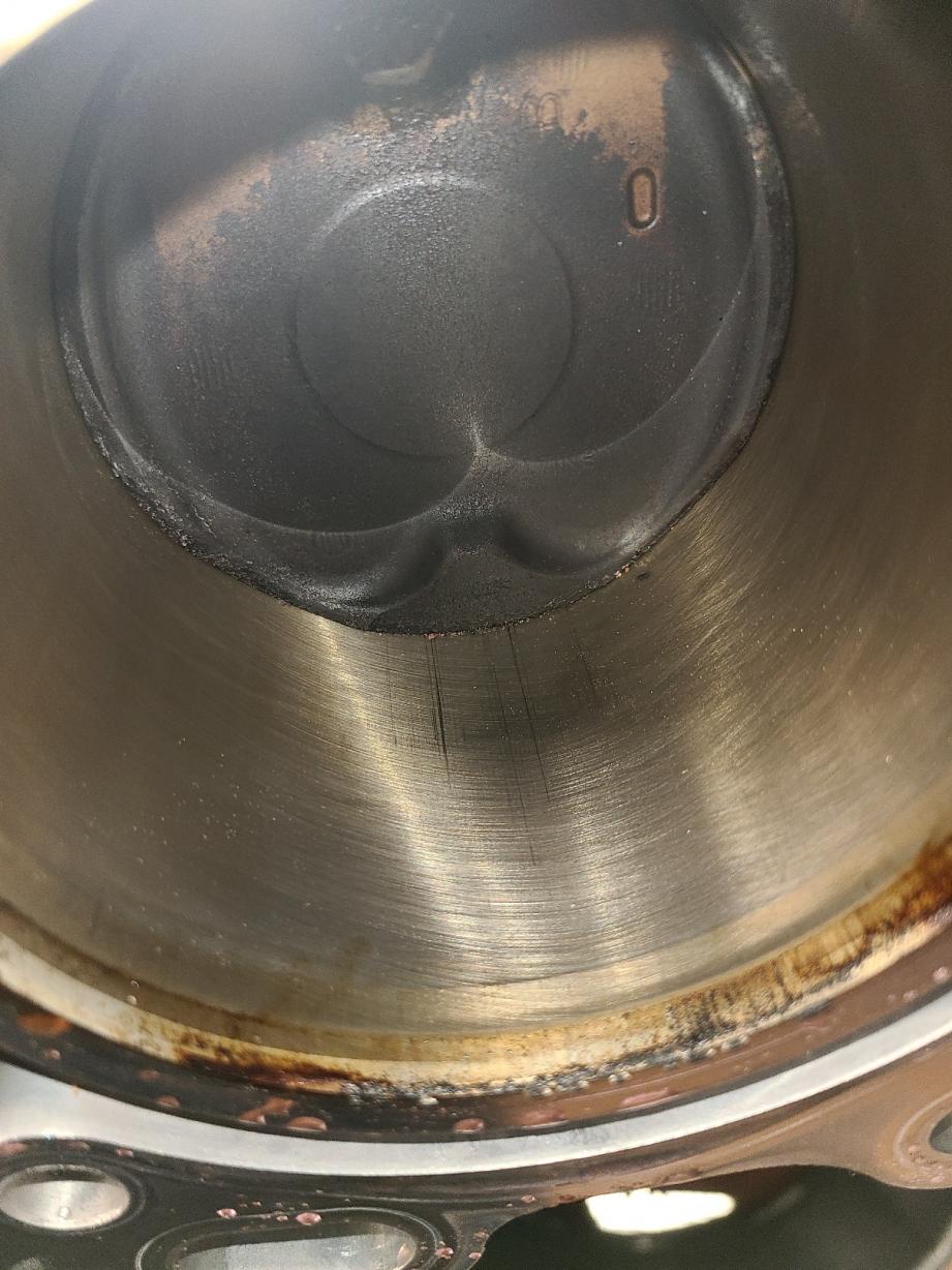

I checked my 20 with 48k miles....what I found was quite shocking....I did some research and figure as long as I don't feed it after midnight or install a water injection system on the truck, I should be ok.
Hahaha, mine was definitely fed after 12! Did you notice any oil in your intake manifold? I have way more then I would like. Definitely need a catch can installed soon.
