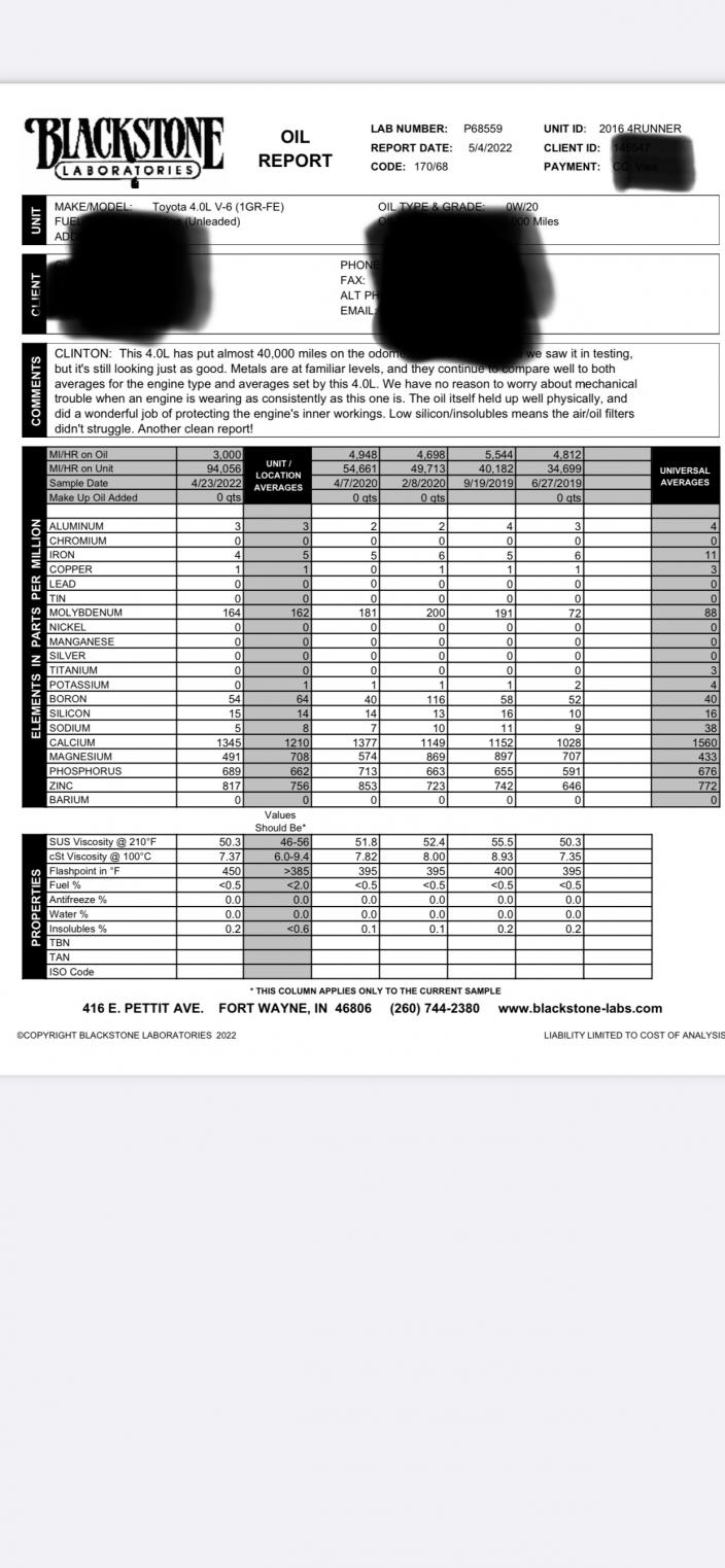

I just received my oil analysis back from blackstone labs and it appears that I don’t have anything to worry about. See report below.
