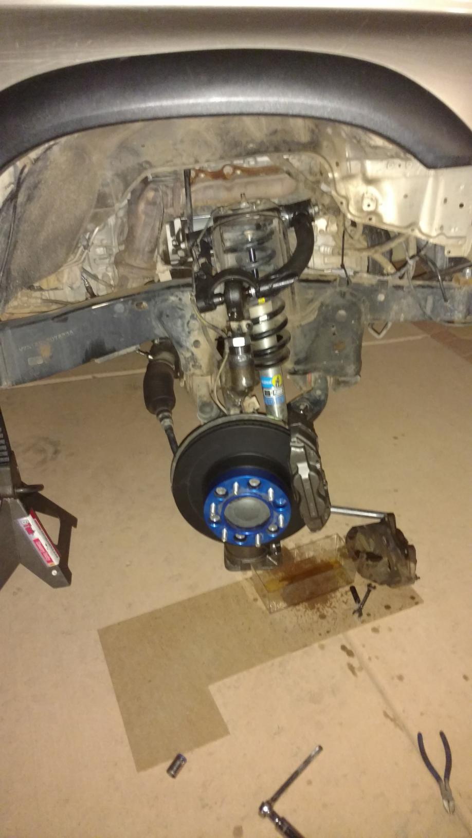

Also I took the liberty of making this gif tonight when I moved the front end down a couple of perches and installed new rubber isolators. I removed the spring and used only the shock. I measured 11.25" of travel with room to spare for a larger tire if I wanted to haha.

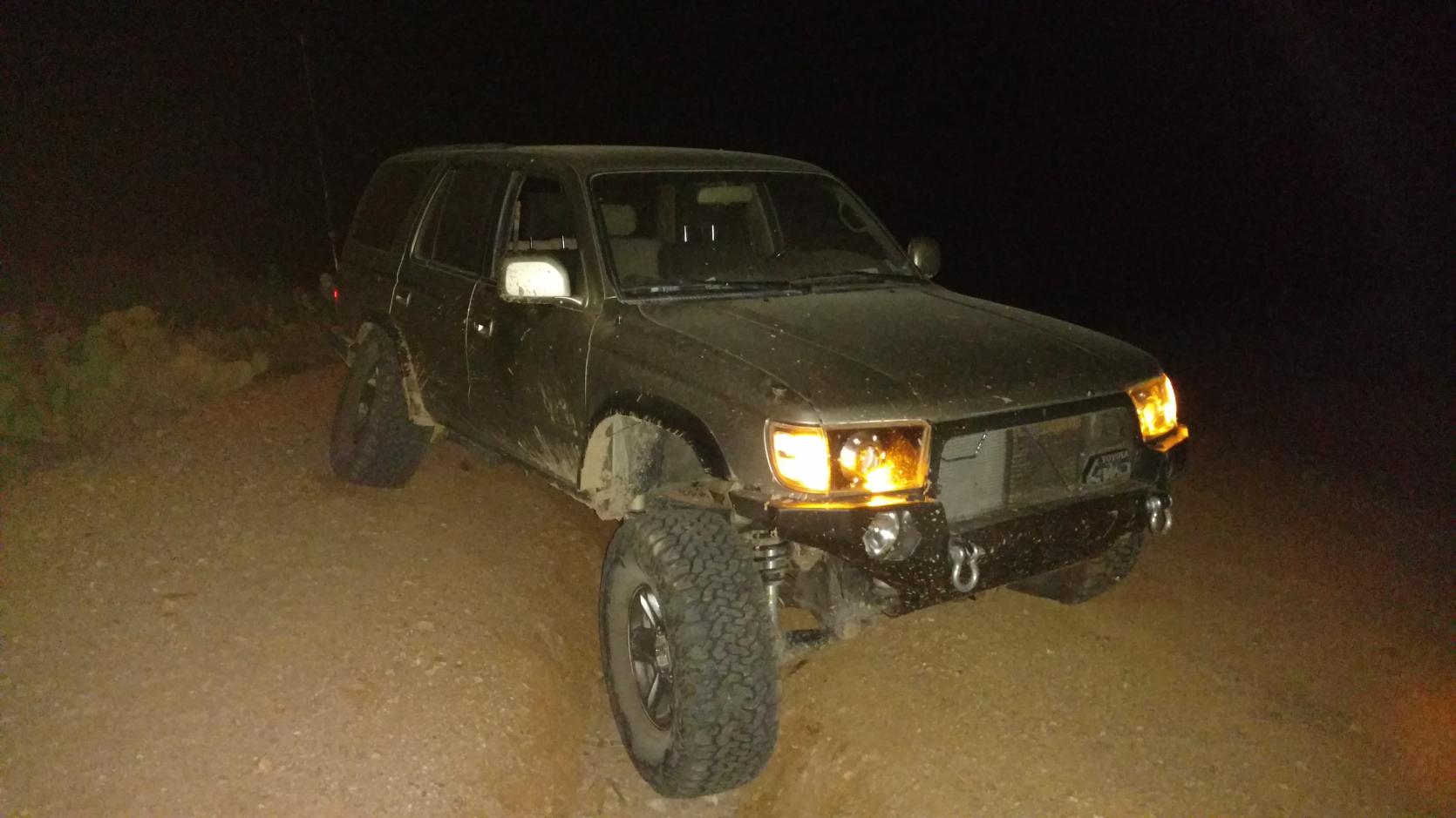

Front bumper basically done, and grill complete

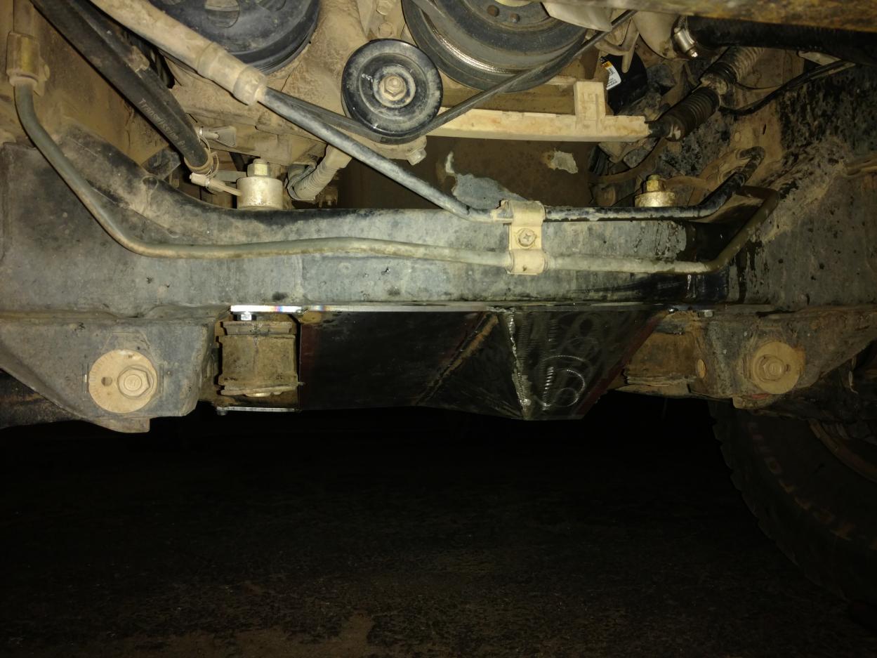

made a low profile diff skid plate.

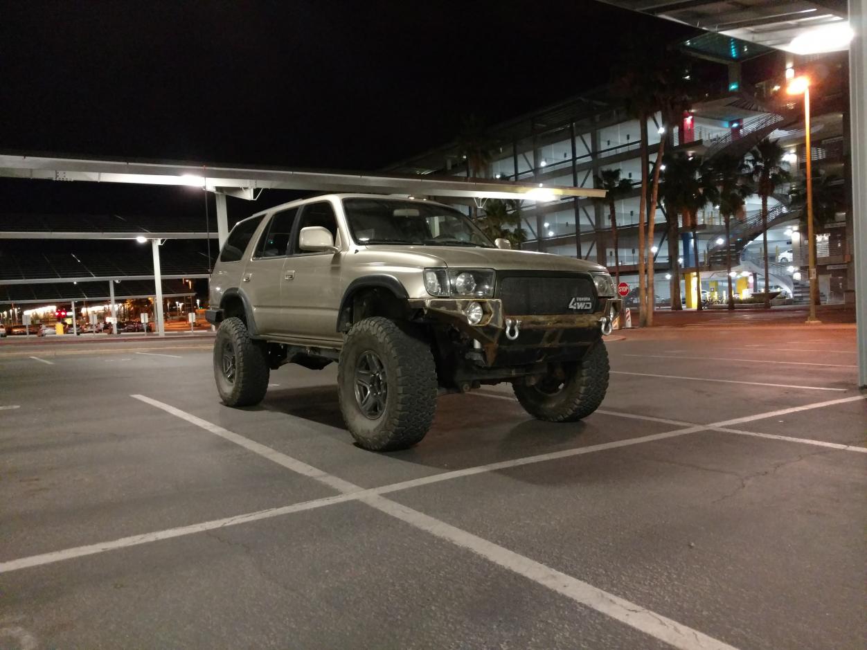

finally looking really clean

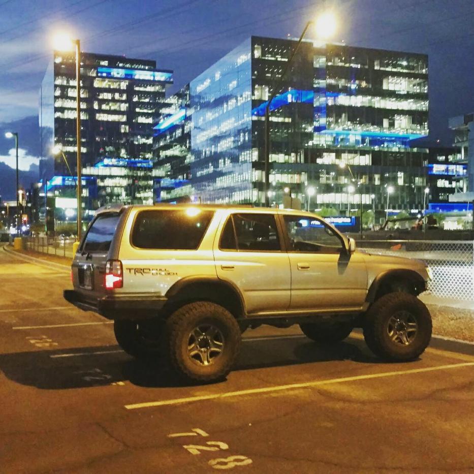

best spot in tempe to take car photos

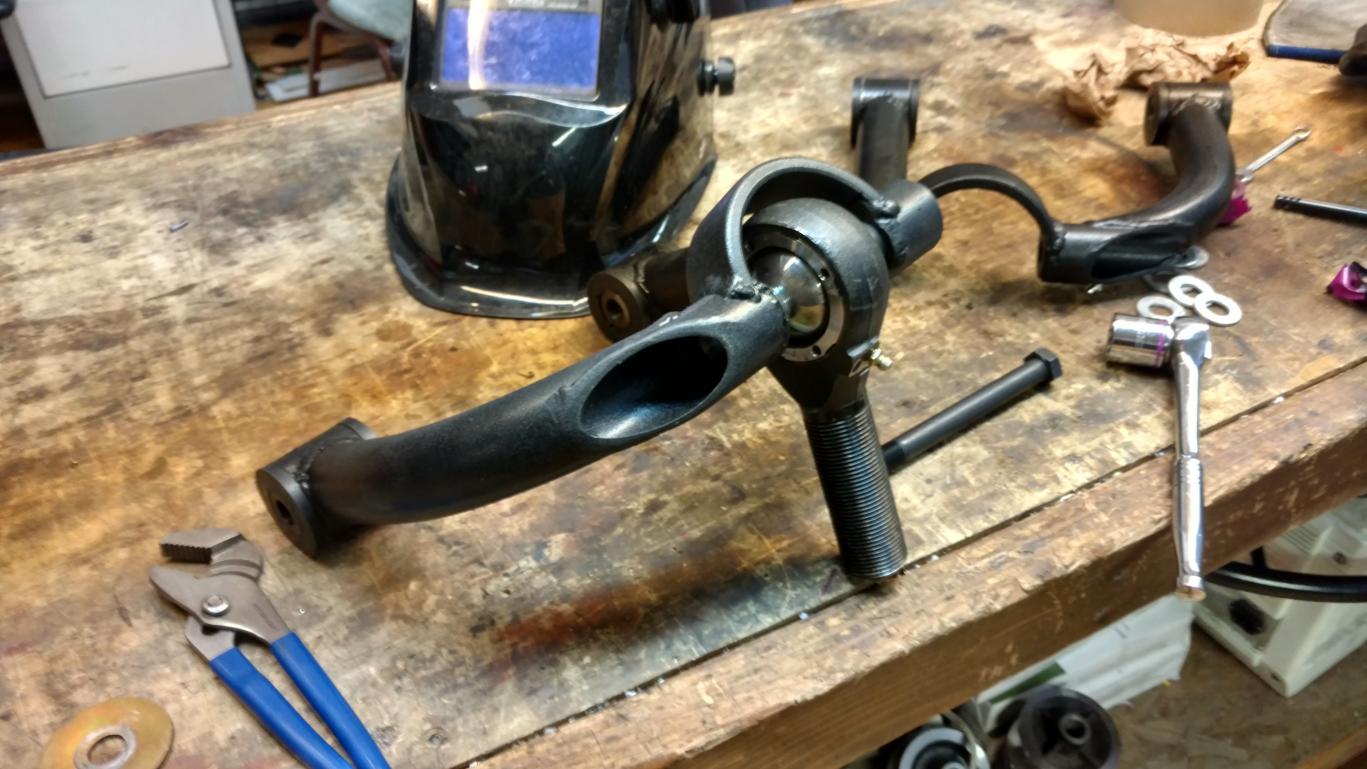

Made the ultimate stock length upper control arms with ballistic rod ends and unlimited up and down travel.

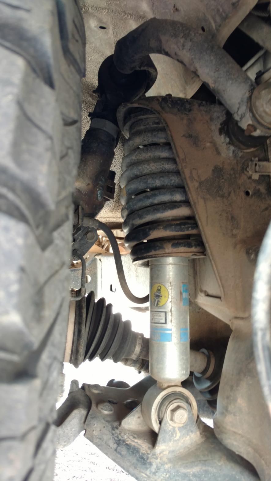

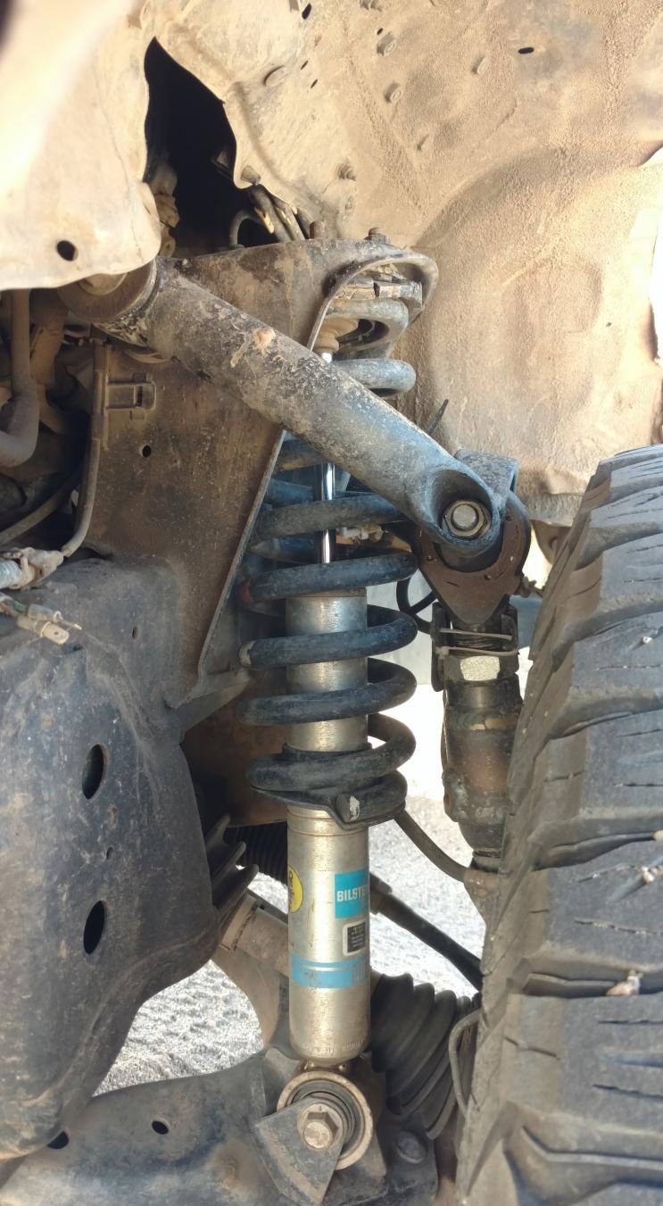

tundra brake upgrade, and a better look at my uppers and spindle.

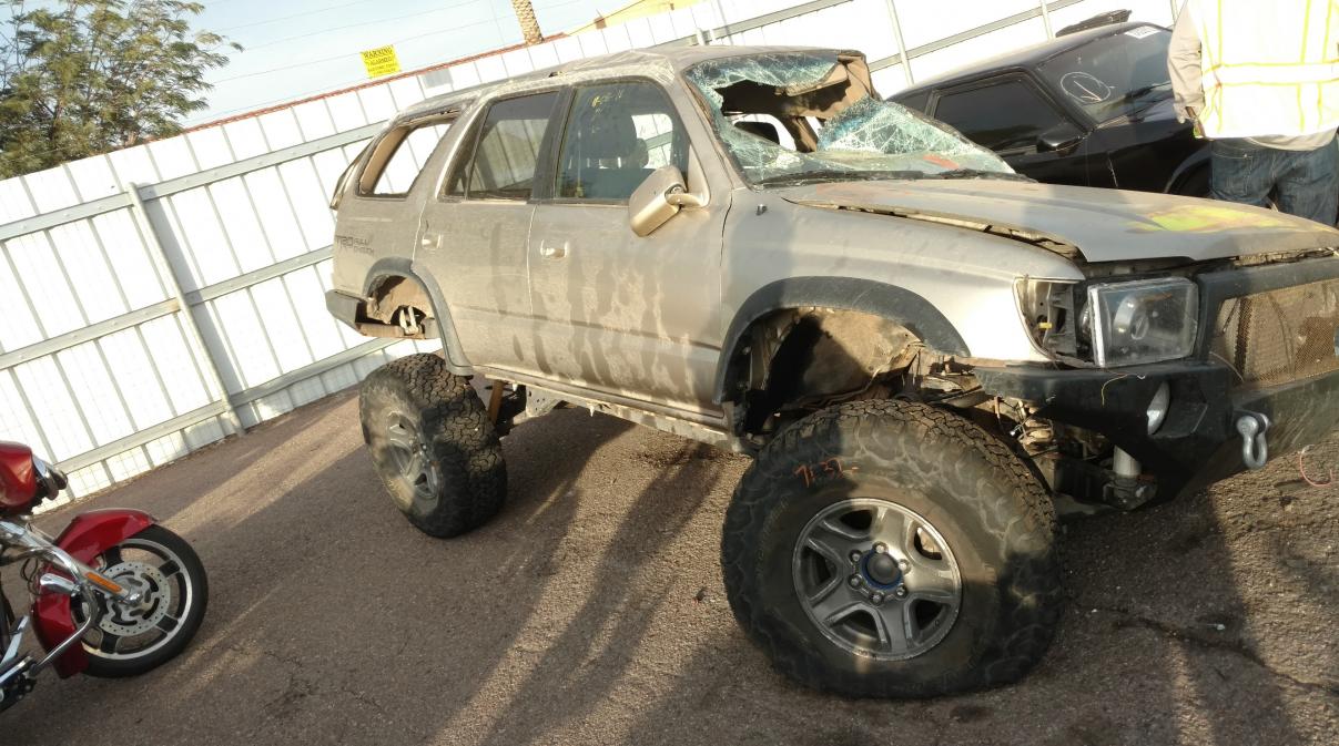

next day, just driving to work and some dude lost control of his car, hit my side at a 45 degree angle. truck turned, then rolled, the windows broke on my side, hand flew out the window, half my hand gone etc.
looking at the truck at co part. my suspension parts all survived, but the stock things broke. rack exploded, lower ball joint bolts sheared and the arm coming off the lower ball joint broke. lower ball joints were actually fine. my panhard axle mount extension broke.
