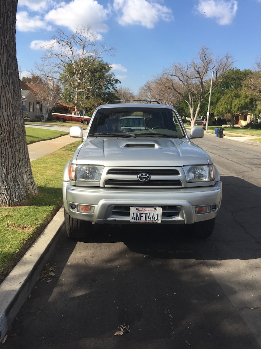

So the DMW doesn't do registrations on the weekend so I spent the weekend on the wheels, removing the wood trim and removing the running boards. Here's a pic back at the DMV on Monday Morning. I like it a lot better without the boards on it. I might do a small nerf or skid plate though. What do you think?

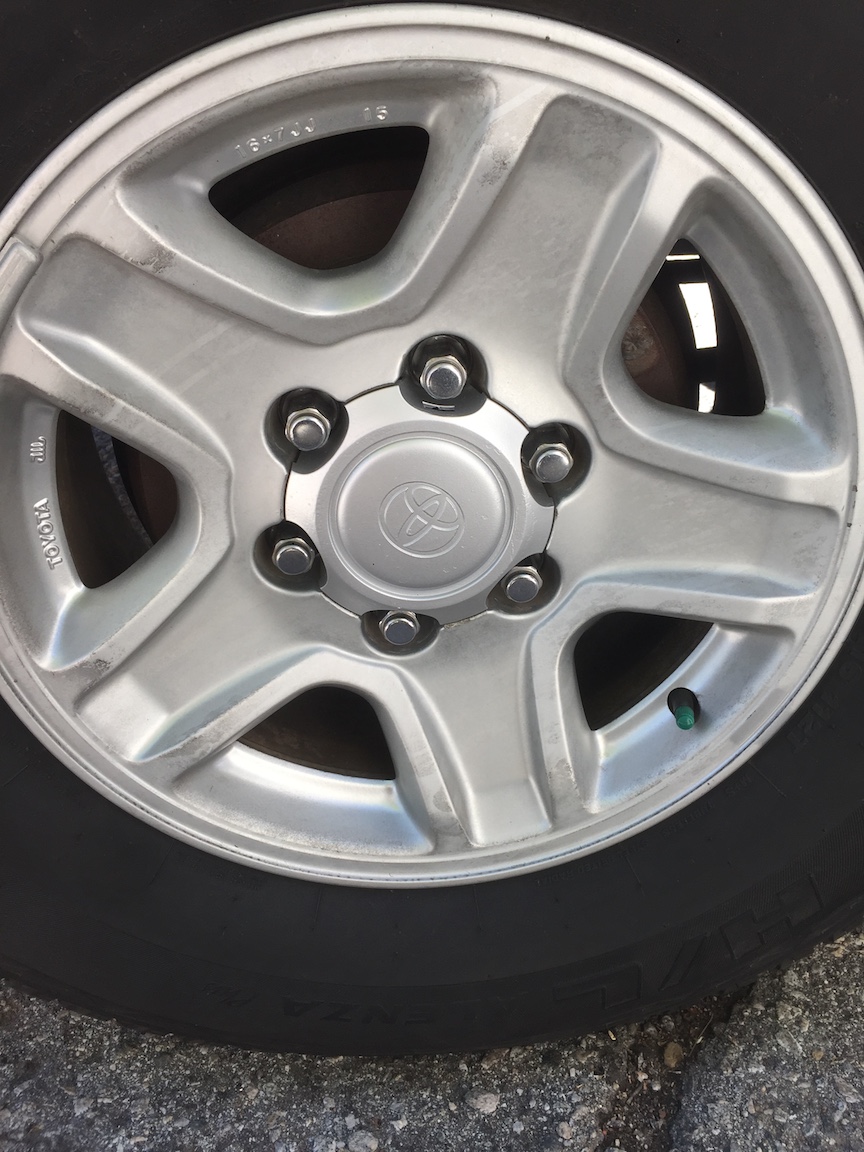

Clean. I also picked up a 2000 SR5 5-Spd Highlander. what process did you make to clean the center caps. I have the peel as well.

really easy. just take them off, and clean them first with a de-greaser, then soap and water. I primed them with two coats and then put 3 coats of aluminum rustoleum paint. I was going to sand but figured it's not a show truck and I'll probably have to repaint in a few years anyway. Easy job.

Well sanding has a purpose. Paint sticks to the surface not just because it's clean, but through either a chemical or mechanical bond. The fine scratches put in by the sandpaper give the paint something to bite on to. Like Spiderman climbing a skyscraper. Some paints have an etching device built in which helps form a chemical bond. Generally sanding is a better way to go, not just to smooth the surface, but for long lasting adhesion.

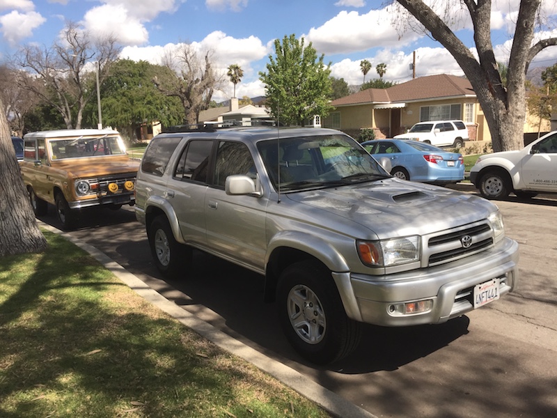

That thing looks as clean as they come! My Minnesotan rig and I are super jealous. Stoked to see where you go with the build-- is it a daily driver?
Thanks! I searched forever for it. It's a daily driver, actually replacing the role previously played by the bronco behind it. I'm not going to go crazy on it, but it's going to be more a "rig" than a "truck" I love what everyone is doing with theirs and I want to take many of the mods and custom things others do and apply it to mine. I really love these 3rd gens! I also love early broncos too.
