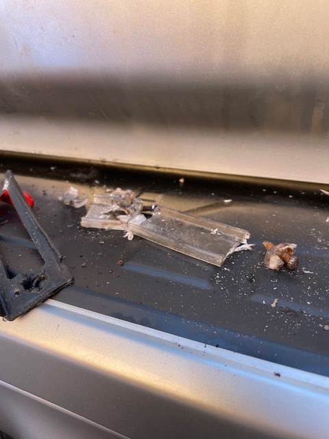

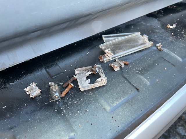

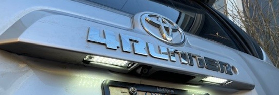

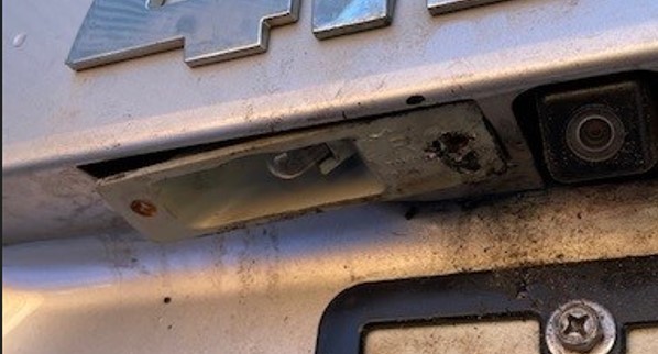

Frustrated but fixed - license plate light screws - 5th Gen 4runner
keep in mind I am not the most mechanically inclined but I really wanted to fix this without going to the dealer. Based on my web searches/experiences - this might help someone.
1. I tried the 'spray with rust lubricant over multiple days' - NO LUCK
2. I tried (bought a dremel) the cut a slot for a flat screwdriver (and I mucked up the screw heads) - NO LUCK
3. I tried the 'drill it out' method even bought a new drill bit - these are from what I read 'iron screws' - I was not able to get them to drill out - NO LUCK
4. I tried the heat the screw up (and I mucked up the lens during this process) - NO LUCK
5. I ended up cutting the plastic lens out and was able to get a vice grip type wrench on the screws and they came out.
I replaced the lens with LED lens that plug into the light bulb slots.
I used #8 stainless screw self tapping screws
Keep in mind
- the screws 'tap' into plastic NOT a metal clip
- the plastic 'tabs' on the rear garnish that you screw the lens into isnt 'strong' the 'outside' screws plastic receiving ends are the weaker of the 2 points of contact
- careful dremeling as I ended up with a big of collateral damage due to lack of dremel skill and lack of patience
Hope someone finds this useful
