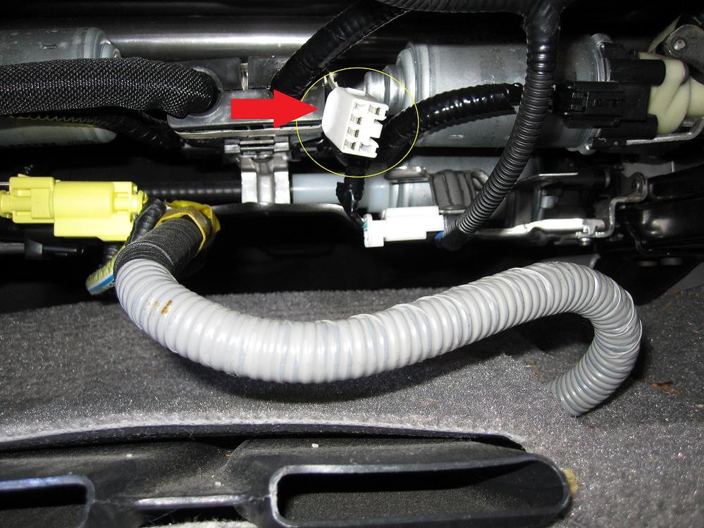

However, when I was looking under my seat I noticed a white electrical harness that isn't connected to anything. I suspect that this must have happened when the dealer last worked on my seat. All of the power functions seem to be working fine so I am guessing this may have something to do with the airbag. Does anyone know what this is for?
yellow plug is your air bag. if you dont see where the other end of that plug goes to, it might not be used. if anything, take it back
