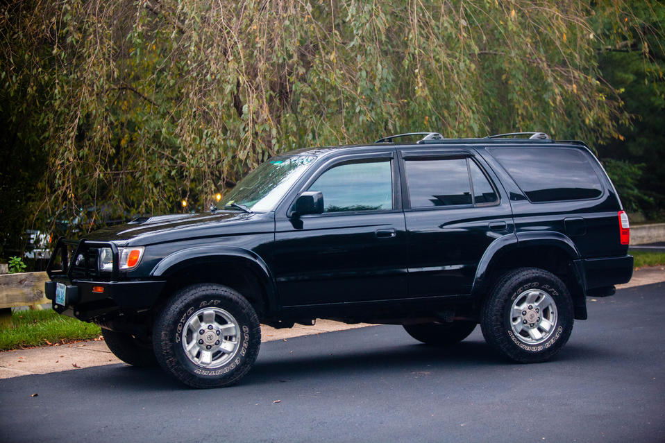

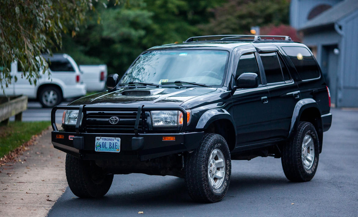

Friend and I installed the 2in Bilstein/Tundra/OME lift this past week along with the ARB front bumper:
  • Tundra TRD Front Coils P/N 48131-AF100 Yellow/Yellow and 48131-AF090 Yellow/Blue - Camelback Toyota
  • Tundra Front Coil Isolator MONROE P/N 907926 - Amazon
  • Old Man Emu 906 Rear Springs - Amazon
  • Bilstein 5100 Front Shocks P/N 24-261425 (From a TRD Tundra) - Amazon
  • Bilstein 5100 Rear Shocks P/N 24-100144 (From a TRD Tundra and sourced from Wheeler's OffRoad with the 4runner bushings pre-pressed)
Net of around 2 inches all around. Very tasteful, while practical. CV angle is still acceptable and no panhard modifications were done. Only issue is I now notice a clunk in the front that wasn't there before...I think it is the steering rack bushings going out, but not sure. Still trying to figure it out. Ride and handling is not affected, just annoying.
ARB front bumper installed the same day. Looks fantastic, though the install sucks since it is technically for the taco. Only thing I couldn't figure out was how to mount the license plate. Regardless, the look is timeless and I've already gotten compliments. Highly recommend.

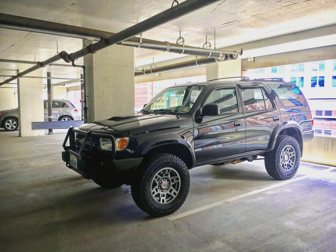

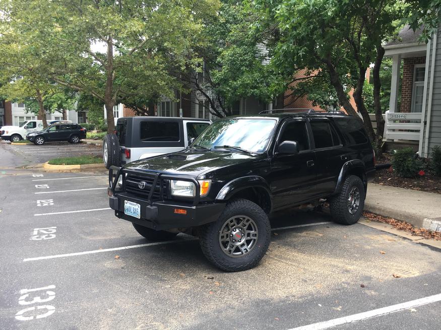

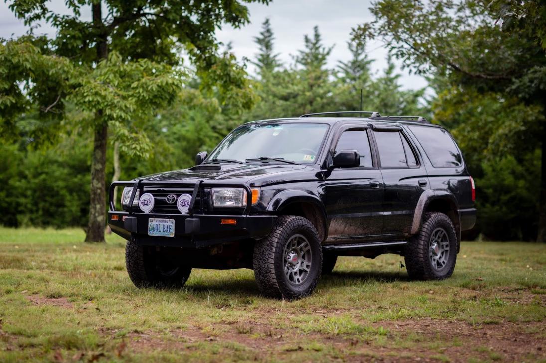

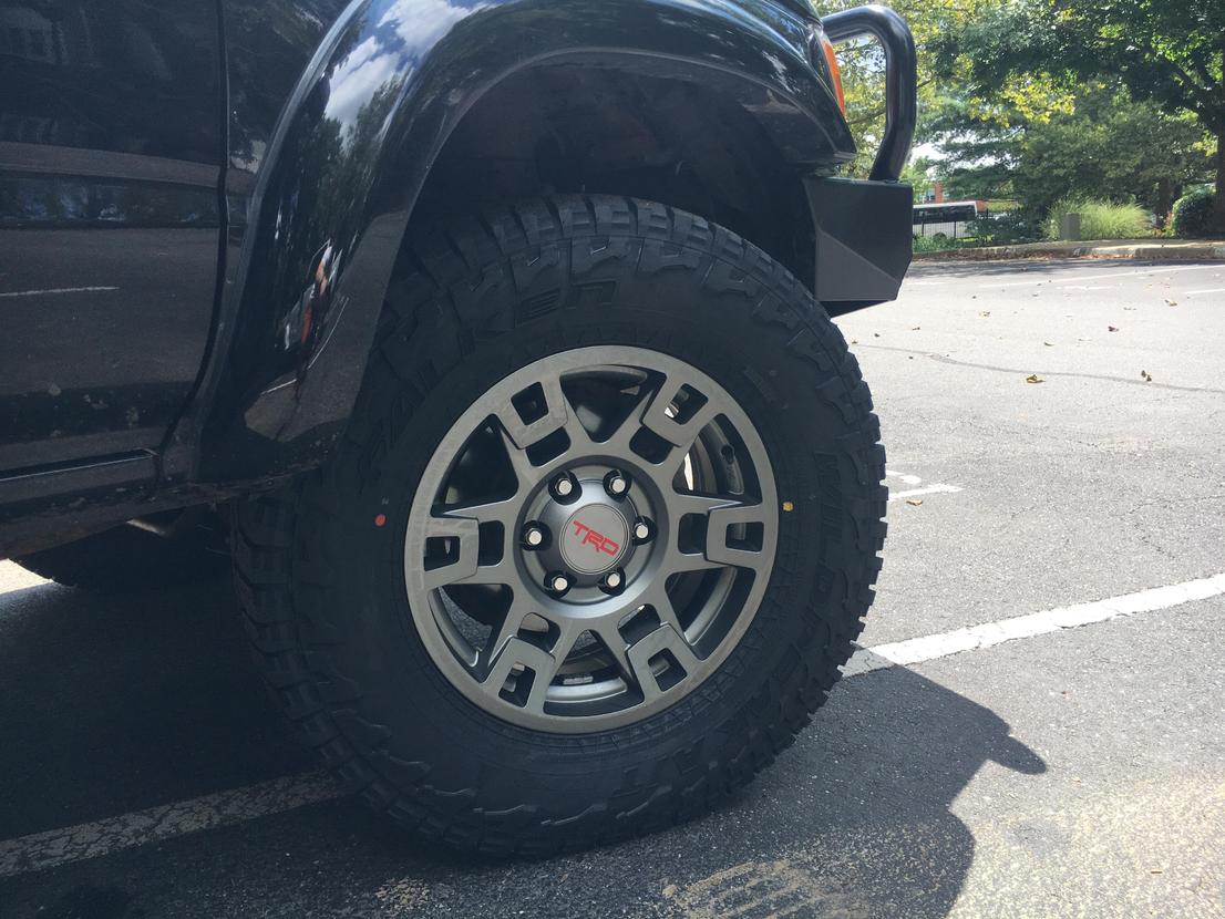

New shoes for Bae went on today. TRD Pro graphite w/ Falken AT3W 265/70/17. Very happy. Looks like a new truck. Now to get her dirty or have a detail day??

Awesome choice on getting the TRD Pro's. They look awesome in Graphite! Got a matte black set on my 00 Sport and love them.
