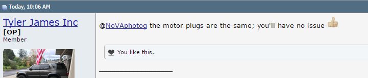

Picked up a fresh sunroof assembly from a parts truck. Looking forward to having it back. The 96-97 sunroofs will work with the 99-02 right? The controls were different but same function and form.
I hope so. I think you may need to repin a connector.
I need to do this too. Mine wit on me. I'm interested in your perspective after the job.
Ugh I mean, I haven't seen anything on the subject and it doesn't look like it. I was just thinking on the way home my button is different.
I put the sunglass roof consol from a 99 in my 97 but kept the 97 controls. I think Tyler James swapped the whole control unit from a newer 4runner into his 97. Let me see if I can find it.

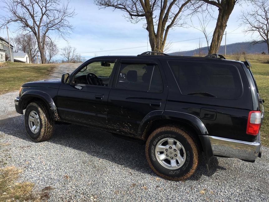

Couldn't resist a quick pic after we finally got some sun out...she's come a long way...

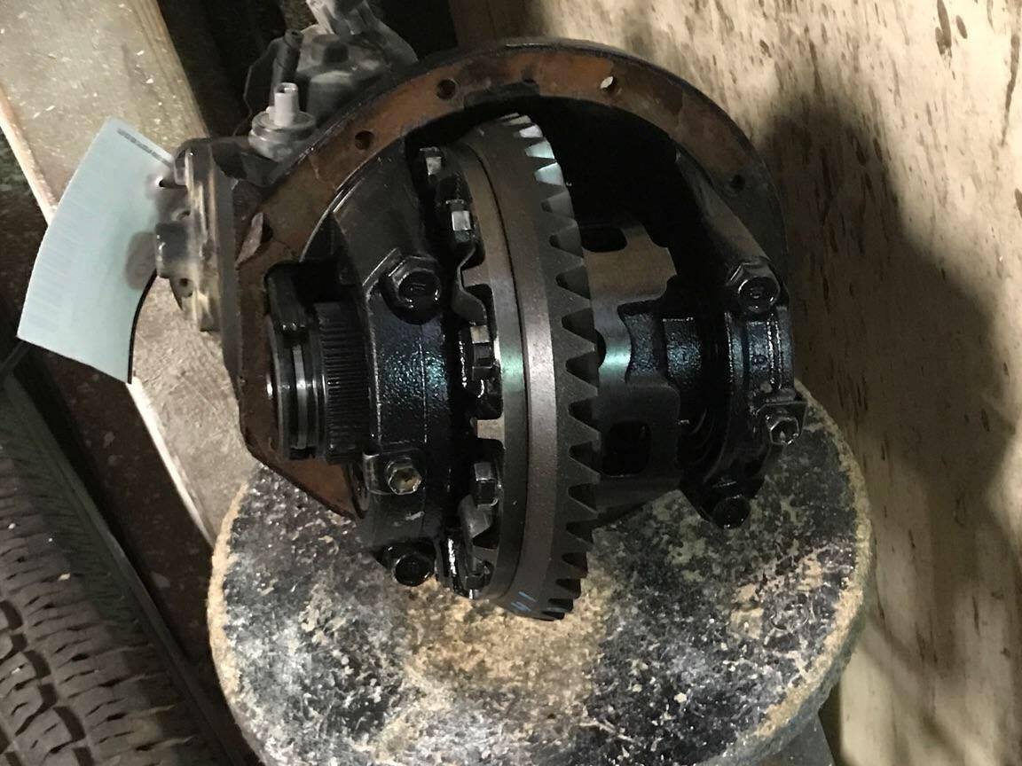

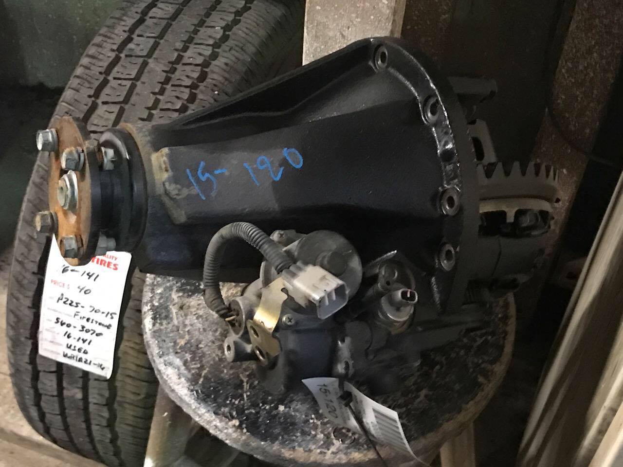

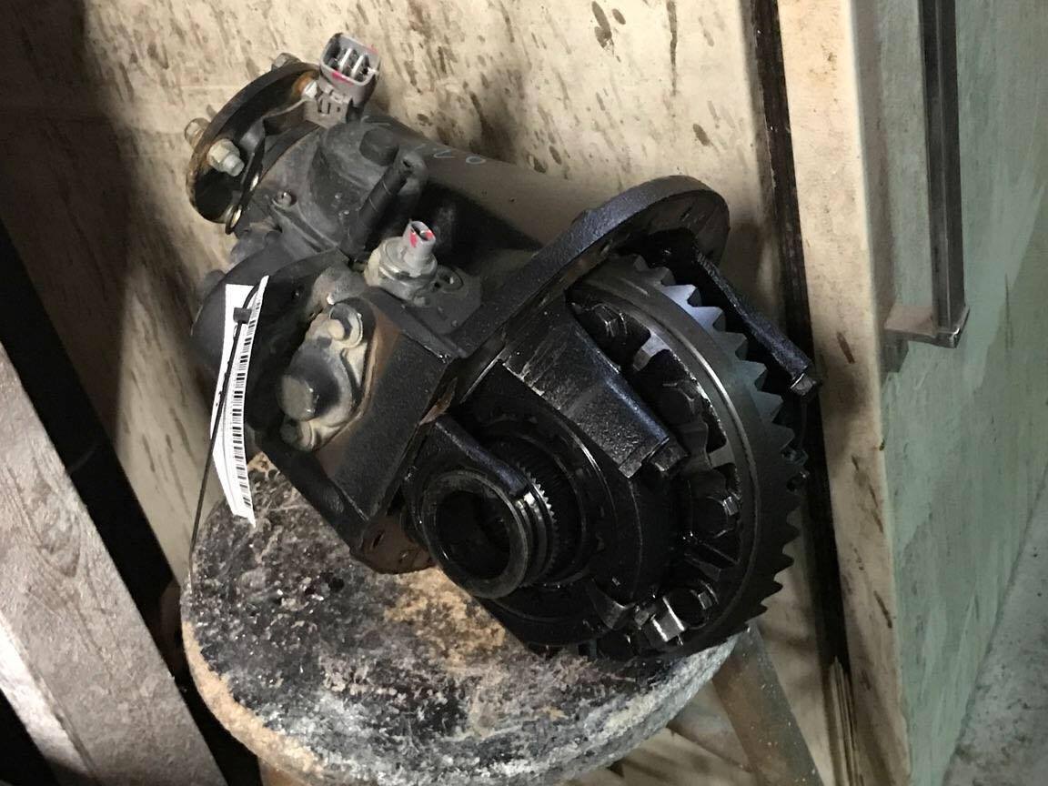

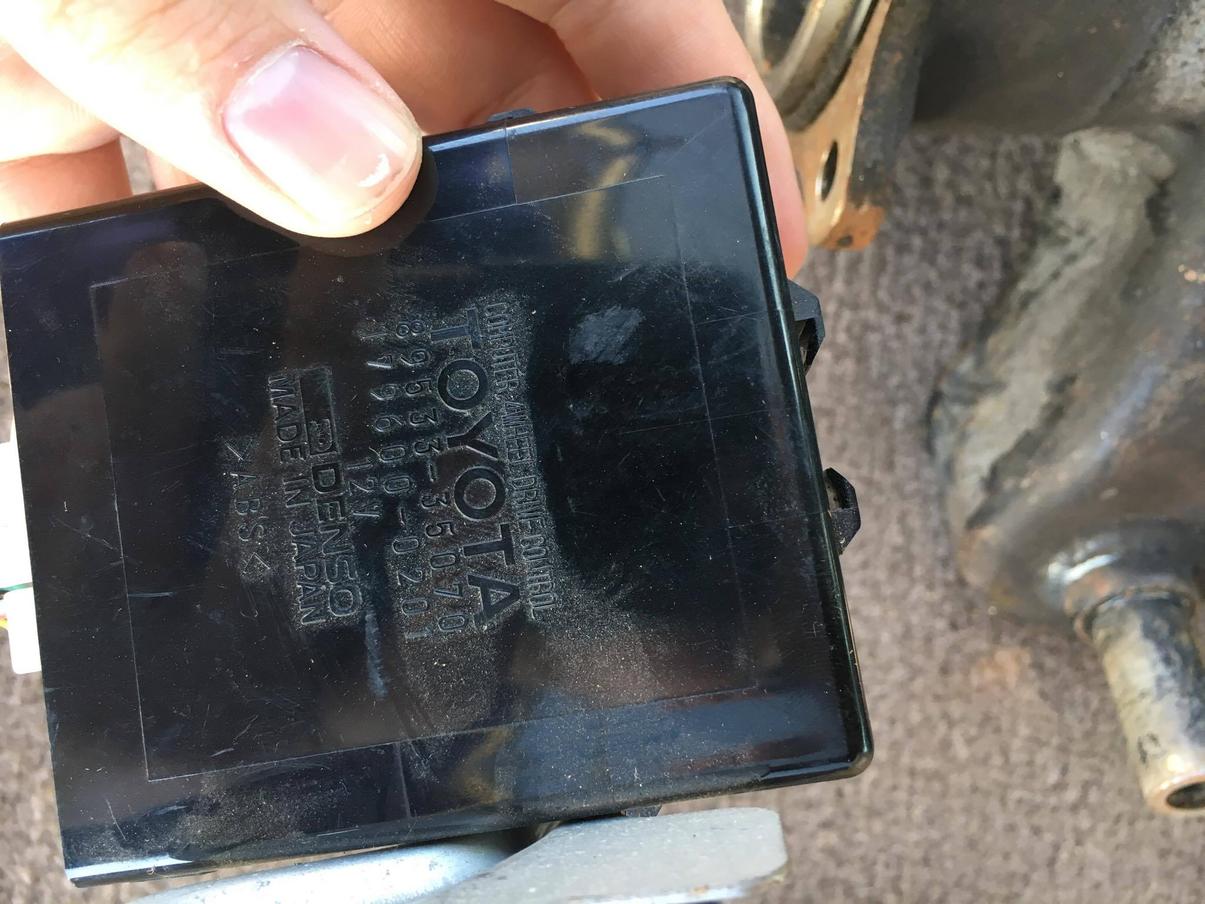

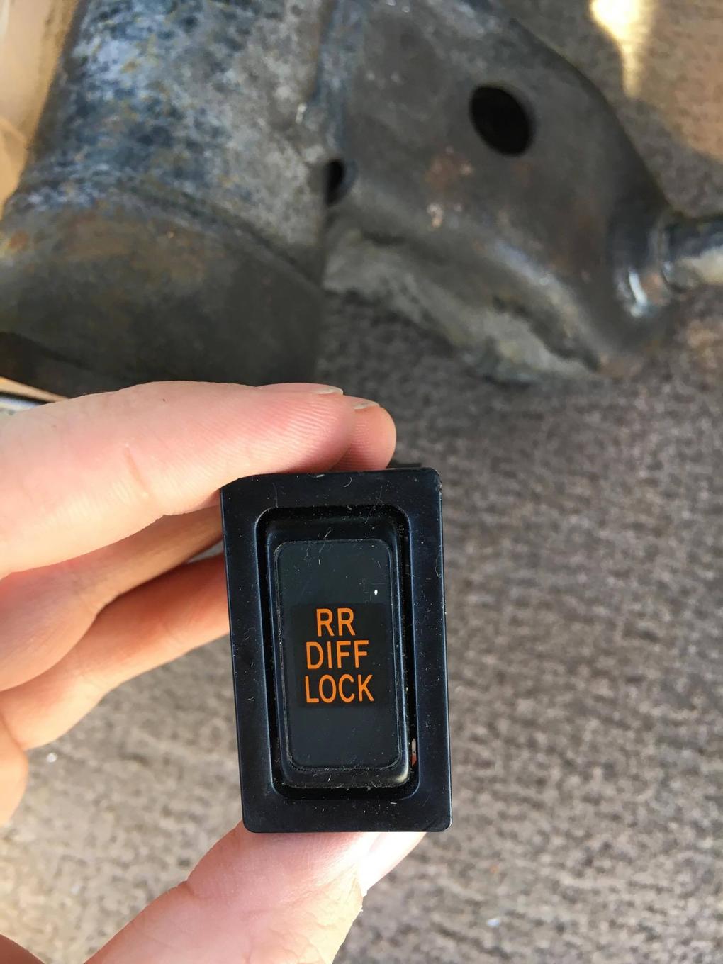

Locker ordered. TELL. YEW. WHUT.
4.10 out of '04 Taco Prerunner - 107k/101 day warranty.

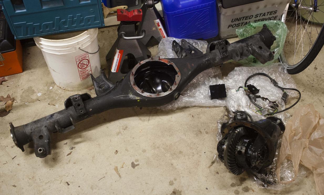

Locker swap components finally all under one roof...now to put together final items. Wiring, axle seals, diff/e-locker breather tubing...? Anything else "while in there?"
