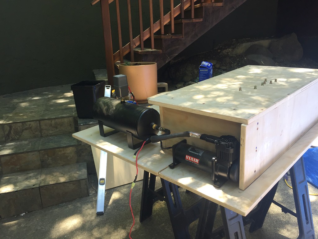

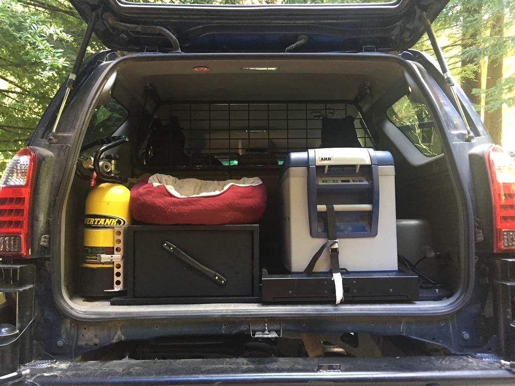

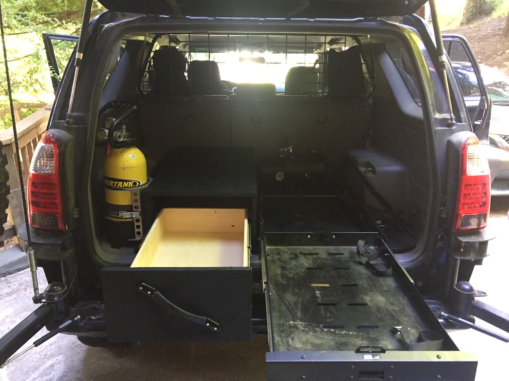

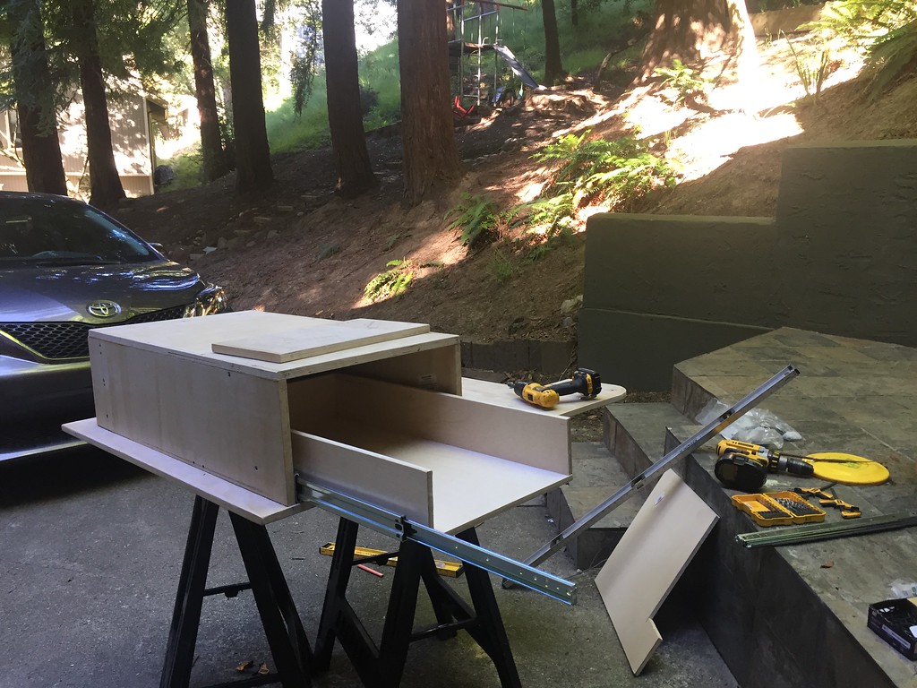

Version 2.0 of the DIY rear storage solution
On the original version, I used MDF. Over a few years though, the MDF seemed to become brittle and was beginning to warp. I also wanted to have a true drawer instead of sliding in/out a frontrunner wolf pack. This time I decided to use smooth plywood as the build material and sourced some HD drawer slides (unfortunately non-locking type).
I currently use CO2, but wanted to add an OBA system. I used some of the void space to mount the system.

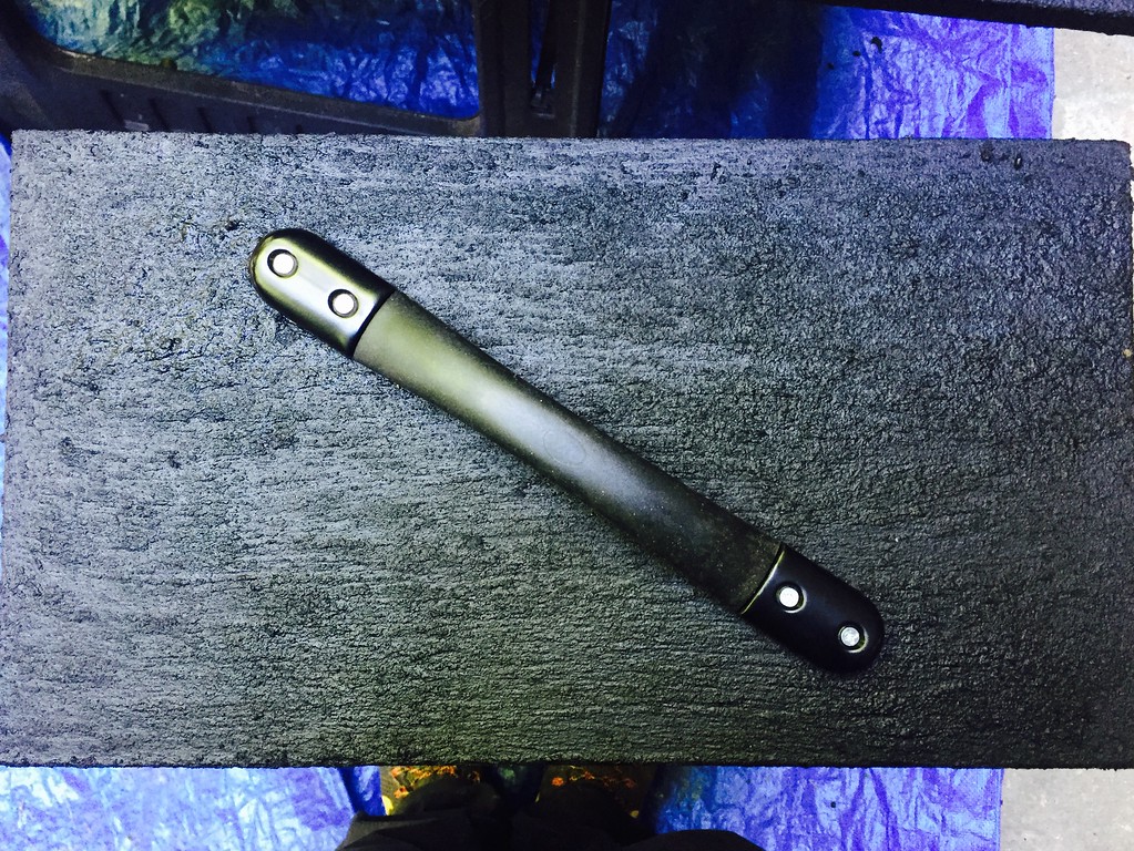

Finished product. I used truck bedliner as the finish

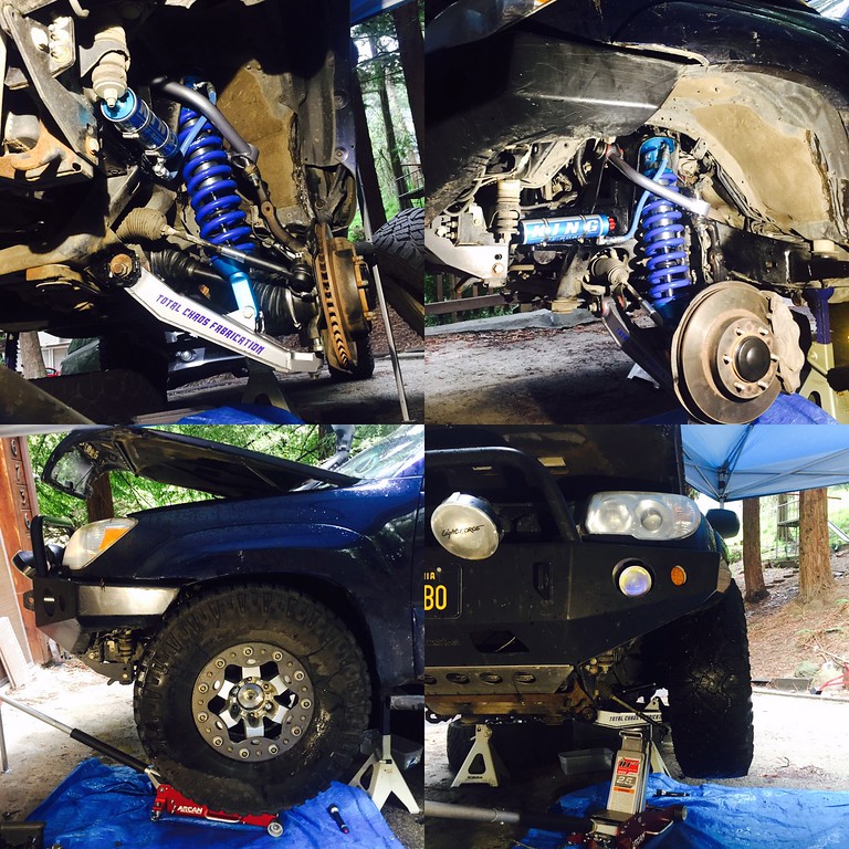

Total Chaos Mid Travel

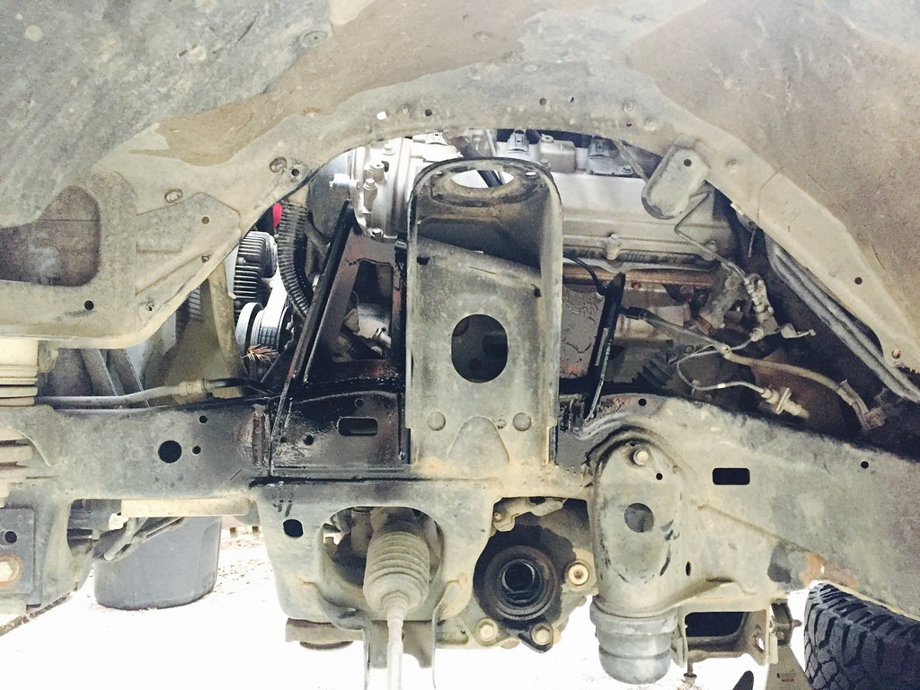

My front end needed some rebuilding, so what better excuse to dump thousands of dollars into your rig? I debated SAS, mid travel, and full LT, and in the end decided to take the middle ground and go with TC's 2" mid travel kit. It was hard to justify the coin doing a SAS and I didn't think I'd ever really use the rig in a way that would utilize full LT...not a big fan of the fast stuff.
While I had the front end stripped down, I gusseted up the shock towers, burned in HD cam tabs, and FINALLY closed up the body mounts
(same pic from previous pos)
Full stuff with 35" does rub on the bumper and fender flare slightly.
