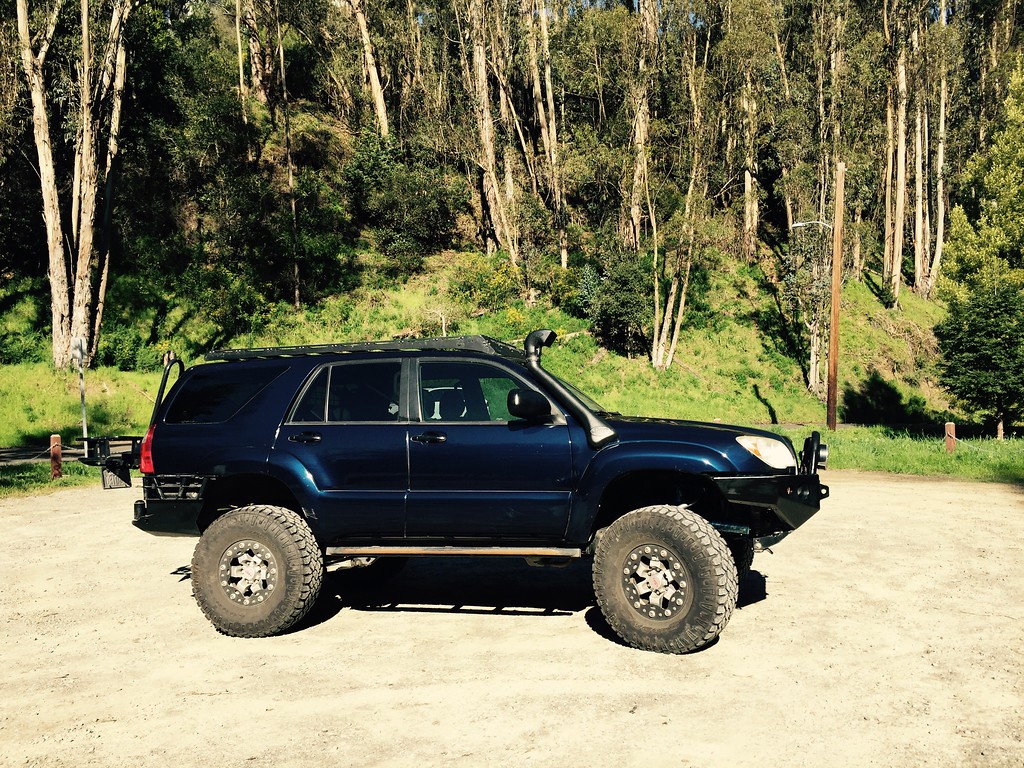

so, seriously :) what are your feelings on the Prinsu? Im getting ready to drop the coin for a rack and this is at the top of my list.
Road/wind noise? vibrations?
Does it "look" like it was fit to the roofline?
Hows it look with a load up there? Handle weight without sagging. Will the weight be ok when your bouncing down a rough road for 45miles? AKA any Death Valley /Mojave excursion
Have any nice detail pics of the roofline and rack?
Prior to the Prinsu I ran a Gobi Stealth rack.
Here is a comparison on which wins:
Noise: Prinsu
Neither has any vibration issues. The Prinsu has noticeably less wind noise
Strength: Gobi
I stand on my roof to load and strap stuff down. The gobi has a mesh floor that makes it easier to walk around. The mesh would flex a little, but the cross bars did not have any noticeable flex...I'm about 150lbs
The prinsu rack does flex when I'm on the roof. I also need to balance on the crossbars since it doesn't have a mesh floor.
Rough roads are not an issue for either rack as long as you've strapped things down correctly.
Weight: Prinsu
Aluminum vs steel...
Flexibility: Prinsu
My opinion...the prinsu rack is made primarily of t-slot crossbars. There are several attachments that you can get...eyelets, screw studs, LED brackets, etc...and you don't need to get these from Prinsu. The cross bars are adjustable front to back.
The gobi on the other hand, isn't a flat rack, so it has raised bars that allow strapping down storage boxes much easier.
Overall I'm really happy with the prinsu. I needed the functionality of a flat rack, and didn't need the robustness of the gobi.

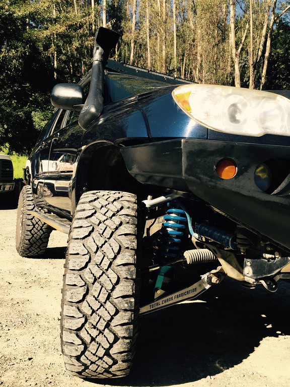

I've always loved this build. Props [MENTION=51568]daPitbull[/MENTION] it's very well thought out. Everything on this rig is spec'd for a purpose and you can see that it's quite effective in how you use it on your trips. I've been creeping this build since my 3rd gen days and still keep coming back to check out your awesome photos and any progress on the truck.
If you don't mind, I have a couple questions for you...
- You seem to use your truck for long distance hauls as well as on the trail. Do you ever wish you went for a 34" tire? (rotational mass weight savings + less rolling resistance than the true 35's)
- OEM 4.56 gears, I'm scratching my head on this... did you re-gear your diffs this way or did you score some unicorn OEM diffs from a wrecker or something?
- Would 35's be possible with no bodylift or only the 1" bodylift? I know this is a loaded question as I know all too well how to trim to fit 35's with only an inch of lift... but can it be done "cleanly" without cutting into the actual body of the truck?
I am planning my new-to-me 4th Gen build after just selling my 04' Tundra that was tubbed on 35's. I loved the truck and the 35's with the 4.56 gears were great but I am wondering if I should do a 34 this time around and alleviate some of the trimming and also gain a little bit more road manors with the decrease in rotational mass with the smaller (and lighter) tire. If I do run 35's I'd like to do it only if I can make them fit without drastic body modifications. I do not want to cut into the body. Cutting the fender is ok but not the main structure of the truck. Also debating long travel for mine, but I keep wondering when I would ever need it and you seem to use your truck very similar to how I use my own.
Sorry for the novel just stoked to pick your brain as you've had this rig for a few years now and logged some serious seat time with the tires and suspension setup that I may emulate.
Thanks for your time,
Addison
Hey Addison...see below
To be honest, for every day use and trail days, I really can't tell since I've got the V8 and 456 gears. I'll take every practical inch of ground clearance i can squeeze out. I don't think the weight benefits from a 34" to 35" is of any value for me. There has only been a few times where I wish I had more oompf, when driving through Colorado peaks, but other then that it's been ok.
A local toyota specialty shop was able to source OEM gears that were 456
I ran a 1" with 35". No matter how much I pounded and cut, I still couldn't get rid of the rubbing. I still rub on the frame on occasion. I've been putting off welding on steering stops.
