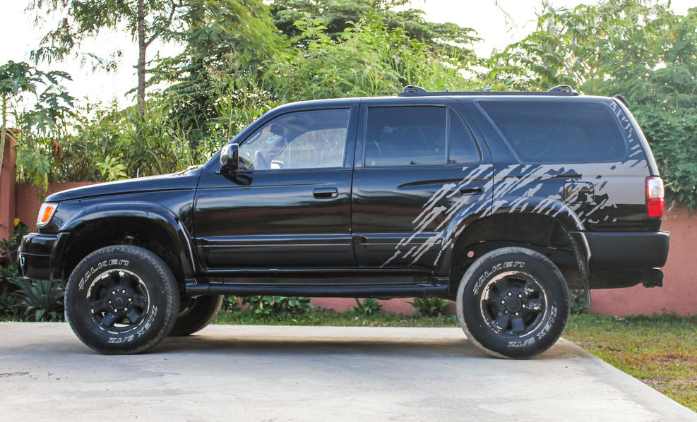

Hi, here's a first photos of my build.
Here is the spec:
Exterior:
- Front: 1.5" lift, stock stride
- Rear: LC coil (8,5 wrap), Stock Land Cruiser Supension
- Ford Raptor Digital Mud Sticker
- Sticker black laminate on the front and back of the bumper
Interior:
- CD Player
- Bleu gauge lights
NEXT BUILD:
- Plate Bumper
- Larger Rims and Mud Tires.
What do you guys thinks?
Thanks

Wow, I think that Raptor decal looks really cool... Original for sure.
Once you get some beefier tires that thing will look good!

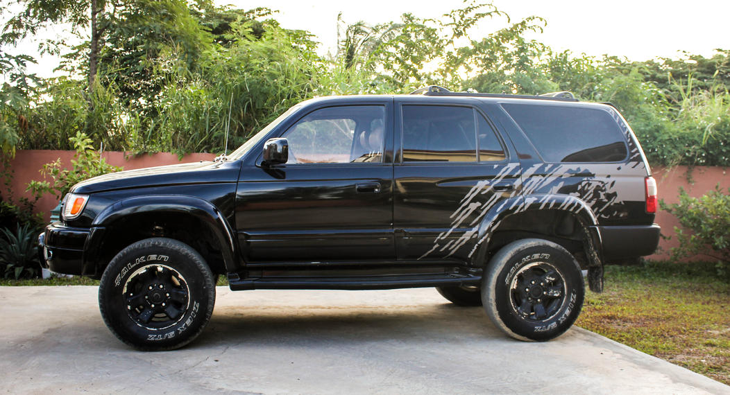

Ditching the running boards will give you instant 2" lift !

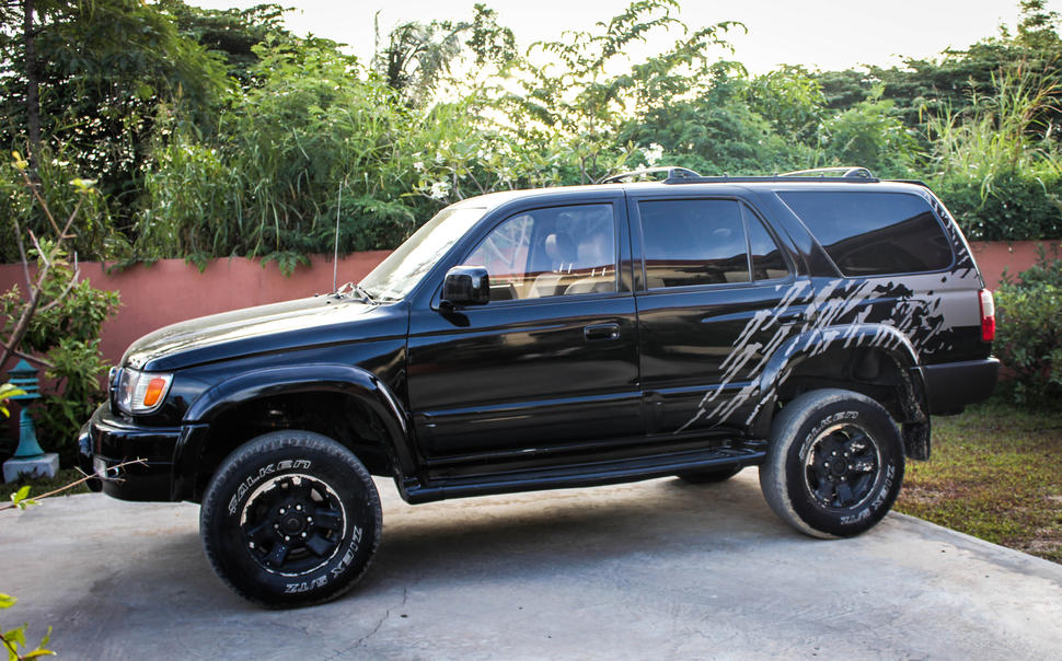

LC Coil and Shock for the Rear
4runner Stock shock side by side with a LC Shock:
Oh yeah is higher:
That is super hight:
Get her align:
Final Result with Running Board off

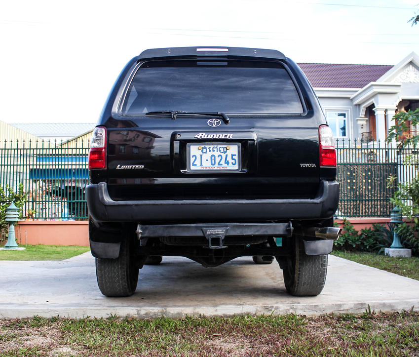

looks good. maybe put some holes in the front of it to let air in to help keep the motor cool. big plate bumpers like that tend to block a lot of air flow over the radiator. -the grille only covers about 1/3 of the radiators surface area

x2 and you might as well put a winch plate in there if you ever want a winch in the future.

A little advice: Don't mockup your bumper over the existing bumper. It is going to be too large and stick out too far. The fatlip bumper already sticks out too far. Remove the bumper and then do your mockup. Keep everything nice and tight.
Looking good though!
