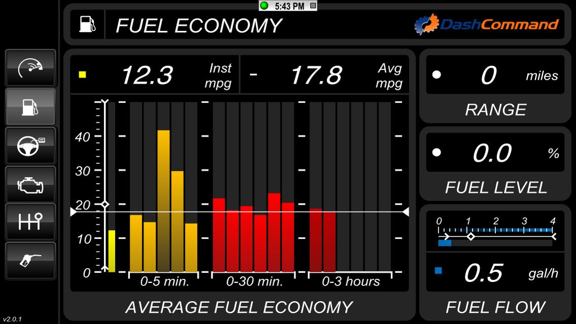

I don't think there's a way for the ECM to directly measure fuel flow. There may be a way to indirectly calculate it since the ECM knows how much air is coming in (MAF), and the AFR (wideband O2 sensor on Cali emissions models).
I wish there was a way to measure the injector pulse widths on these Toyotas, but I'm not aware of how to do that.
Thanks [MENTION=70922]Robb235[/MENTION]. In that case, how are other 3rd gen guys getting fuel consumption data? I see photos on this thread from the OP [MENTION=105650]Firstborn10[/MENTION] and [MENTION=69310]zacattack20[/MENTION] showing fuel consumption, horsepower and torque but I'm not getting any of this? Could I be missing something under Dash Command settings/setup? Would be great if someone could list which Dash Command gauges will or will not be functioning for 3rd gen 5VZ-FE.

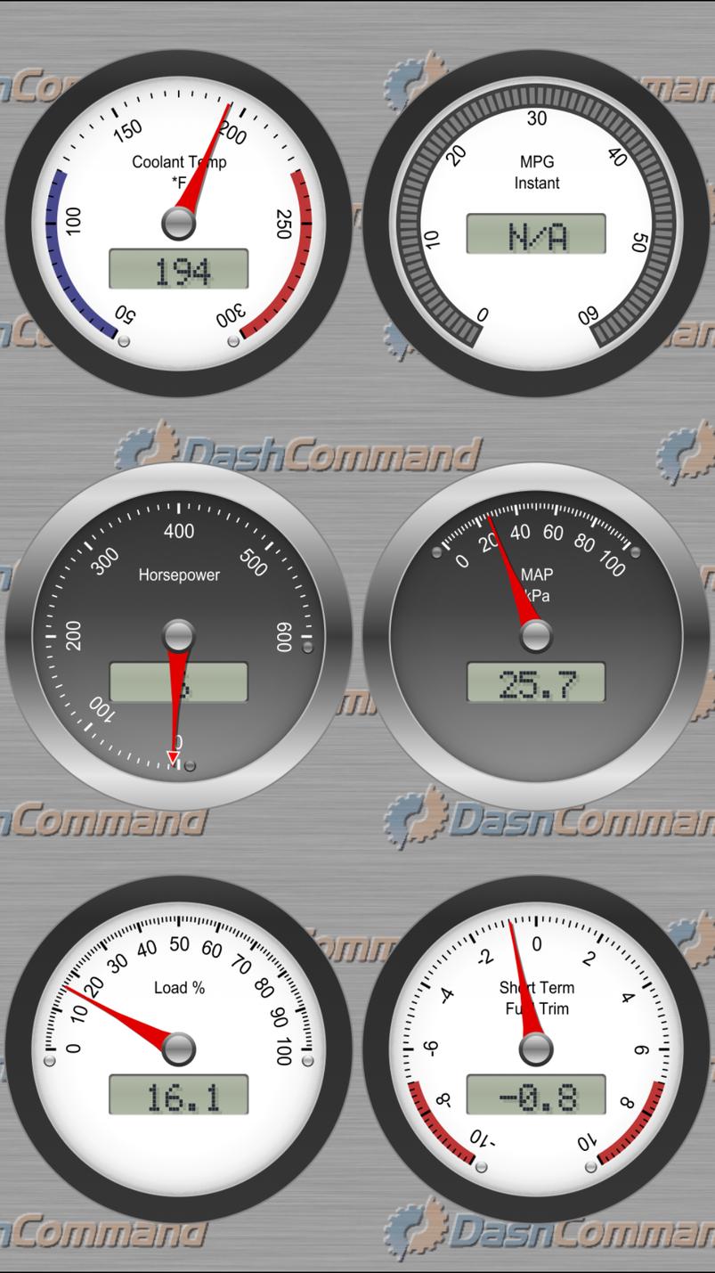

Where do you see fuel consumption data? I'm not seeing that on those pictures.
The next page give you fuel economy statistics, such as instant MPG, average MPG, fuel flow, fuel lever, and range until empty.

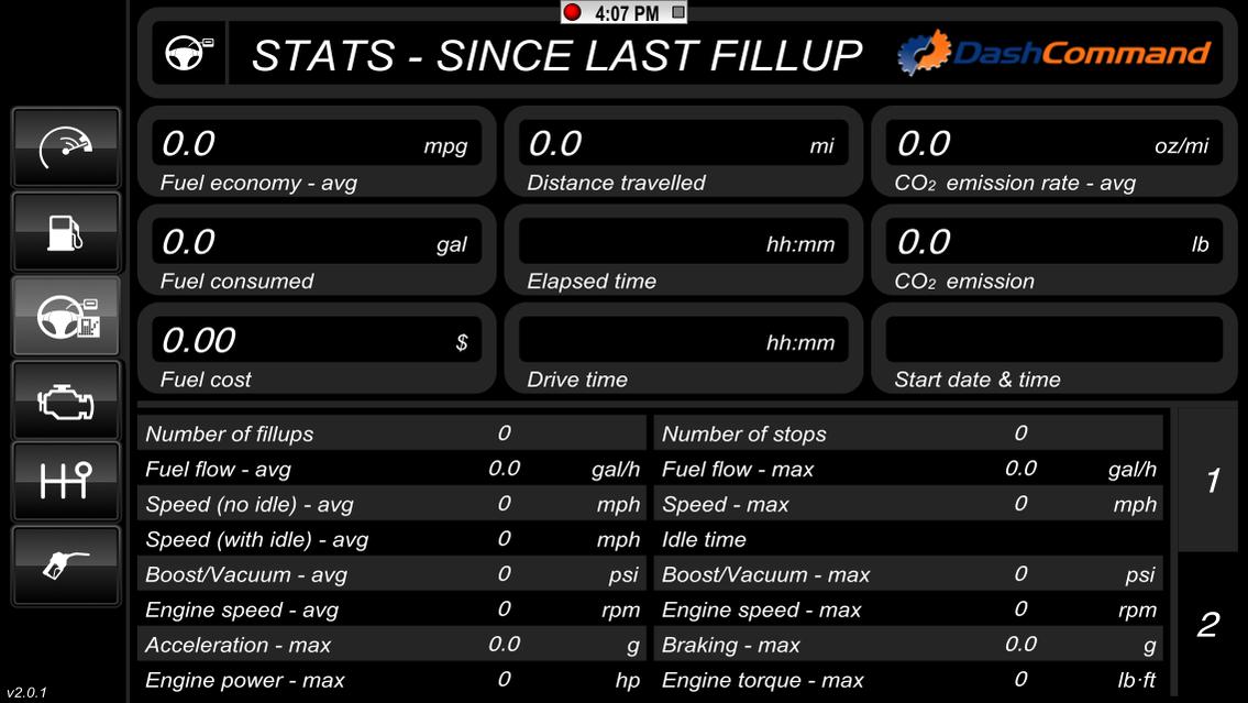

The next is a general stats page, which includes waaaay too many for me to list. I will let the picture do the talking.

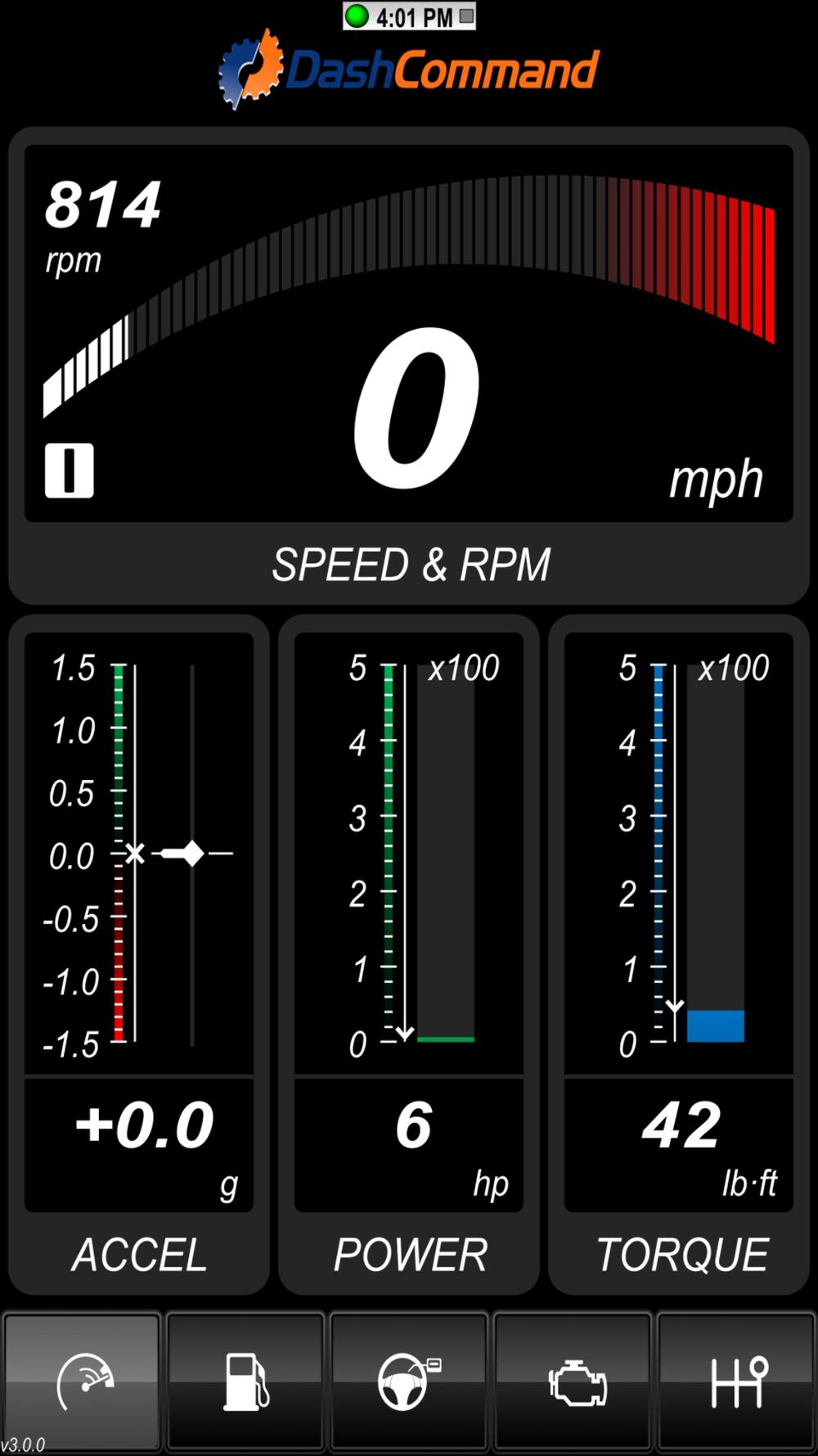

[MENTION=70922]Robb235[/MENTION] OP shows fuel economy, horsepower and torque. Also can be seen in his video here: https://www.youtube.com/watch?v=buFeHUPw_8U&feature=youtu.be
I'm thinking it must be something in the settings. Will be looking into PID's...

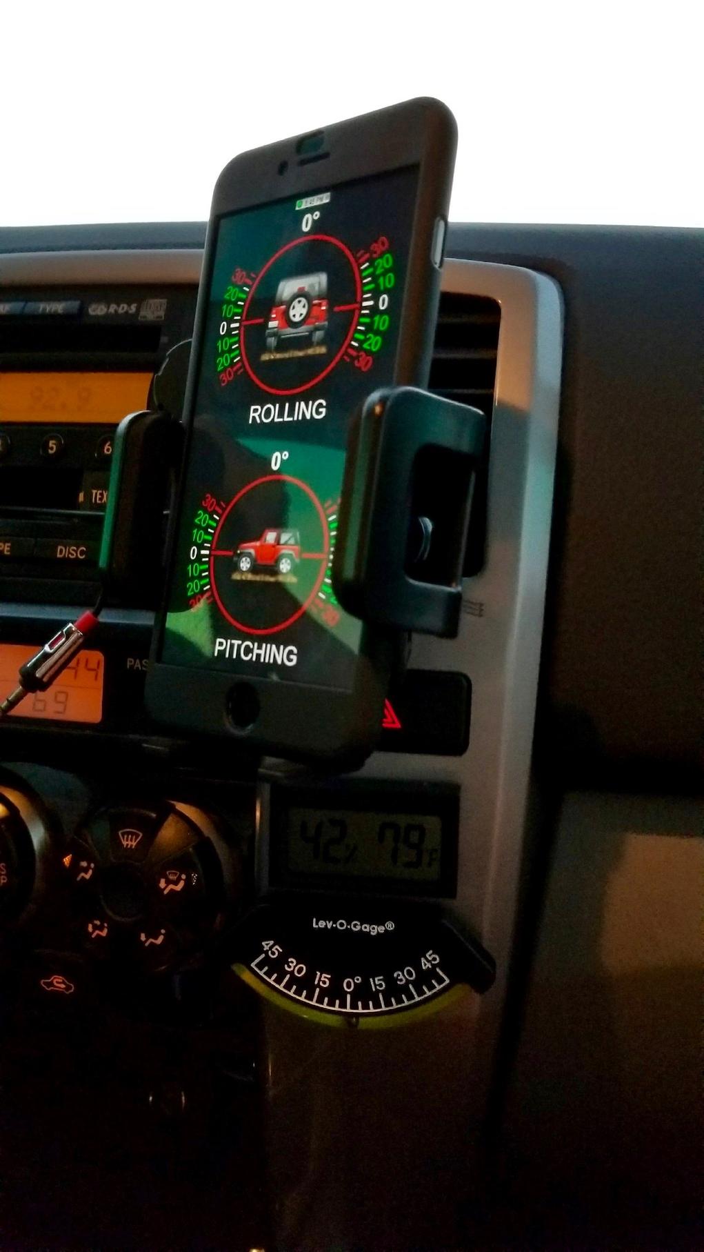

My new favorite toy :)
