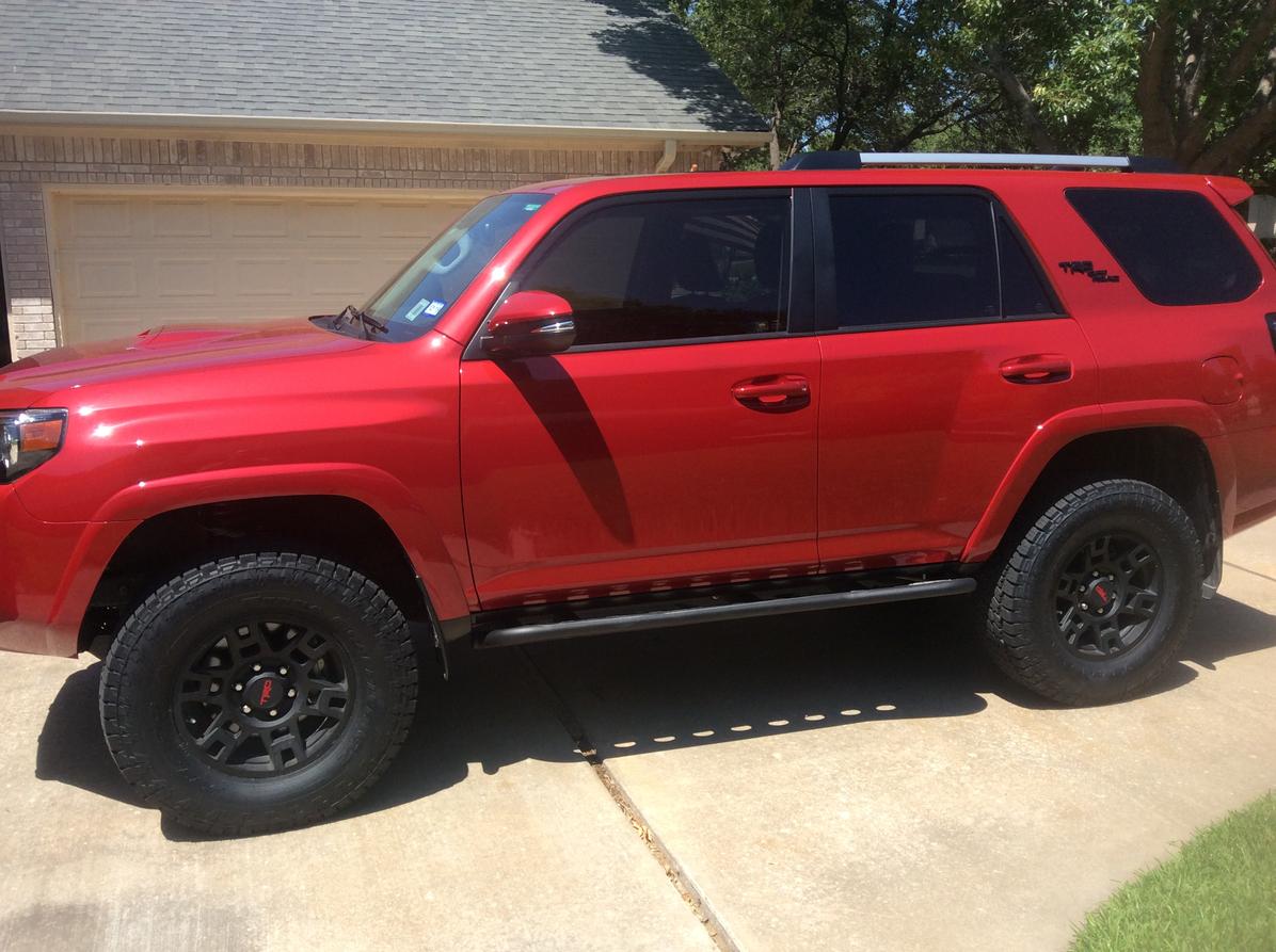

Bilstein 5100 front.
Set all the way up.
Bilstein 5100 rears with daystar 1.5 inch.
Needed alignment when done.
No problems but I only have 3000 miles on it.

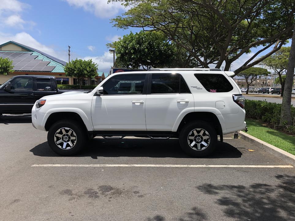

I've had my daystar 2.5" kit installed for only a few weeks now but was able to get it aligned by Toyota right after install and they said they got everything perfect in spec.
No issues in the past 1K miles and i've hit a few moderate level trails no problem.
