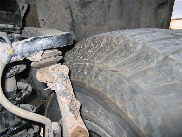

The worst thing (for now) is that the front passenger tire (265/70r17 nokian vatiivas) is rubbing and gouging itself on a small protrusion on one of the steel arms. The driver side is fine, so I will take it back to the shop and ask them if this is their issue, or something that an alignment will fix.

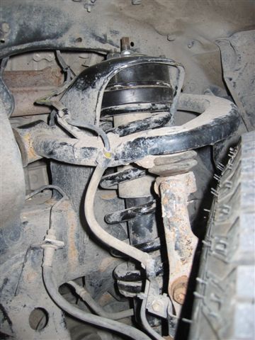

the rub, and the bulb on the arm that might have done it?
I have a handful more pics of just that suspention area, with view from the rear and then front (wheel cranked fully in both directions). Let me know if anything else is useful.
I realize now that the whole unit must move together, so I doubt that "nub" was able to rub so much higher on the tire. I hope the alignment has solved it.
