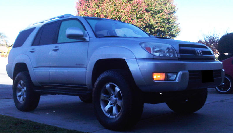

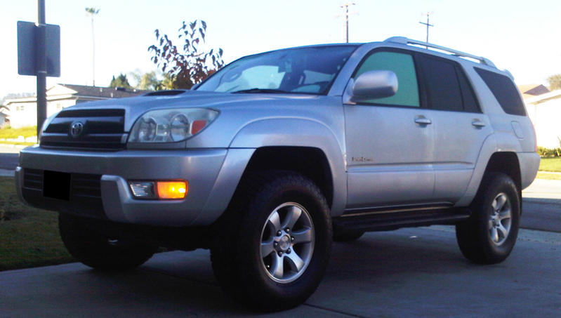

So I just did the Daystar lift with a Toytec bodylift. Trimmed the bumper and fender... Got some 285/70/17 NTG's on my stock 17" wheels with spidertrax spacers on... Drove home and it was good... no rubbing.... a few days later, I went to get an alignment... End result was 0 camber, 3° caster, .4° toe on both sides...
Now I am rubbing like hell... I came back home, shaved even more of the fender... My driver side is literally touching the bodymount when I turn the steering wheel all the way left... The right side touches the bodymount as well when I am making a turn into the driveway.

My brother has a 3/2 with a 1.5" body lift and rubs with 285's on it just barely... live with it. It's not hurting the tires... not even a sharp piece of metal. Without a plasma torch there's not much you're going to do with it.
you could consider chopping the body mount a little if the rubbing is too annoying for ya. Most people have done that here. Pictures??
yeah I will look into chopping it a little bit. I have pics with my BB but it's horrible...
Here is the horrid pic.
