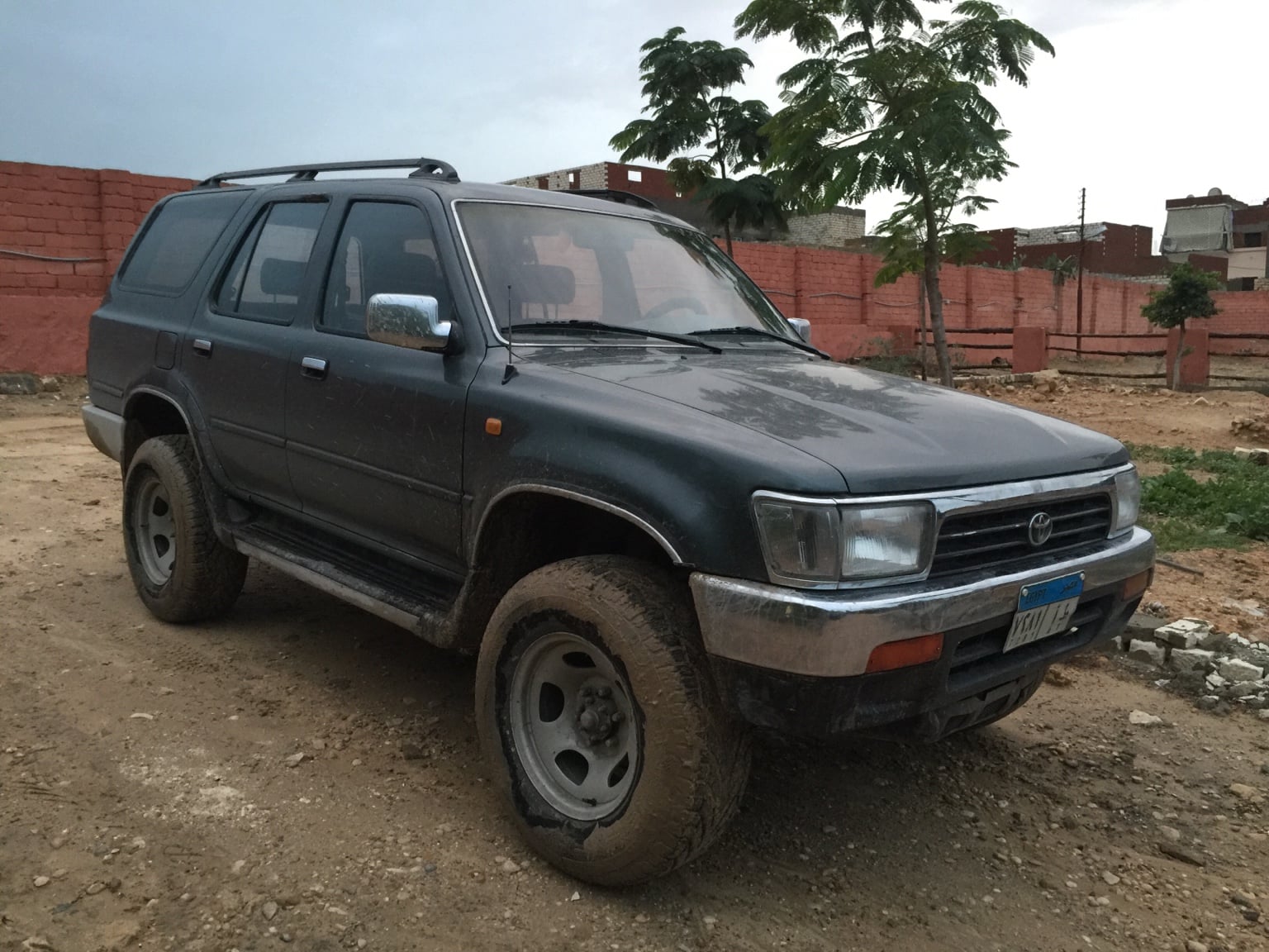

Nice truck you got out there , just bought mine a week ago , it has 220xxx km with a 3.0L 1KZ-TE turbo diesel which is great power in desert areas like we have here in Egypt , I love this truck and will start in some body work to kill the rusty spots on it as it was never been painted and still got the stock paint since 1993 [emoji33] , wish me luck [emoji3]
