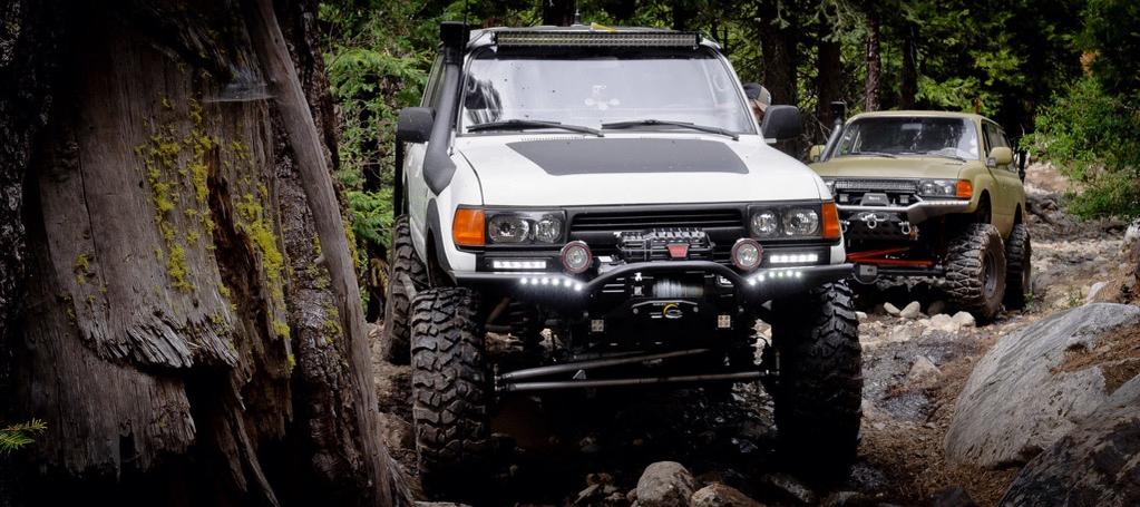

A flickering on any kind, across a broad range of brightness levels and broad range of frequencies can be very noticeable and distracting. What some might call barely noticable will equally drive someone else nuts. I don't think wanting non flickering DRLs is in the least but anal...
Totally agree and to each their own....
Just saying what is the purpose of a DRL....
Ever see a motor cycle with his headlight that pulses....? Wonder why it does that?
Or people who install a strobe kit on the brake light....
This by comparison is "barely noticeable".
And I'd hate someone to read through this thread and be discouraged by
whats described as a "strobe".
As it's been discussed you can eliminate the DRL completely with an easy mod. To me and the amount of driving I do, (just rolled 70K in my 2014) I like the added "attention" of the DRL and haven' t had any issues.
But again to each their own and I hope this "decoder" works for those who desire it.
FYI: I have a set of Hella DRL's on my Landcruiser that are 3 wire. This allows you to run full and dimmed power. So a "two function" LED is possible. The Hella's are the square ones just under the headlights. The 4Runner lights don't run this same way and cut voltage to the "bulb" to reduce intensity. If they were a three wire set up we would never even be discussing this sinearo.

Wow, great picture and trucks. I'm very likely to go with these high beams myself and keep DRL. Thanks for all of the additional information. Very helpful to those of us on the fence.

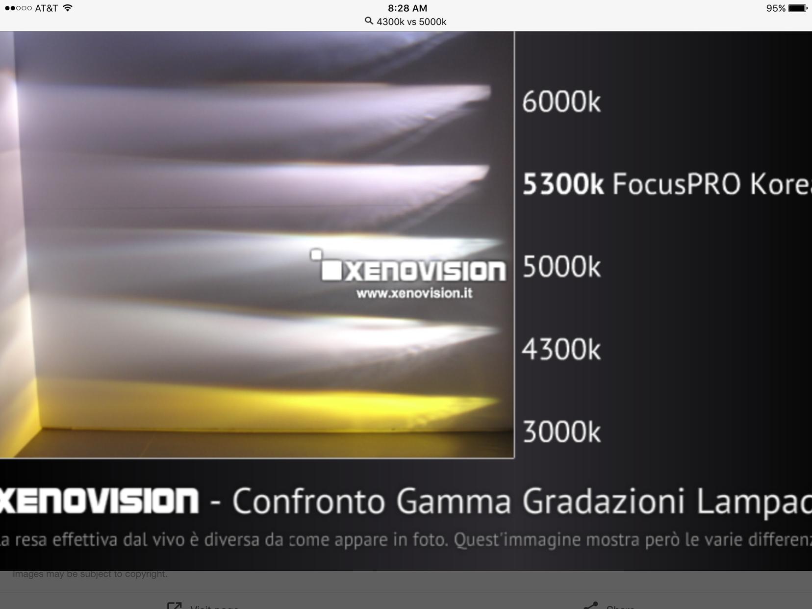

Ok, I've read your post now a few times just to make sure I understand what your saying...
I think it's important to point out your comparing apples to oranges here. The low beam is a projector beam, the high beam is not... didn't notice your sig to see what year you have?
They process light completely different, for completely different purposes. This is by design and has nothing to do with the "bulb" type.
The low is Projector is a focused driving beam.
The high is a wide distance beam, it's a bit of a catch all. Gives distance but also scatters light to fill in the voids the low beam doesn't get.
Since you live in a place where you can get into total darkness, drive around with the highs and then report back if they are not a vast improvement over the stock halogens high beam.
Also 4300K is pretty close to the yellow side of HID. The Sabers are 6000K of course there is a color difference :-p

Interesting chart to see impact of the different colors - I assume same wattage bulb in each. The 6000k is clearly less intense than 4300k. I think if 5000K LEDs were avail that may have been a better match for me.
Agreed and to make it even more complicated, that's one manufacturer chart. That was the first one that's popped up in Google...
So there can be color variations between manufacturers, wattage ect. Lots of variables come into play, even type of housing.
-A
P.S. I'm somewhat shocked that you don't seem blown away by the high beam in total darkness vs the stock halogen. As stated before these LEDs in the high setting toss as much if not more than. 40" + LED bar. IMOP that's pretty darn impressive. But again it maybe my extensive experience with LED bars.
