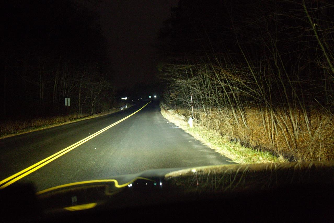

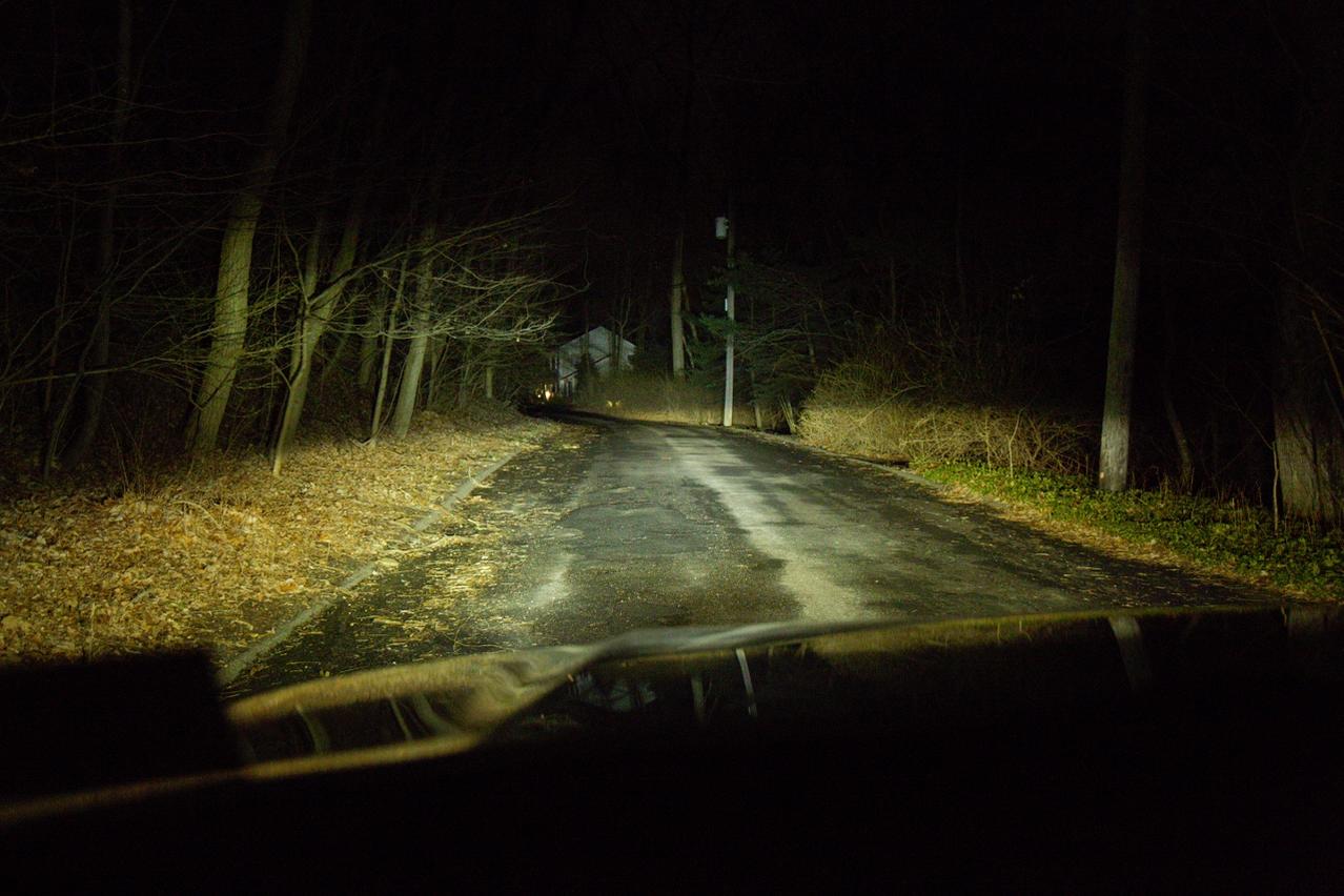

P.S. I'm somewhat shocked that you don't seem blown away by the high beam in total darkness vs the stock halogen. As stated before these LEDs in the high setting toss as much if not more than. 40" + LED bar. IMOP that's pretty darn impressive. But again it maybe my extensive experience with LED bars.
Here are a series of pics with just low beam HID and low beam HID + high beam LED. Exposure was kept the same within each set and all pics were shot using daylight white balance on a Canon 5D Mark III at 12800 ISO. You can clearly see where the cut off of the HID is. I was expecting the intensity of the high to be roughly similar to the HID but the pics show there is a big difference between the two. I am not sure if that is due to the temp difference between the two lights or one is using a projector and the other a reflector. As a point of reference, in the last set the tree in the middle of the pic is about 150 ft away. Do you think the pics are a representation of what I should expect or do you think I have some bad bulbs? I should also point out in all of the pics with the high on, I can perceive more faint lighting but does not show on the pics due to limitation in dynamic range of the camera.
I answered your question in my first initial response and then you answered your own question above:
"They process light completely different, for completely different purposes. This is by design and has nothing to do with the "bulb" type.
The low is Projector is a focused driving beam.
The high is a wide distance beam, it's a bit of a catch all. Gives distance but also scatters light to fill in the voids the low beam doesn't get."
Just stand in front of your truck and look at the headlights. Pretty easy to see the path the light will travel out of the DRL / High.
Same could be said for the projector, it's like a garden hose with a spray head, when you twist the end down it's focused like the projector, when you back it off it throws the water wide and softer...
You can clearly see in your high beam pictures the cut line of the projector and the high beam filling in the voids. It's doing exactly what it was designed to do.
It's the design of the actual headlight and has nothing to do with the "bulb" type you place inside.
